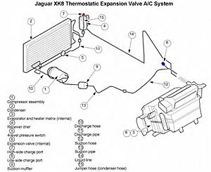

A trip to an Air con specialist is always first port of call with Air con issues, they may have heard this before. I wonder if it's a trapped seal somewhere in the system that vibrates when the pump activates, it sounds like pressure regulation in the system isnt correct.
I'd suggest turning it on and leaving it on full time, see if the noise subsides, if it doesn't then have an air con dude check it out.
XK8 diagram but the same system.
