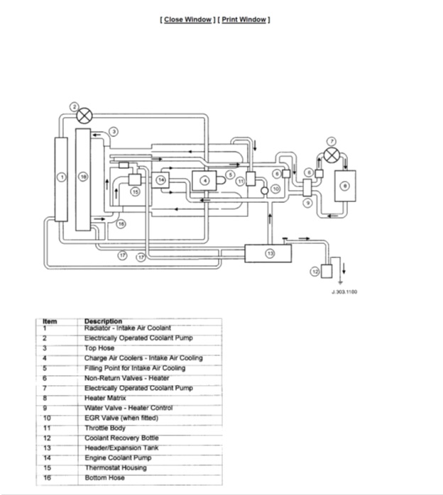

A hex bolt (3/8" diameter shaft) turned upside down will fit the hex bolt on the intercoolers. As long as your intercoolers are cool or cold then that cooling circuit is working fine. Otherwise they would be as hot as the rest of the engine

Cooling to the intercoolers is by radiator coolant. How can they be cooler than the radiator when the system is up to temp?
Old 02-02-2016, 10:21 AM
sparkenzap's Avatar
Join Date: Nov 2007
Location: atlanta ga
Posts: 4,502
Received 1,064 Likes on 867 Posts
Although the loops are connected and the fluid is the same, there are two separate cooling loops.

The intercooler circuit and radiator are independent of the engine coolant radiator. they are interconnected only for pressure relief. When the car is moving the intercooler coolant temp is a few degrees above ambient outside temp dependent on boost load and residual heat soak
