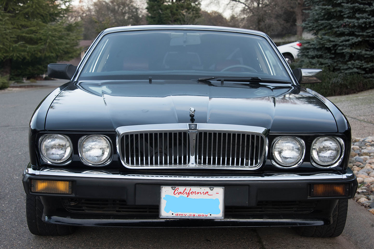

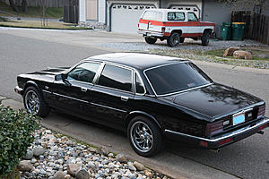

Problems with a 1988 XJ6, 115k miles.
She was running fine but one day, on a bumpy road, she cut out and now will not restart.
More info, car drove home after the bumpy road and started stuttering in the driveway. Parked and now will not start.
"Mechanic friend" looked at it and declared it was getting fuel and spark, but wasn't sure where the carb inlet was to spray ether - so thinking this might not be a mechanic familiar with Jaguars.
I am going to look at the car next weekend, with a view to purchasing/rescuing her.
I will take some tools and a copy of the fault finding chart. sounds like it is not the inertia switch as first hoped for :-)

You're making great progress! How about posting some photos for the rest of us to drool over?

You want photos before she is really ready? I took some on the day we got her, I will look them out tomorrow. Not going to be fresh ones until the weekend, as it is dark when I leave and dark when I get back from work.
