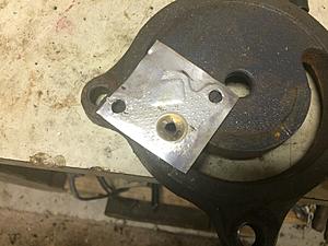

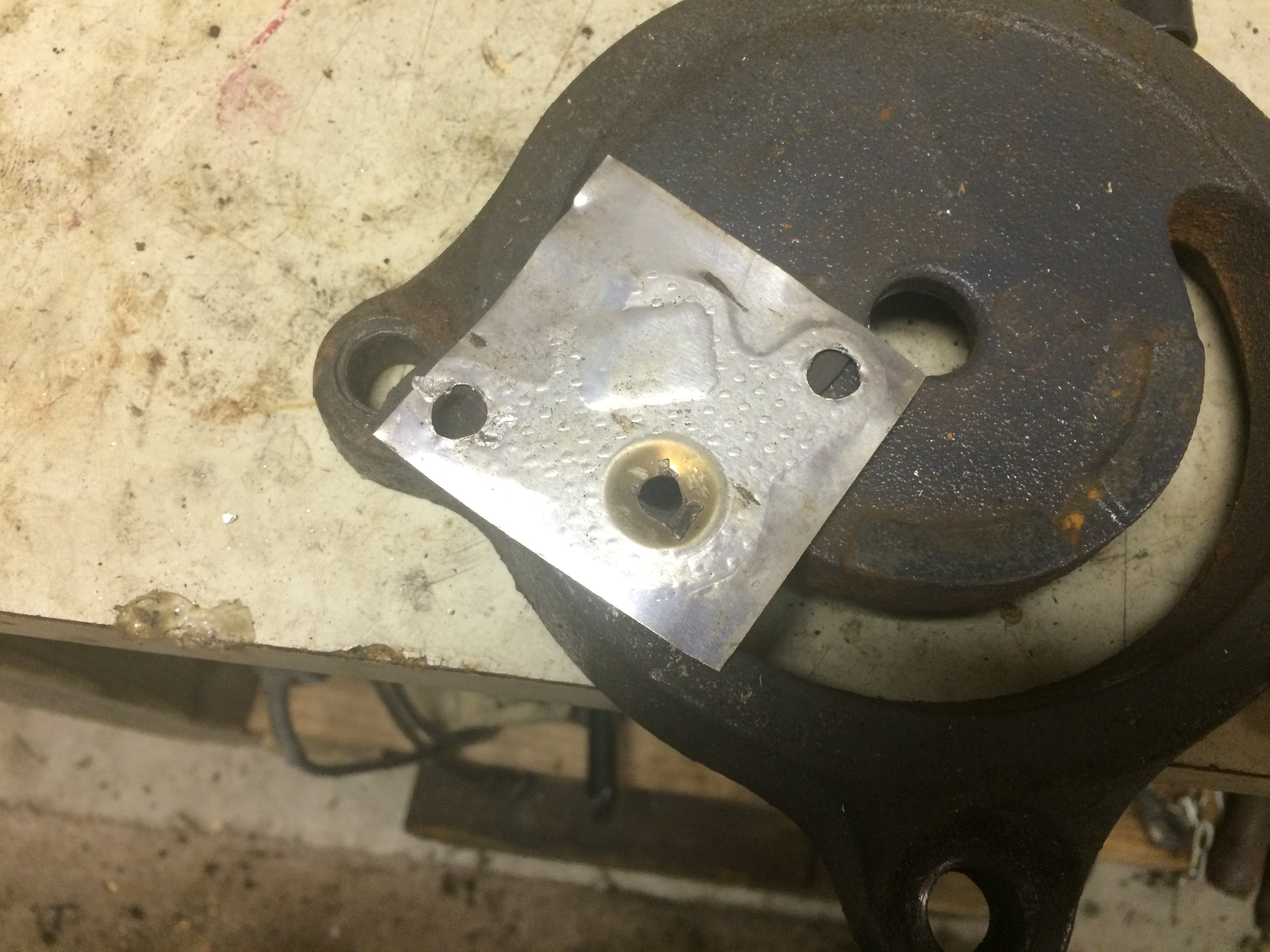

Stay Tuned! For this weeks episode of Roger and the Vacuum Leak!
I have made a "tin" restrictor plate and installed it between the exhaust manifold and the EGR valve base. It has a 1/4 inch hole in it. I would say the full diameter of the tube is about 1/2 inch. Otherwise the egr system is complete and functional as far as I know. I have cleaned and reinstalled the original fuel injectors. I started it, let it warm up fully and then drove it about 20 miles at varying speeds holding steady at 40, 45, and 55 for a mile or more each. I felt no surge or stumble, had good shifting up and down. When I pulled back in, I found that I had an idle of about 1100 rpm. I adjusted the IAC screw and got it down to 800. I waited a few minutes and tried a hot restart with good result. I then let the car rest for about an hour. I came back and started it again, It started very well and the gauge showed still warm. Drove it to the parts store for a Water Pump for The Buick (GRrrrrrr) and found that the idle had settled to 600. Then later put it back away. All with good results. The O2 sensor code cleared, but was replaced by ff14. I think I know what that will lead to. Beyond the code..... all seems swell today.....
