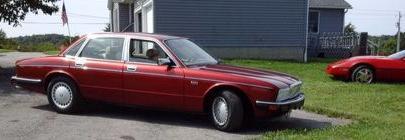

Default 92 xj6 sunvisors
hey everyone! don't know what they're called. But I need the small clips that the sunvisors snap into. both of mine are cracked and not letting the visor clip in. thanks
