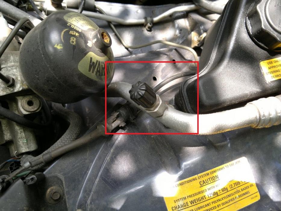

Hey rolex ,
I got a shot for you , this red marked area is what they changed at the last inspection after evap replacement . I hate to monger bad news but you will have to refill your gas again no later than 1 month because hissing sound you described suggests me your A/C is not done yet

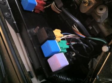

Hi Mike,
I think the first thing is to settle whether the hissing sound is a vacuum sound or the sound of refrigerant through the expansion valve. The best way I know to indicate is to eliminate one of them and see if the sound goes away.
When the noise is present, open the bonnet and find the relay at the RH firewall that has a green base. Unplug that relay and it will stop the compressor, but not affect the climate control vacuum system. If the noise tapers off and goes away, it's the refrigerant you hear. If it doesn't change, then you have a vacuum system leak that you have to chase down.
Good luck.
rolexmike (06-14-2011)

Okay Steve,
I disconnected the relay with the green bottom and sure enough the sound went away Next step? lol

Originally Posted by rolexmike
Okay Steve,
Well, two options. But first, you should settle on whether the A/C performance is up to snuf or not. If it cools properly, you have to decide if you can live with the hiss noise or not. If it gets under your skin, about the only thing you can do is replace the expansion valve. However, in my experience, replacing the valve is about 85% successful in curbing the hiss. Most folks that have presented a car with this noise have left it alone, but a few didn't like it and went for the expansion valve.
To cut to the chase, replacement may stop it, but there is a risk that it won't, or will only show a minor improvement. In any case, I'd suggest at least recovering the refrigerant and removing the valve, and checking it really close for any evidence of desiccant material inside. If there is any, that will mean replacement of the receiver/dryer as well, then charging her back up.
Ball's in your court, how big an issue is it to you??
