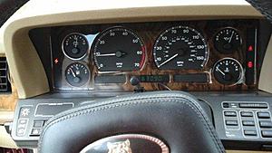

Hi! new here and have question. just bought 1992 xj6 vdp. with 63000 actual miles. up til now only been putting 10-15 dollars in gas . Gauge has been working. Decided to fill up for road trip. gauge not registering at all now and low fuel light on. Whats up??? I know there is at least 18 gal (us) in tank. Plus, I noticed slight fuel smell in trunk and no spillage.

My guess is a faulty sending unit in the gas tank.
But...repost your question in the "XJ40" section. Someone there will help.

Hi! new here. have 92 XJ6 Vanden Plas with 63000 actual miles. runs great. Been putting just 10-15 dollars gas in it. Gauge working fine. Decided to fill for road trip. Now gauge not working at all and low fuel light on. What happened???

I would hazard a guess that the sender unit is the problem, run the tank down, after half the tank has been used you can remove the boot/trunk cover behind the spare tyre and access the sender unit.
Use a brass drift to release the clamping ring and withdraw the unit. Check for continuity on the resistor track.

Don't know what happened. Now gauge is working! Live on stone road with potholes. maybe one jared it lose. Have to keep eye on it. Will be taking to a Jag dealer in Roanoke, Va. tomorrow. Automatic seat belts malfunctioning. Was told they're under some kind of warranty/recall by jag and will be fixed for free.

Mine does odd things as well when it's below 1/3rd of a tank. It will drop to near empty, then full empty, then jump back up close to 1/2, and repeat in that order in 10 minute cycles.
I credit that to quirks of a nearly 30 year old car, and I generally don't let it get lower than half a tank anyways.

It is not uncommon for the fuel sender to begin to operate intermittently as it fails. The sender is part 13 in the diagram below. It is secured to the side of the tank by the lock ring, part 14. Part 15 is the sealing ring or gasket. The fuel tank is behind the back seat and is accessed via the trunk, behind the carpeted trim panel.

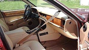

to all thanks for reply's. Talked to Roanoke jag. very rude and said he couldn't find my vin on jag data base. said no recalls. Called Richmond jag, found my vin on jag database within seconds and said yes there is a recall. its considered a warranty for life. But I need to bring car to them to see what parts are needed. so, hopefully a lifetime warranty means parts where put back for it or maybe a simple fix. hoping track got pinched and won't let it travel Thanks for tank schematic. It will come in handy. will keep updating. Recall number I found on internet is #93V179000. also found a recall for fuel filter. But don't think its jag directly but Fram #06E043000. Looking for a decent leaping jag to fit 92. I have a gold medallion right now and don't care for it. Found one on ebay for 25. Like to find one a little cheaper.

I have a 1992 as well. Do not let the dealer push you around on the seatbelts. Print a copy of the TSB if you have to when you go in. The seatbelt system is warrantied for life. My motor/winch assembly needed replacement and my local dealership did it for free. Whatever you do, do not touch the system yourself or have any other mechanic try to fix it because they can and will claim that it's been tampered with.
If it's not working right, use the emergency latches which should be in your glovebox.
And its not a "recall" per se, but a TSB which clarifies Jaguars obligation to provide a lifetime warranty.
Ive heard that Jaguar has sourced new manufacturers for these parts and have started production to allow for future repairs.
My driver's side belt has been acting up, where the belt goes rearward, and latches, but the end switch doesn't seem to be closing, so the motor will continuously cycle due to a thermal overload switch in the motor. This will cause my blowers and lamps to dim every 5 seconds while the motor draws amperage.

thanks. will be taking it to jag in Richmond, va. At least that service mgr said there is a warranty on it. needs it there to see exactly what's up with it. nice 2-3 hr. drive. drivers belt will go back and lock in fine. But when you open door to get out, it goes forward and stops about half way across the top. for now I let it lock in place and pulled fuse and detached belt. Tired of hitting my head on it. Passenger side works fine.

Wow, quite a drive. I'm lucky mine is only 15 minutes away. I'd imagine they won't have the parts in stock so you'll need to make a trip back for service once the parts are in.
Be sure to print a copy of this bulletin and bring it with you just in case:

Hey to all. Took my XJ6 to Richmond, Va. jag dealer. very professional and friendly. Found my vin and the seatbelt warranty in seconds. parts are ordered. But now I have two questions regarding 2 other problems that creeped up. First is I am getting a thump- rattle on the right front. Guessing its either ball joint or shock tower bushing. Easy enough to fix. Is there two bushing per shock (lower/upper)? Second problem is more complex. I am having a power drain. If I drive car everyday, its fine. But if I let it set for a couple of days, battery is to low to start. I had battery, altenater, starting system checked. All are okay!. Jag service mgr. thinks it might be a relay somewhere stuck. I sat in car for 1/2 hour one night in the dark to see if interior lights stayed on or hear any electronics making noise. Nothing!. Anyone else have this problem??. Anyway, Jag said it will be $150.00 to trace drain, and they need to keep overnight. OH! Gas gauge has been working fine. All the mechanics at jag loved my car. They were all standing around looking at it. Sales mgr. appraised it at or about $6000. Which is good, considering what I actually paid for it. I was shocked to say the least! Question for all. Do you all have any time of year meet somewhere???? Would love to see all the Jags and meet other members. Well, good day to all and drive safe.--Thanks Bee Gee

Got seatbelt fixed-no charge! After power drain diagnose, determined it was the battery. One I had was only 600 amps. Factory original was 900 amps. power drain draw was with in normal factory parameters. So I bought a Jaguar battery (900amps) for it. So now its wait and see.
