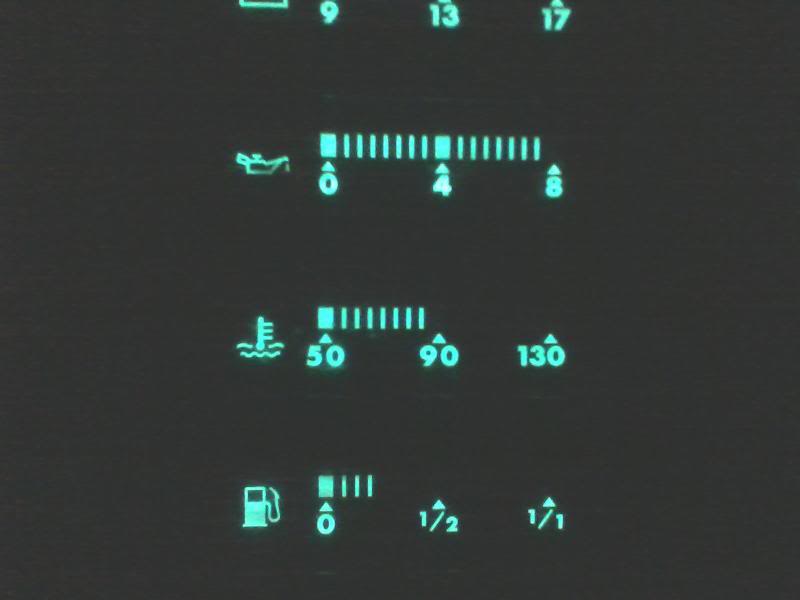

My 88 did that when I first bought it. After reading up, I swapped the out out to 20w50, and I went from being in the red to the gauge maxing out.
this is at idle now.
