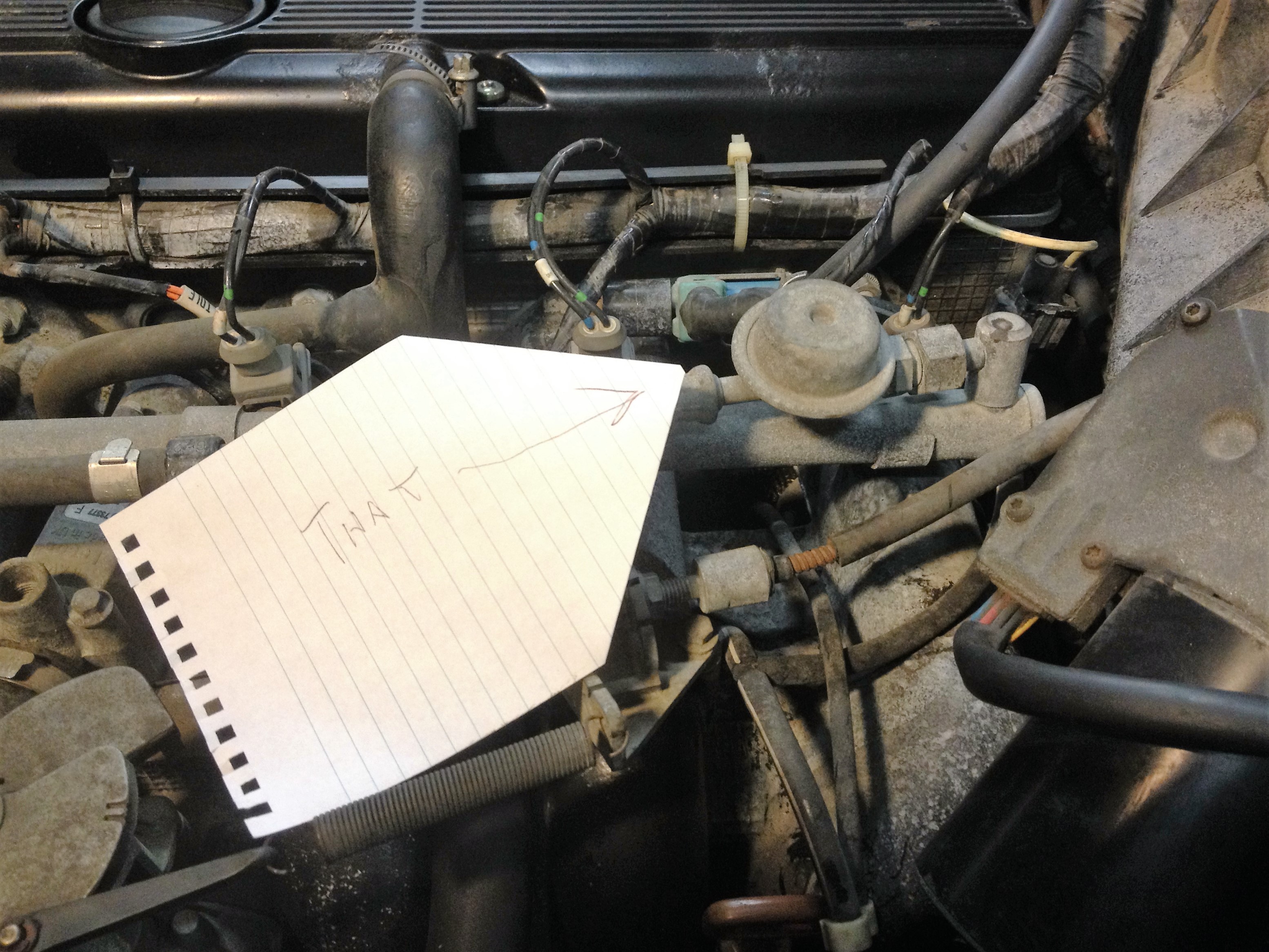

Again sorry for my ineptitude. these are the 3 fuel pressure regulators on or near the fuel rail, and the shifter housing itself or as much as you see fit to send. Thanks

I have all this Jerry, (I'll PM you later), the circular "regulators" are part of the fuel lines so come attached with the lines - the lines separate below the brake master cylinder
