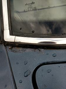

Unfortunately, I found my trunk leak. The left side lower corner of the rear windscreen has a fair bit of rust, and it's leaking into my trunk when it rains. I lifted the seal to peak, and it looks like it goes most of the way towards the pinch weld.
My question is, can I pop out the rear windscreen without destroying the seal, or is that a futile effort?
Perhaps I should source a new seal anyways.
Cheers, David

I replaced my rear screen earlier this year for the same reason. Easy to remove with this tool
I managed to reuse the surround, the screen is held in by a polyurethane bead, approximately 10mm across the base by <>15mm high with a triangular profile.
I would suggest that you pay somebody to apply the bead and insert the screen, I had a local company do it, they spent quite a while preparing the edges to be bonded. They also have a gun which lays the bead on precisely. It was very easy to insert the retaining insert and chrome, either rubber grease or Vaseline.

Thanks Robman, that information helped me. Since the windscreen isn't held in by the weatherstrip, I may spend a day and remove the weatherstrip just to get a better look at the problem area.

Definitely bonded. BTDT BTW that is exactly the same place mine rusted away.

Seems to be a common area (my dad's S3 also went in the same spot, but not to the extent of mine)
I've also got some rust in the forward section of the driver's side sill, and in the driver's front fender, just above the sill. All in due time I suppose, but Id like the trunk to be dry first.

Well, I popped the weatherstrip out of that corner to have a peek. The extent of the perforation, is 2 holes about 3/8th of an inch in diameter (after poking with a screwdriver and a quick wire brushing)
Think a fellow could pack those holes with some sort of sealer, to at least slow the leak down untill I have time to fix it?

Short term yes, I would be inclined to spray with some rust converter in the interim just to try and slow down the attack. I would be inclined to use a fibreglass filler for a long term fix as it repels water, but is difficult to sand. for a shorter time frame use bondo.

I might just do that, since it's rainy season. Once the car is off the road, I plan to pull the window out, and weld in fresh metal

Go online and buy some "Milliput" - you might be able to find it locally if you have a Michael's nearby ...call them first to find out if they have it though, as in Victoria I can only get it from a specialist hobby shop.
Milliput is a 2 part non-sagging epoxy putty that sets up fast (few hours), is rock hard and completely waterproof when cured - plus it will give you better adhesion around the peripheries (where bondo etc first fails).
In the uncured state it is water based so clean up is dead easy.
I've used this stuff many times for all sorts of purposes and most recently as a finishing/surfacing putty after repairing small rust perforations around the liner clips of the inner wings of my VDP.
If you do the a nice clean repair/get rid of the rust/do a phosphoric acid treatment on the rusted area you wouldn't even have to revisit it with welding, this stuff will last longer than the car!
