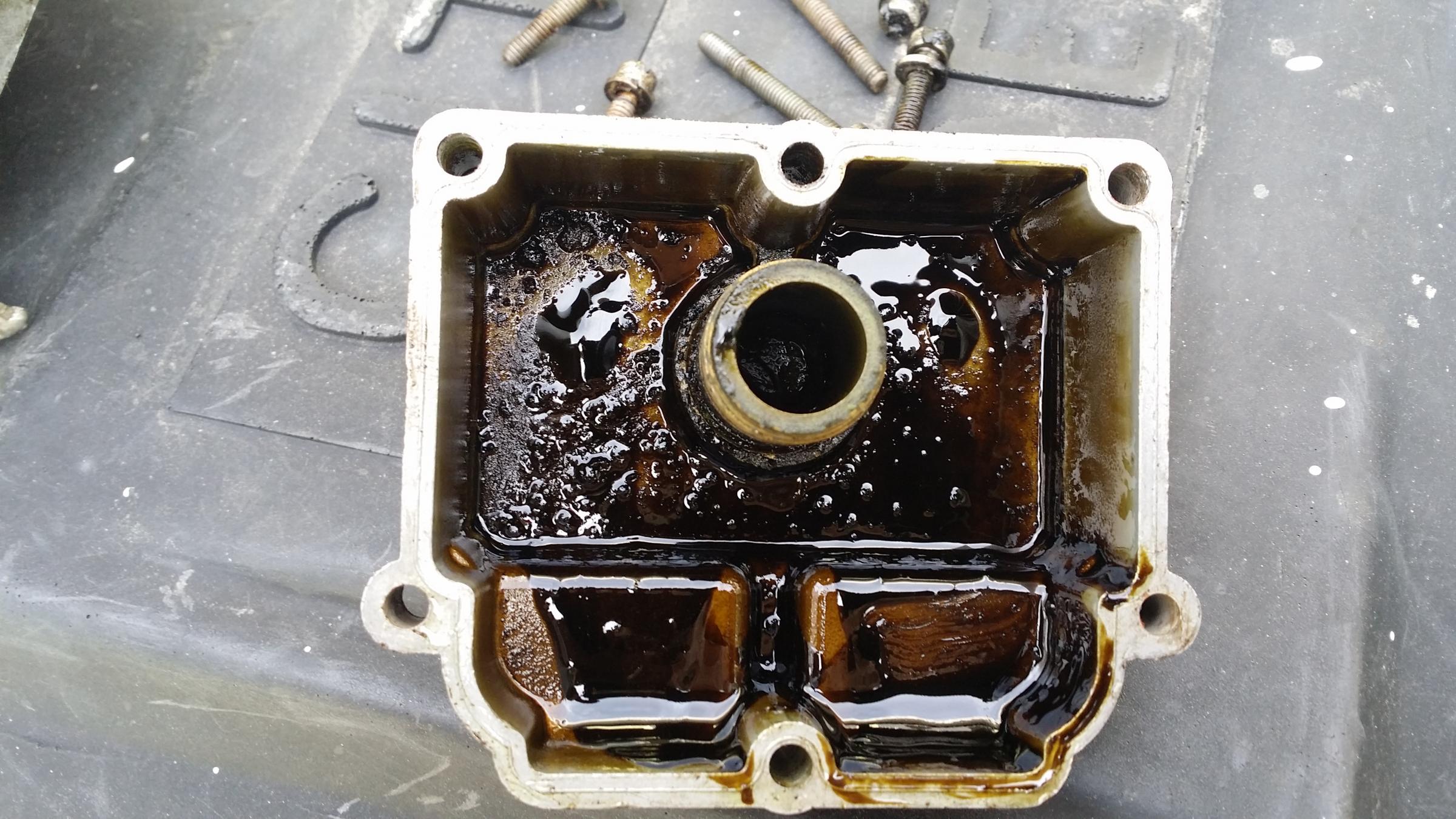

Well back at it! A week off and a new job, but nothing major to report other than a bit more tear down. Valve covers are off and no hidden surprises. Carbs have been dismantled and are awaiting rebuild kits. Old oil has been drained in what may have been the messiest oil change I have done (my fault, not the jags). I'm still debating if I should remove the intake for further inspection/cleaning or removing the cylinder head for clean up...
Would it be worth my time to tear into the top end more or should I fill up oil and go back into trying awaken the motor?
