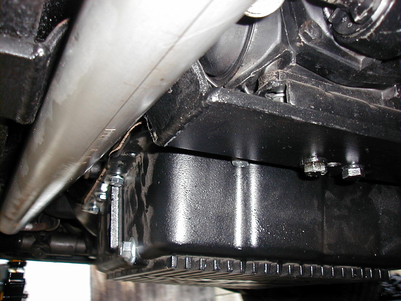

Are you planning to use their Surge Tank for the needed high pressure for the FI?
I was considering their system but converted to new S3 tanks and Pollak tank switching valve. Always wondered how well it would work and where I could install it in the engine compartment???
I have their heads on my engine and the conversion is best done with engine mounts from Jaguar Specialties... I like the trans mount from JTR best and used it in my SII 383/700R... easy to make and good access to the trans should any servicing need to be done.
