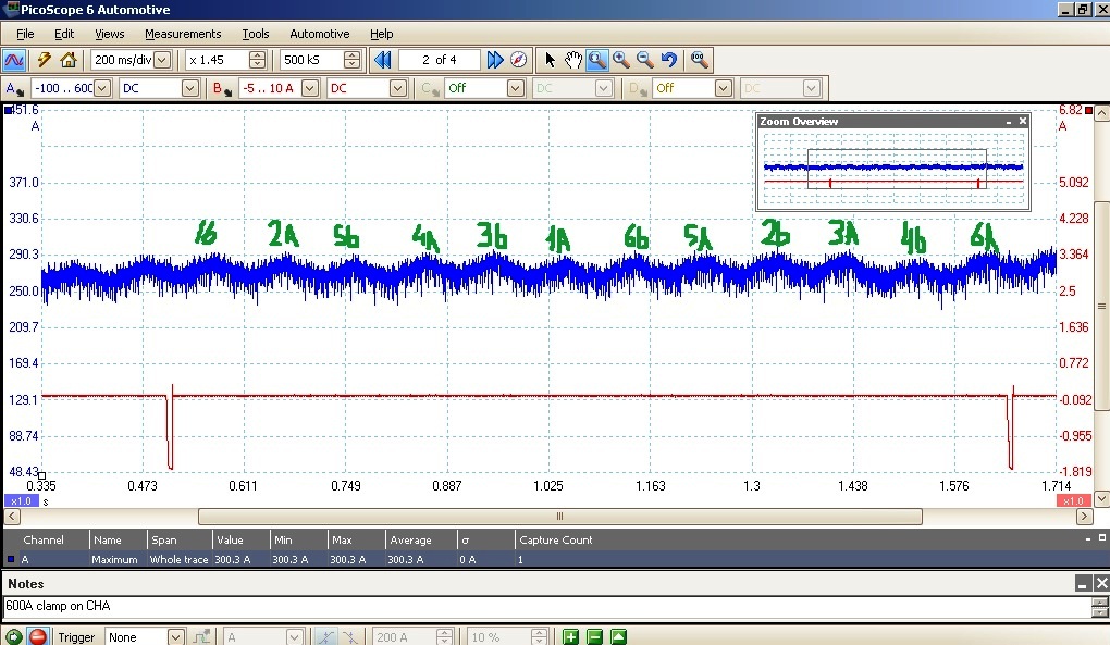

Compression test: before remove the old spark plugs, I connected the oscilloscope to check internal problems. The relative compression test was excellent, the 4b is the lower one.

Since I'm having this 'bank_B issue' I started to pull the center pluming to check the wire harness and ignition stuff.
Almost 11pm! Tomorrow more. The electrical harness is very bad and the spark plugs are under an inch of clay and crap.
I'm going to ask to my bed... why the bank B is not working well?
