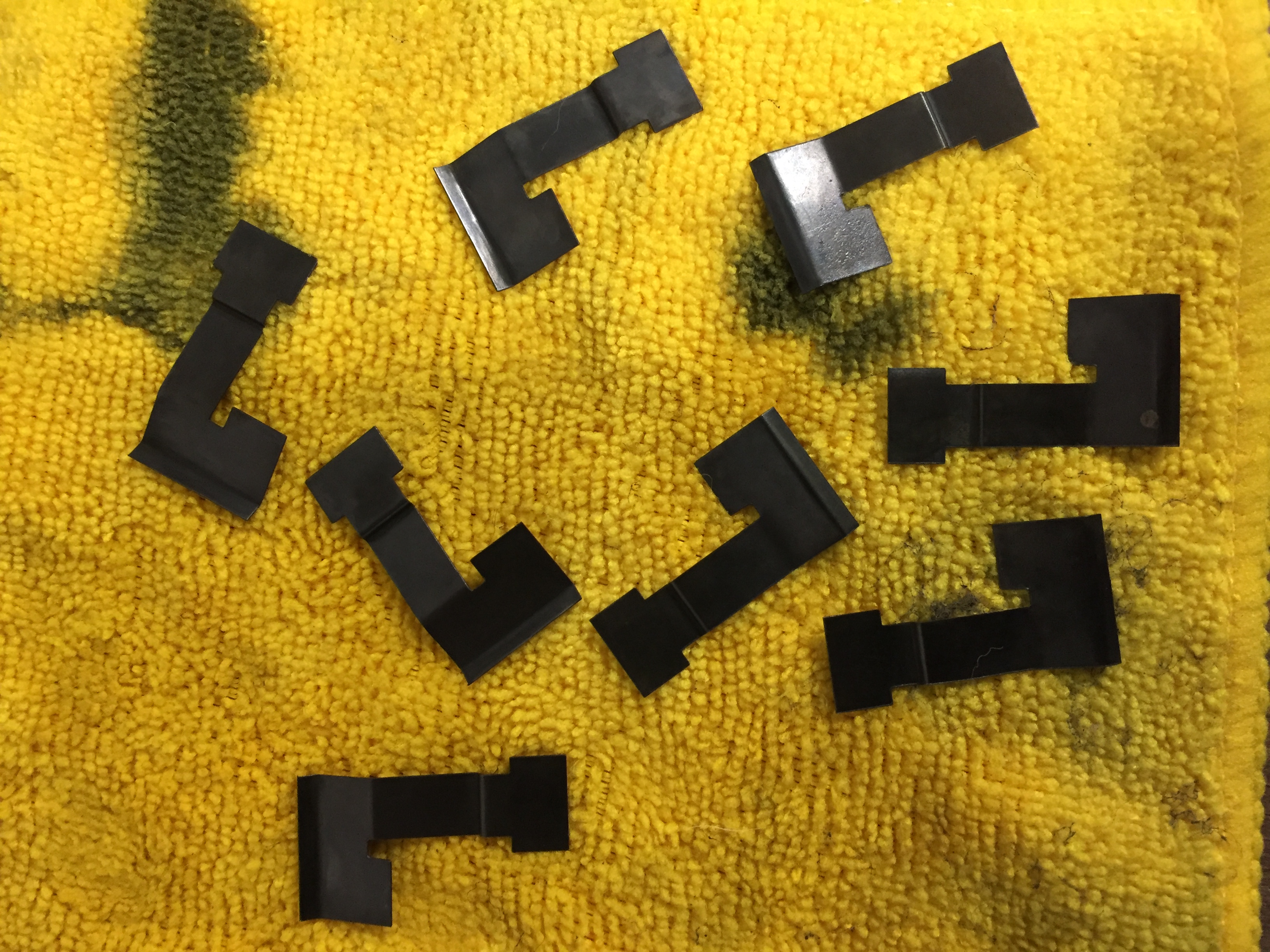

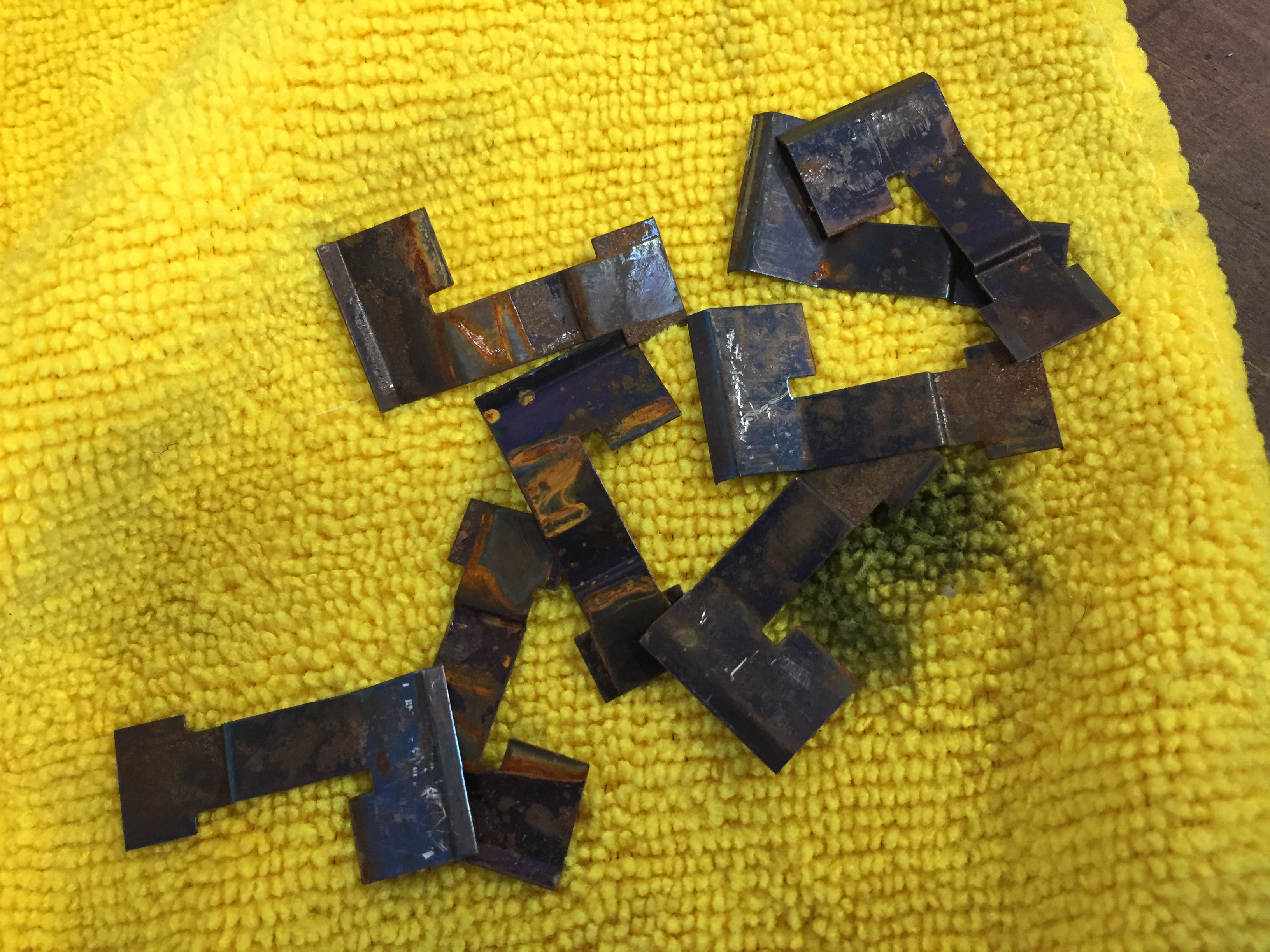

Cleaning switches + central console
Hi Guys, thanks for all your words, it really helps a lot. We started this project long time ago with a very limited budged and we have been changing the direction since the very beginning. The first intention was a car for Emma so she can drive around. We ended buying a ton of parts but we saved because we basically did everything home after work.
Sometimes I wish to spend more time on some parts and make it better, but I guess I can't 'over restore it' and also I don't have the time and I want to stick with the initial budged and make a car that Emma can actually drive around.
You guys are helping a lot. I didn't know too much about these cars. Although there is a ton of info on internet, it's not always very accurate and not very clear about the '76, series II.
Today I took apart the switches from the dash, very dirty, contacts with huge resistance,...

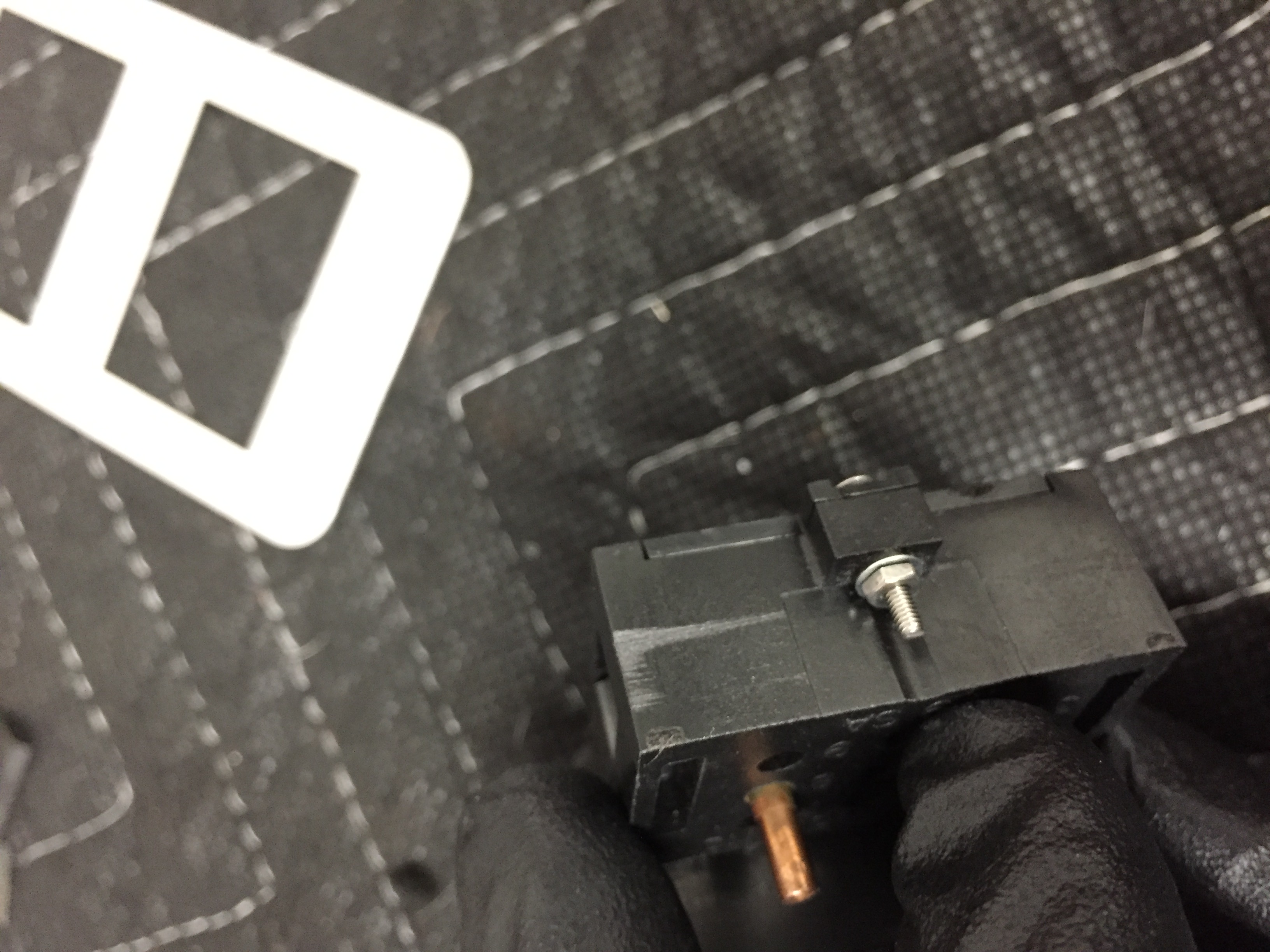

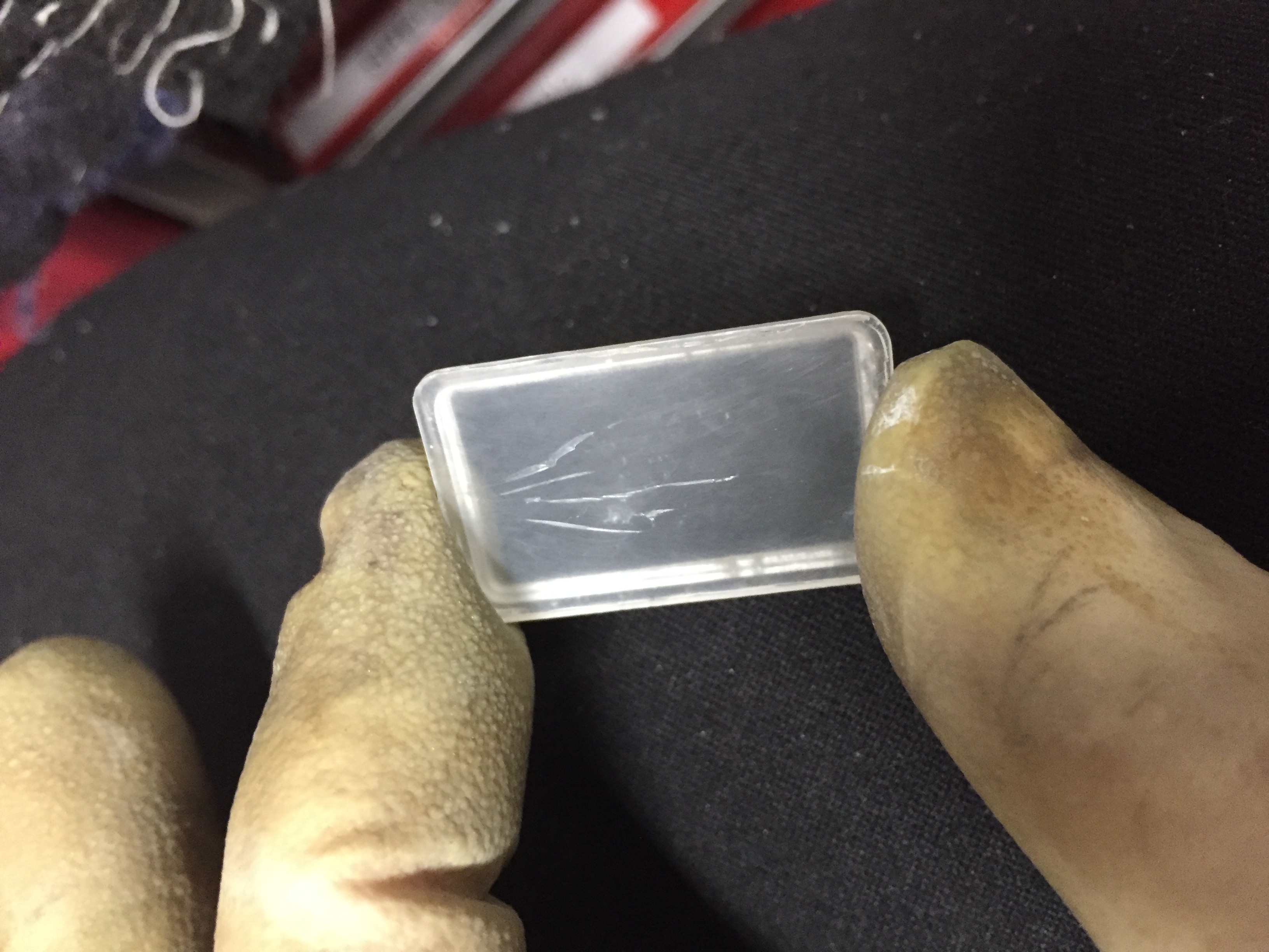

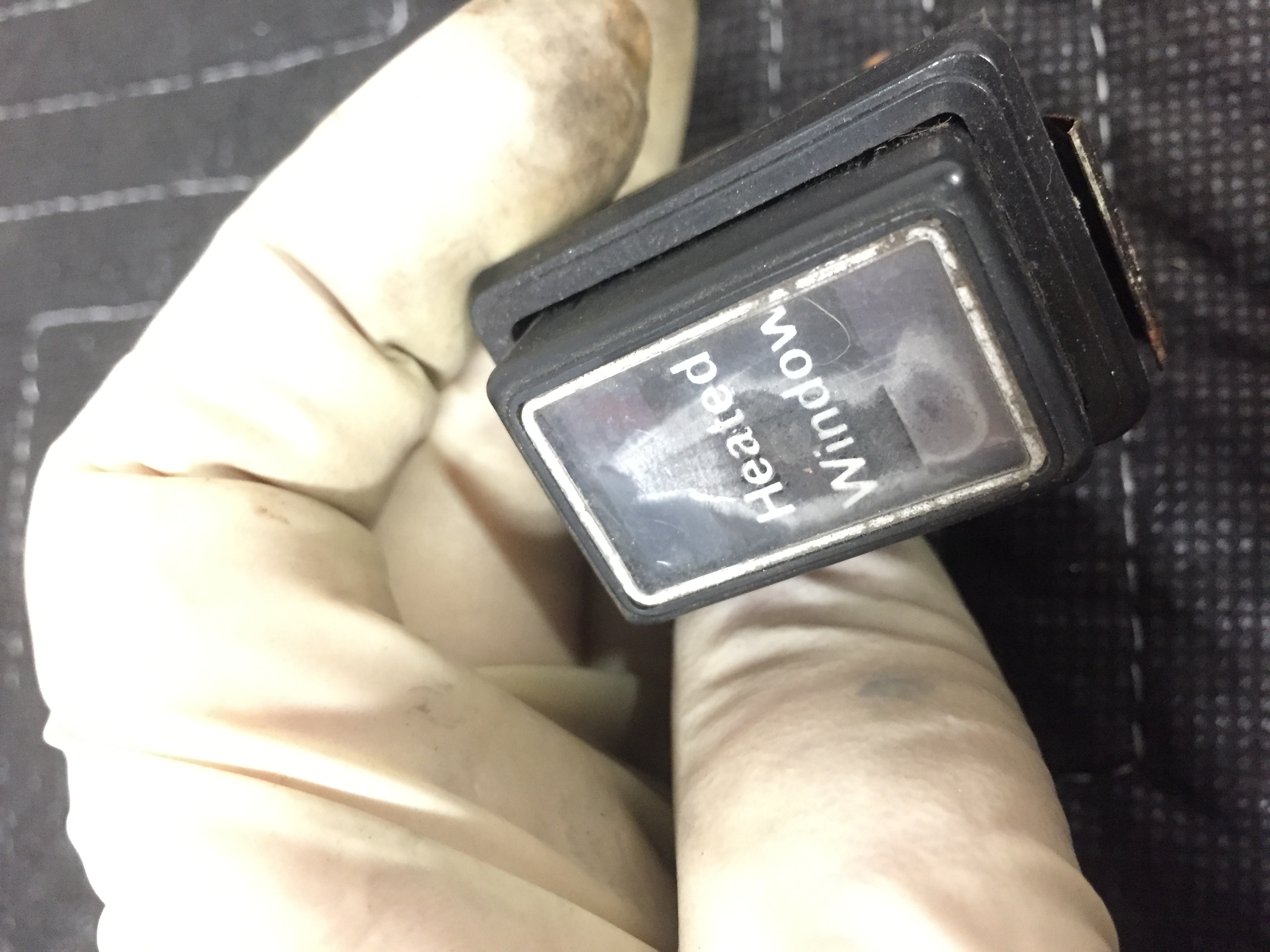

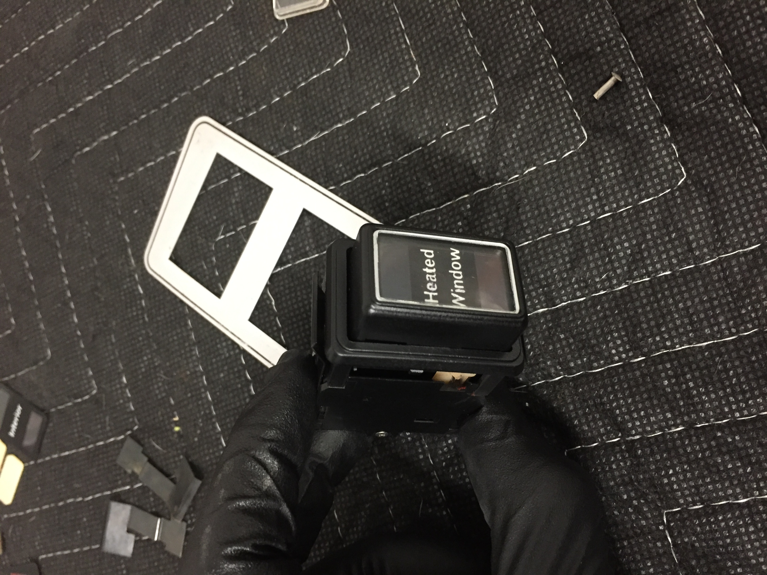

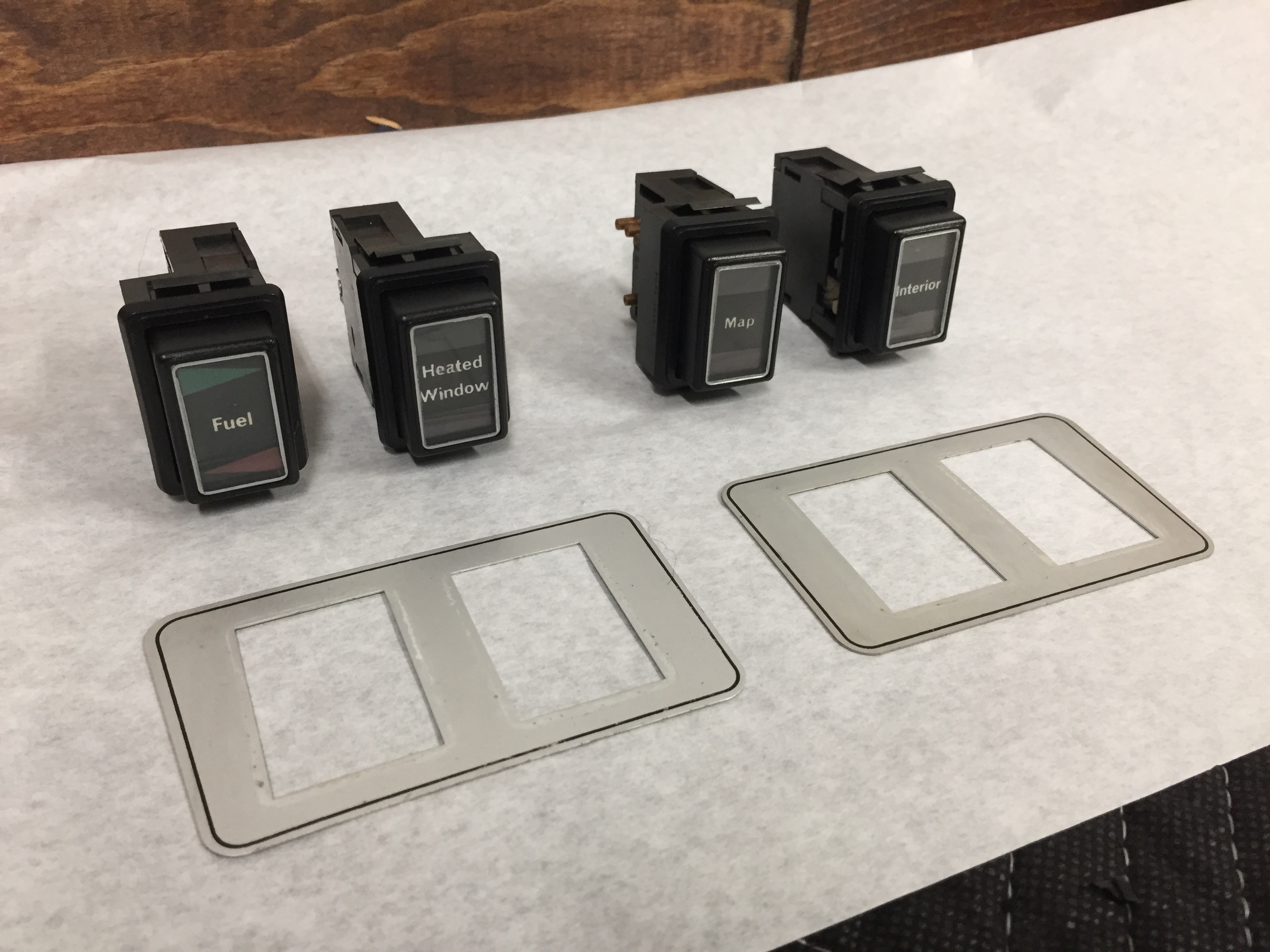

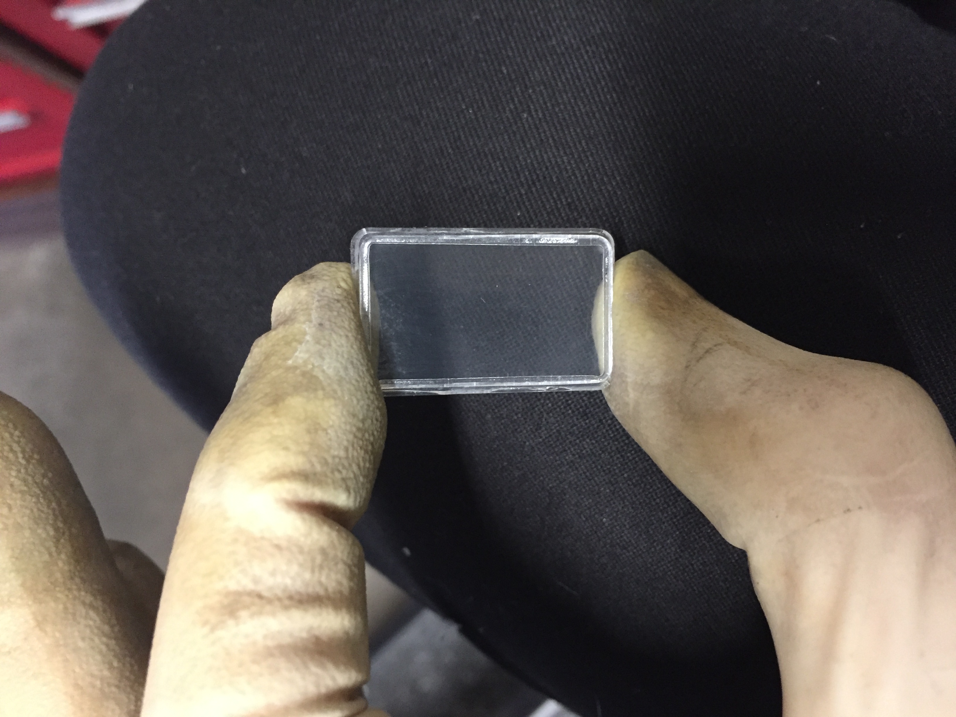

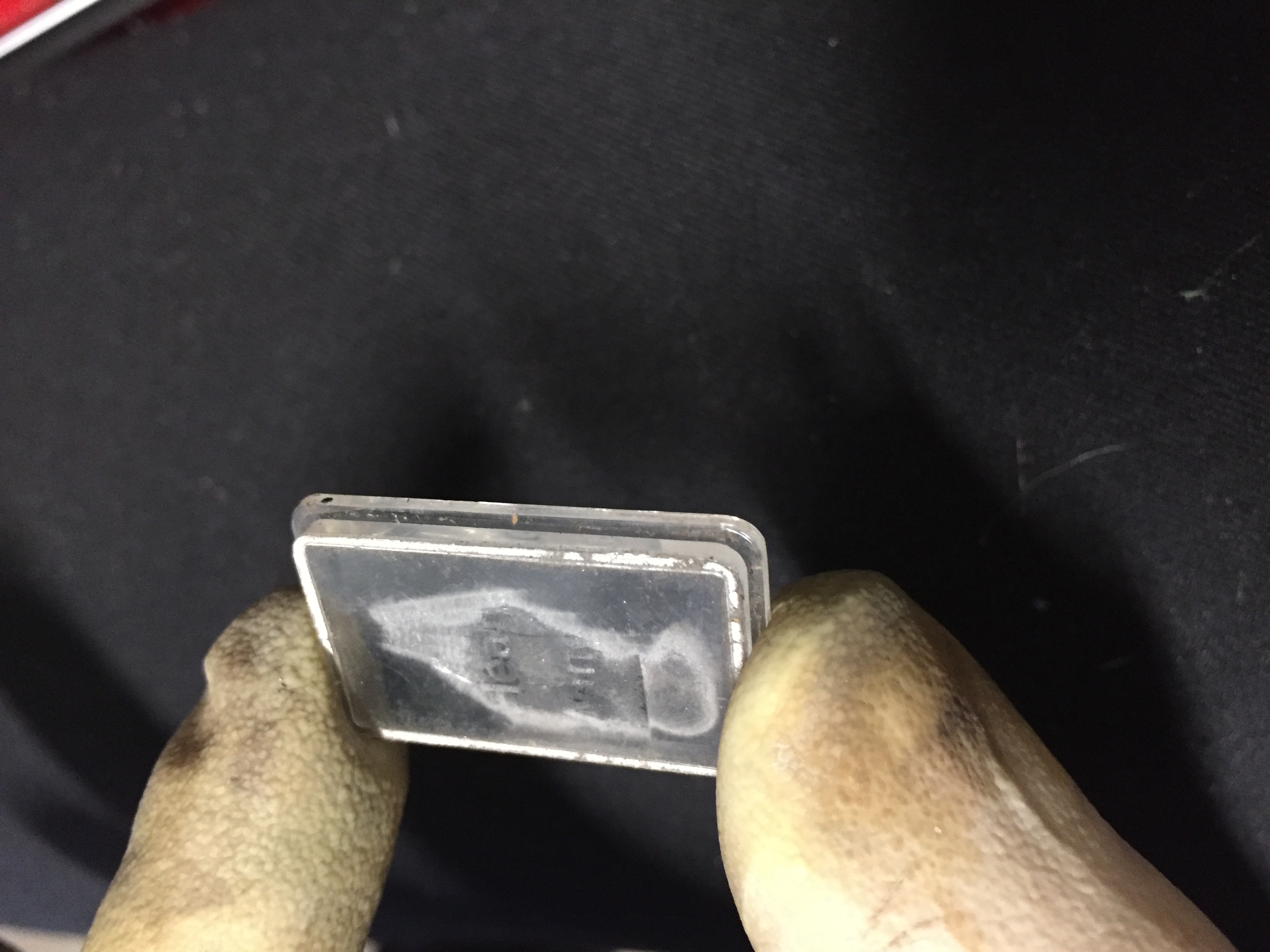

Switches
Hello again.
The switches are always a bit of time consuming. Some of the clear plastics on the front of the switches were very bad and some superficially cracked... It took me a while to fix and clean them. Clean the contacts electrolysis, plate the springs that keep them on place, redo the labels, paint the frames around the clear plastics. Two of the internal springs were very bad, very corroded, I made them new with music spring wire. Also I used a bolt rather than a rivet to keep them close, it's much easy for future cleaning.

Precise detailed work. Beautiful.
When redoing the power plant in my car, I needed a "check engine" light to make the SMOG referee happy. The dash had an O2 sensor light. Odd critter, it responded to a counter??? Time to swap sensors???
Unneeded in my car's reincarnation. Bob Loftus, created a new lens for that quaint little light. There is a thin transparent sheet that some if not all inkjet printers can print on. He put a few "CHECK ENGINE" words in few fonts for me. I chose the one that best fit and snipped it out and fitted it. The SMOG guy was impressed.
Relevance: A source of fresh new clear plastic. Printer fodder...
Carl

Yes, soon it's going to be time for smog for our car too. We brought the car to the very original and we completetly rebuild the smog items because I already know that is going to be tough (at least not easy)
I don't know your car since it has an American engine,...
About the printer, I know a place that they print with laser (check the videos) Gallery ? Sticky RX Refinishing Solutions

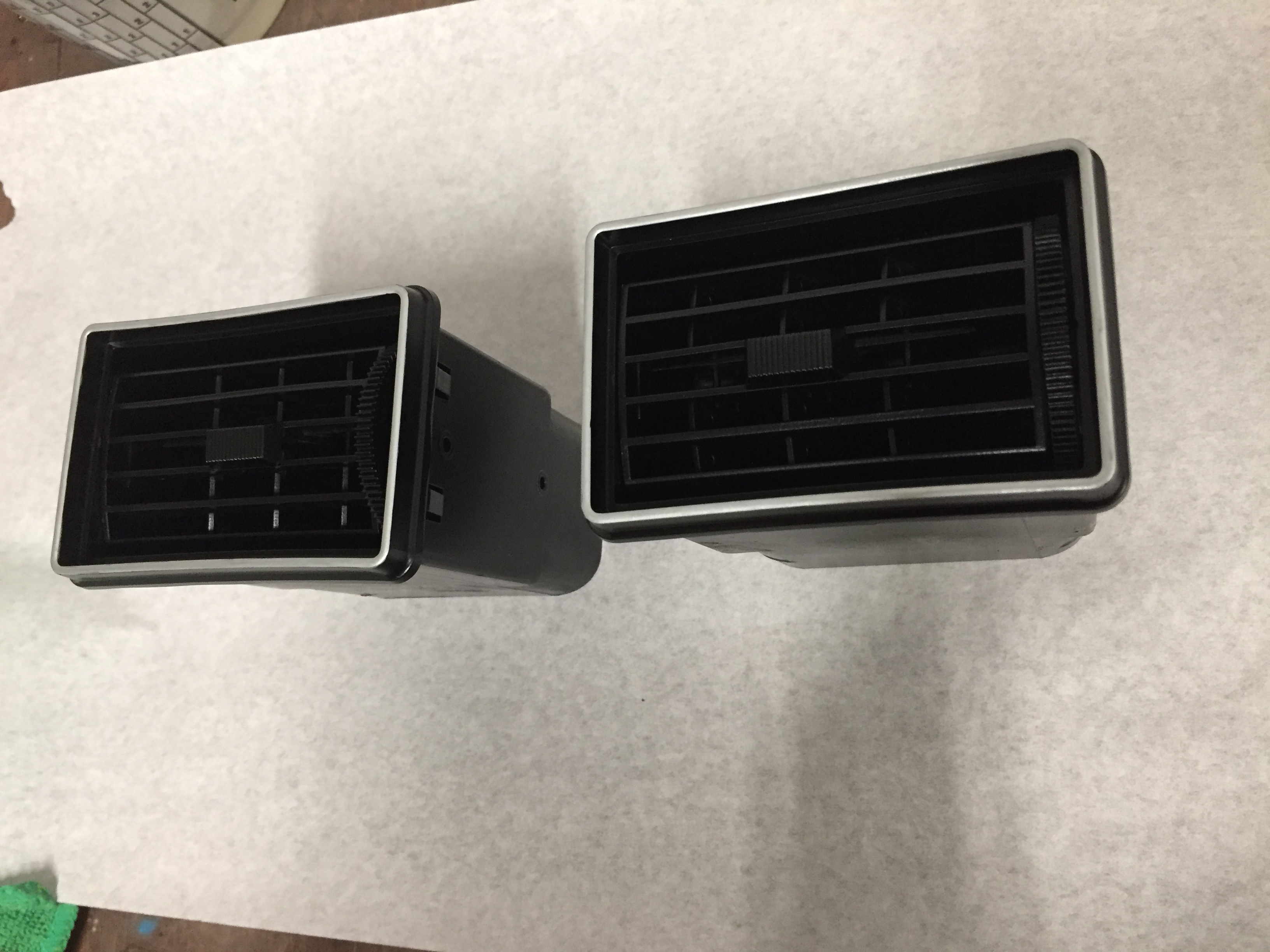

Speakers
Hi Guys!
For the last days... basically I have been cleaning the dash and climate control wiring. One of the electrovalves wasn't closing very well so I've ordered a new one and now I move on to the stereo...
Today I took the front speakers apart to prepare/clean/repair the plastic boxes and I'm preparing the new replacement ones.
Oh...! and Happy new year 2017!
Debbie
Debbie
