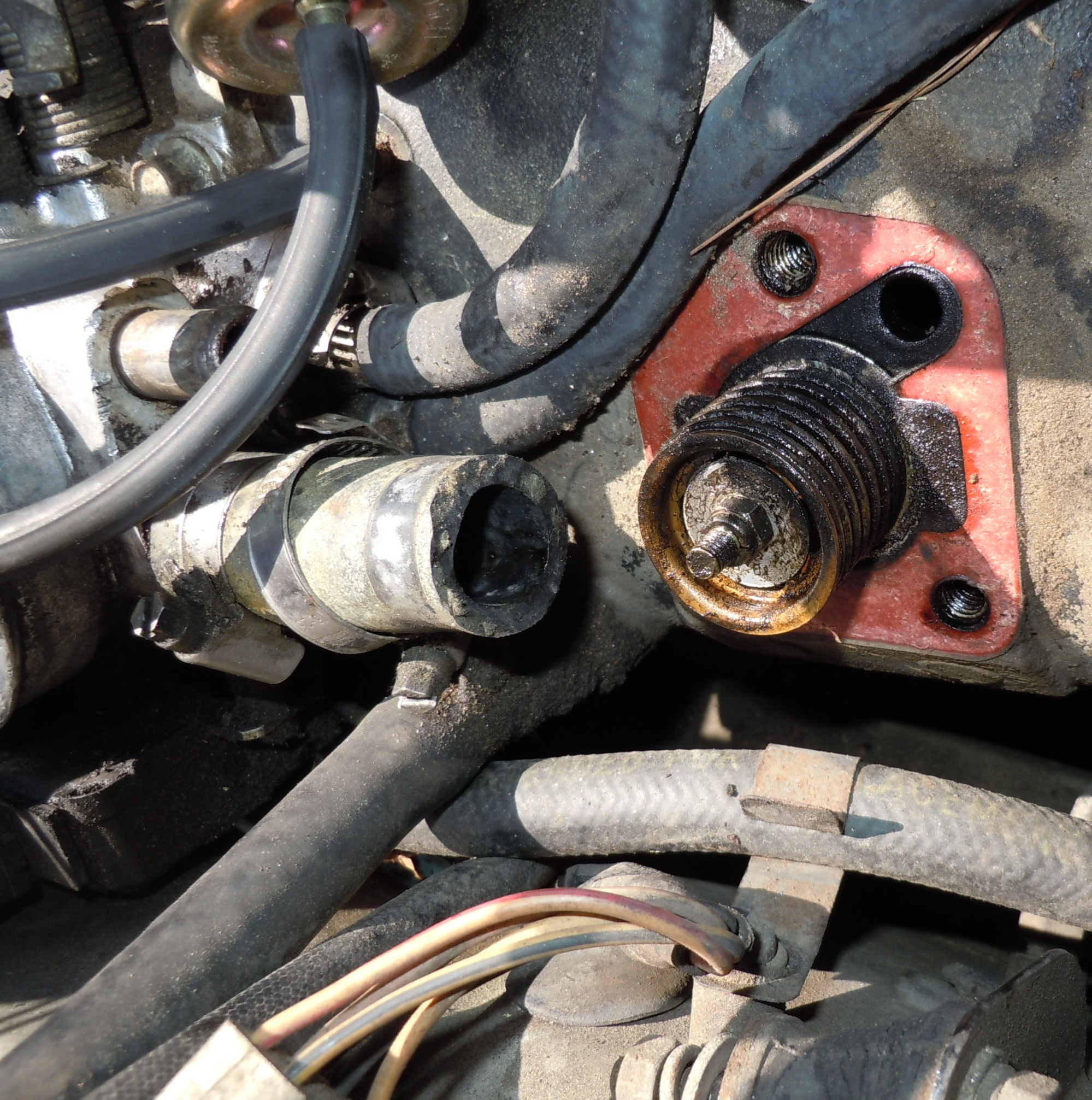

Well I changed the aux. air valve and put the old coil back on the car: cleaned electrical contacts.
The car has been normal lately however the stalling fits come back when the air conditioning is turned on. so it has to do with the a/c circuit somehow.
When it stalls it will restart but I must keep my foot on the gas just a bit or it will stall. If the car rests for a few min. it will restart and behave normally.
So is there some communication to the injection system when the a/c is on? Is it the AFM going bad and not regulating idle?
Again it seems to ONLY stall when the a/c is on AND the car is hot AND my foot is off of the gas.
Without the a/c on the car runs great, does not stall, only complaint is that it get about 11MPG city driving when last year it was closer it 16MPG.
Thanks!
