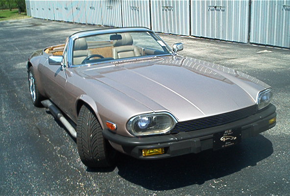

Default PIX my FC
pix ,my 1987 mazda FC,, dynojet 420whp, 2660lbs. lots of mods, suspen. brakes .
etc.
my modded 1978 lightweight jag aint got a chance against it, in performance and handling. dynojet 355whp,, 3360lbs. lots a mods also.
but at shows and etc. Jag gets lot of thumbs up.
different strokes for different folks. its all relative.
the most interesting performance car today( IMO)is
ken block ford fiesta phase 3 vid on youtube done in France, absolutly amazing driving.
Attached Thumbnails Aftermarket presence & support for the series 1,2 & 3 XJ chassis-mazda-jag-rodst-019.jpg   Aftermarket presence & support for the series 1,2 & 3 XJ chassis-mazda-jag-rodst-011.jpg   Aftermarket presence & support for the series 1,2 & 3 XJ chassis-mazda-jag-rodst-003.jpg   Aftermarket presence & support for the series 1,2 & 3 XJ chassis-mazda-jag-rodst-025.jpg   Aftermarket presence & support for the series 1,2 & 3 XJ chassis-jag-rodstr-005.jpg

Wow, 420 RWHP on series 4 plates??? Or dis you swap up for REW or series 5 TII plates?
How long have you been running those numbers (a long time I guess from your paint scheme , just kidding I love those old school race car
colors)
that is also probably the sweetest looking XJS I have ever seen.
420 in a rotary is a mover, are you on any rx7 forums?
My rotary screen name is PROMETHEUS, look me up!

engine series 6,FD, big single turbo.water to air.etc.
paint was cool in 1998, kinda dated today. but still turns heads.
im on rx7 club, ronbros.
XJS was done in 1994-1996, little ahead of the curve.
thx and good luck with your projects.
Ron,,,, vanity plate ,, REAL BAD BOYS DRIVE TWELVE CYLINDERS
