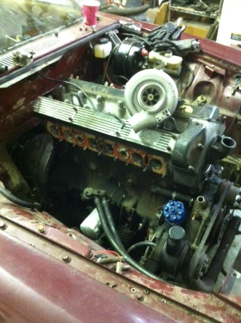

Attached Thumbnails Aftermarket presence & support for the series 1,2 & 3 XJ chassis-driftjag002.jpg   Aftermarket presence & support for the series 1,2 & 3 XJ chassis-driftjag003.jpg   Aftermarket presence & support for the series 1,2 & 3 XJ chassis-driftjag010.jpg

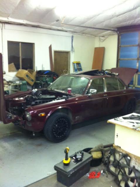

Old 01-24-2014 | 07:07 PM
AristoCat's Avatar
Joined: Sep 2010
Posts: 221
Likes: 27
From: Seattle, Washington
Attached Thumbnails Aftermarket presence & support for the series 1,2 & 3 XJ chassis-driftjag005.jpg   Aftermarket presence & support for the series 1,2 & 3 XJ chassis-driftjag007.jpg   Aftermarket presence & support for the series 1,2 & 3 XJ chassis-driftjag008.jpg

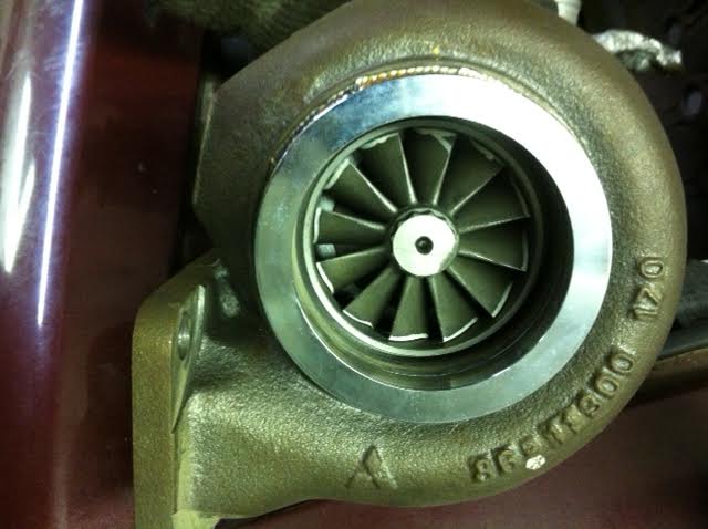

Old 01-24-2014 | 07:08 PM
AristoCat's Avatar
Joined: Sep 2010
Posts: 221
Likes: 27
you can kind of see the trans. adapter plate, but thats all I am going to show of the technical stuff, until its ready.
