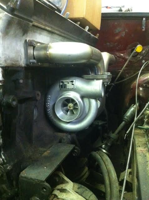

P.S.
Turbo & manifold are fixtured into the engine bay, for preliminary mock up.
Still need to figure the wastegate plumbing.
Now I'm modding the front for piping & putting in some black paint into the interior.

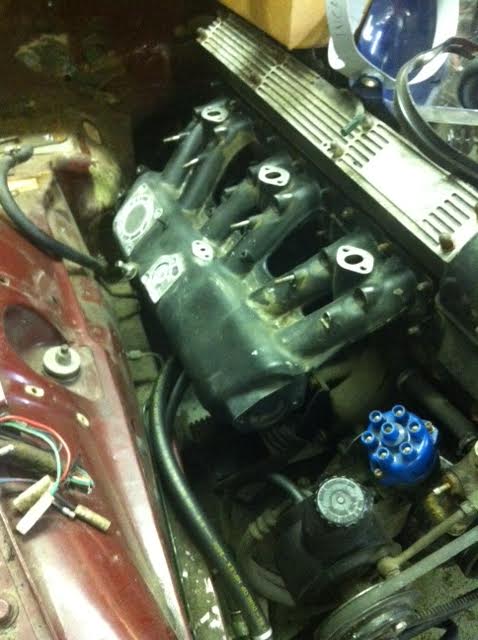

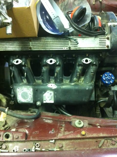

Odd:
I found the wires from cabin back to be decent. Under the scuttle, not bad either. It was in the engine bay that some were just heat cooked. Those in the vicinity of the DOHC. Others reasonably decent.
The DOHC exhaust header/manifold is decent. I doubt that tube headers are going to get much of a gain. The intake has to be better.
But, as the stroke limits high rev sustainability, I wonder where breathing improvements will take this engine.
But, a turbo properly sized will liven it up.

This engine will make all it's power/ torque down low, we know that already.
We're going to limit it probably to 4750 RPM - 5000 RPM
I'm thinking we're going to be running into oiling issues & Cam short comings.
The hot side on this turbo is so damn big, that were currently on the lookout for an alternative sized solution.
We aren't going to tear into the engine until something fails, luckily thr rebuild components for this engine are stupid cheap ($60.00 USD for rings & gaskets)
The engines are also thought of as being weak, so they are commonly discarded for LS/ other engines, so you find the for free/cheap often.
Just gotta figure it out for ourselves.
On the plus side, I'll document these issues as they arise & post them up here, for everybody to learn from.

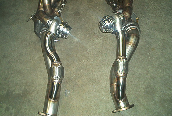

Promethieus; what do you think of this stuff? for 2010 GTR, the factory exh. manfolds wouldnt take a bigger turbo so they came up with this setup. workmanship is impeccable!
car made 850whp ,after a day of tuning!
yes nothing was stock, money no object!!
and the kid doing the work is 21yrs old, and a good friend!
Attached Thumbnails Aftermarket presence & support for the series 1,2 & 3 XJ chassis-elitemtrspts-010.jpg   Aftermarket presence & support for the series 1,2 & 3 XJ chassis-elitemtrspts-011.jpg
That work is awesome.
I'd shake his hand, if I ever met him.
It's always great to see what others are doing, so you can learn & adapt to what you're doing.

i agree that turbo is out of proportion hot side vs cold side,
turbine is way to big(take a 1/2 hr to spin up,&make boost), and compressor is to small for much flow down low for the torque you hope for!
nice manifold tho, should do the job you are looking for(some are gonna say it aint equal lenth runners) dont worry it will be good enough!
iv done around 30 turbo engines in the last 30yrs, and tried all kinds of stuff(some better than others).
used to be that an old truck turbo was good enough, not so today, cost has gone up 5 times what was usable back then(and so hasnt HP).
im not going to comment on the XK engine, i never had much luck with them.
by now you are learning more about that design, strength and weaknesses.
anyhoo, good luck

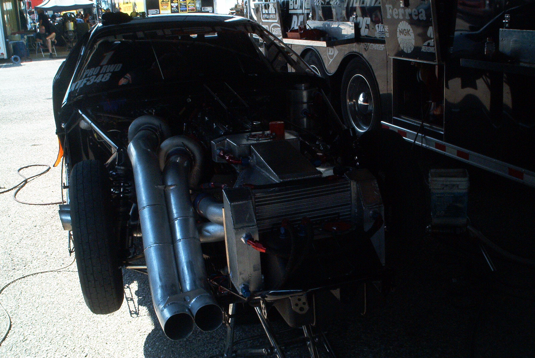

prome; quick pic of a 2JZ twin turbd, about 1/2hr after i took the pix, car went a 6.9 at 207 mph, 1/4 mile, dallas TX.
YES he won his class + some other records,(darn supra s).
google 1320video.com and texas streets, some of the bad boys around texas
Attached Thumbnails Aftermarket presence & support for the series 1,2 & 3 XJ chassis-dallas-race-2007-003.jpg   Aftermarket presence & support for the series 1,2 & 3 XJ chassis-dallas-race-2007-002.jpg
