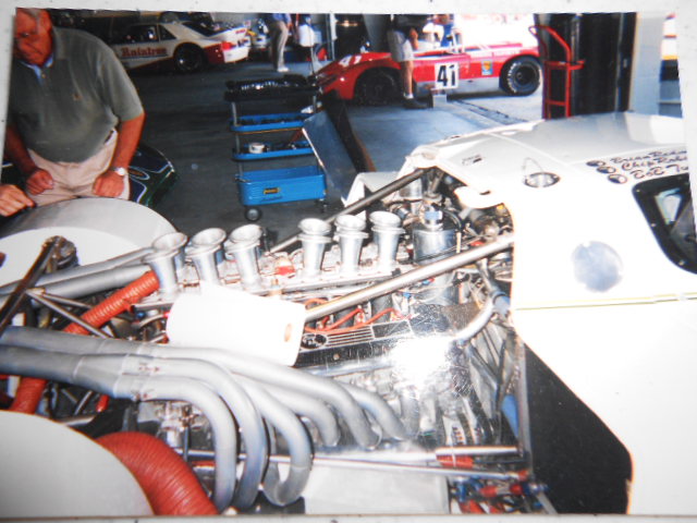

pic of 12 ITBs on a jag V12, rare,to say the least!
never came on a factory V12 car!
these were cast from magnisium,not aluminum,(lighter weight), and tapered trumpets. they have a slide throttle plate, not rotate butterfly type!
grp 44 racing mid 1980s, sometimes show up on Ebay.

That's awesome.
I've actually made a slide type throttle body for a 13B from machined aluminum from the housing & a machined PTFE plate for the slide.
It worked pretty well, until boost hit above 5psi, then it would stick due to thrust loading.
So I went back to the OEM throttle body design.

true about slide throttles and boost pressure,
seems lately that barrel valve type throttles are in favor, on hi-tech turbo engines.
of course DI(direct injection) is the ultimate method at getting fuel into the chamber!

The trust load issue could be managed by inserting the PTFE slide into a plate that sits on roller bearings.
