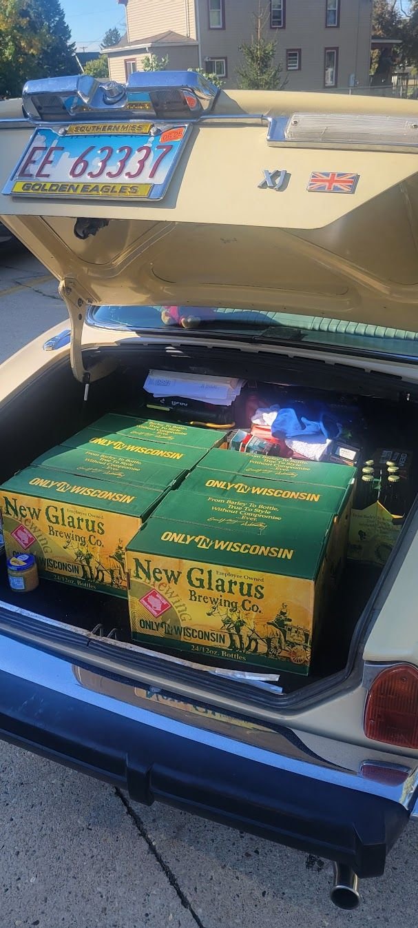

I added another 700 miles to the odometer this weekend with a trip to my parent's house. This brings my total mileage up to 3,200 miles this year. The trip down Friday was cool so I left the AC off and opened up the footwell vents to get some fresh air flowing through. The trip back today was on the warmer side so I cranked the AC low, flicked on the cruise control, and listened to some tunes while I clicked off 300 miles. This is really a great car and loves to cruise down the interstate.
