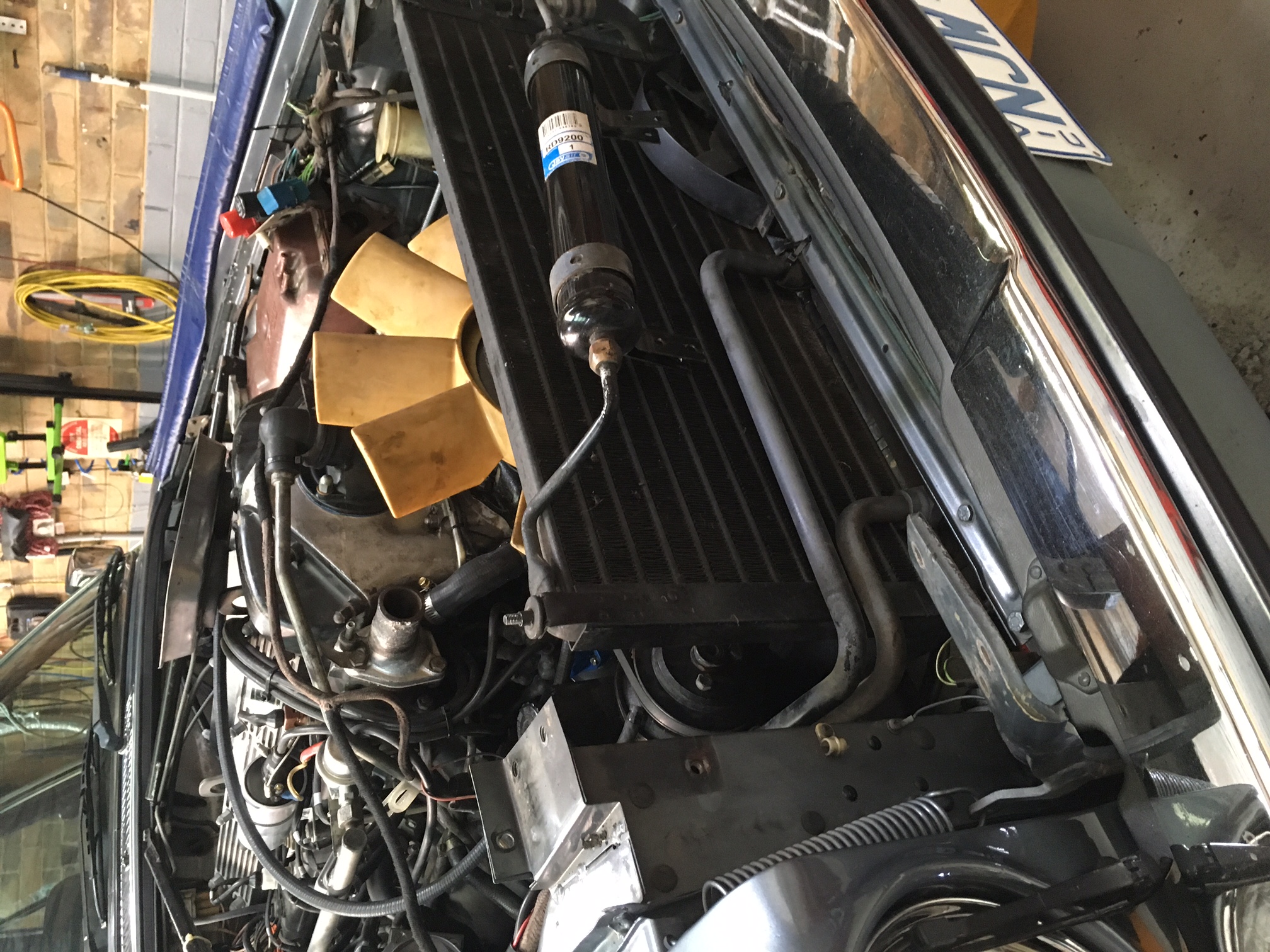

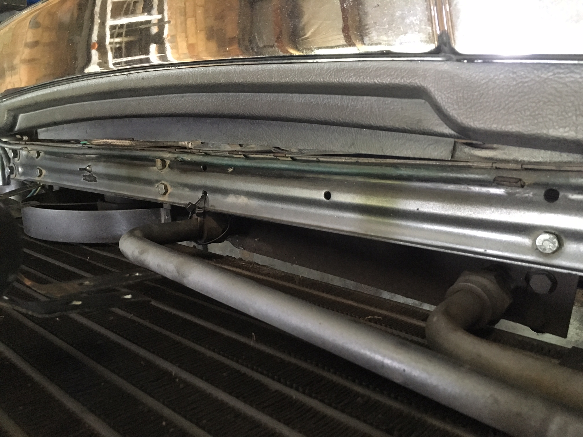

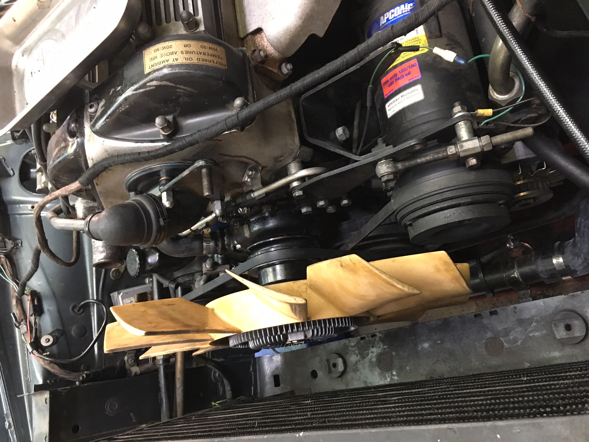

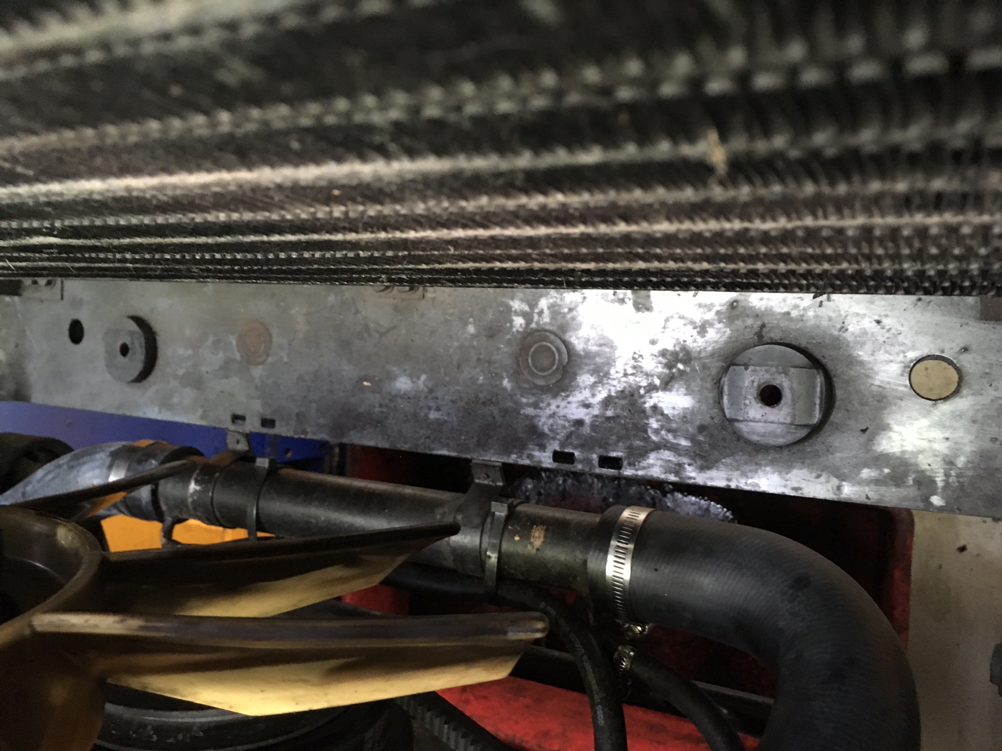

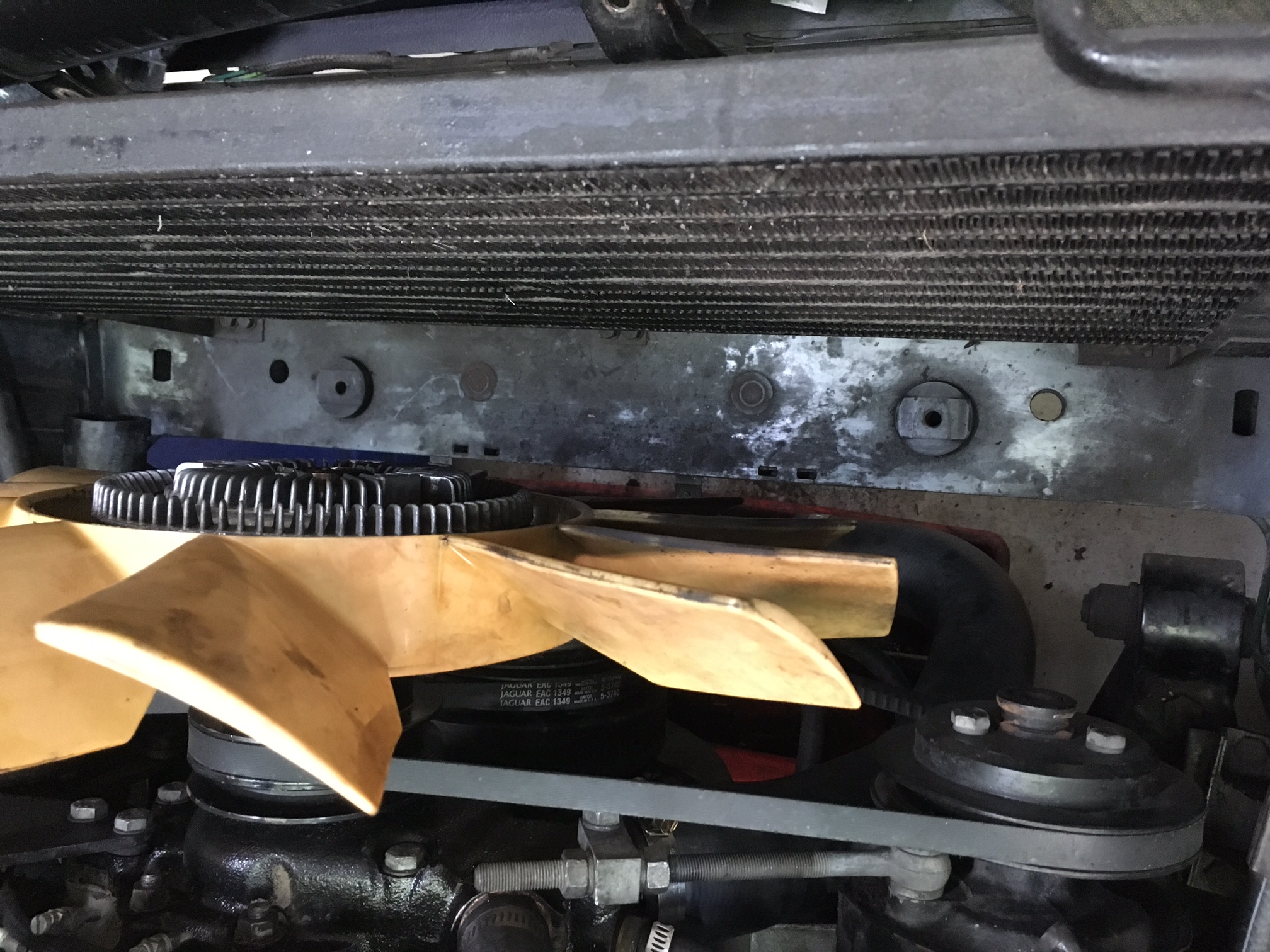

Hi All,
Well I've had the car for 18 months and coming into summer decided to have the cooling system flushed as a precaution due to the fact that I don't know when it was done last.
My mechanic pointed out the potential problems of upsetting sleeping dogs, however after doing a specific gravity test of the coolant and exclaiming 'holey c**p, that isn't good' and my observance of the green changing colour a little, it was decided to flush the system but without chemicals.
Needless to say a couple of days later I noticed the coolant reservoir requiring daily top ups and then the puddles of green under the front of the car after being left for a while.
Sure enough the flush flushed the remaining molecules out which were holding the rust to the bits of the radiator which weren't leaking.
So now I'm off the road whilst the radiator is being re cored I made the mistake of looking at the space in front of the engine with the bonnet off.
New coolant hoses all around, fitted a reco water pump and have cleaned off 30 years of accumulated road dirt from the front of the engine and cooling fan.
I could almost eat my dinner off of it, as we all know it gets hot enough in there to do it!!
On the upside, the front cross member has zero rust in it. I was a little surprised.
As a bonus I also recovered the little plastic cup / lip which we all had on the front of the air inlet trumpet at some stage. It must have dropped down way back when and no one bothered to recover it. My gain!!
Due to the fact that I don't have the space, nor the time currently to do this job, my mechanic is doing the majority of the work, so it won't be a cheap exercise, but at least I shouldn't have any cooling troubles for the foreseeable future.
Cheers and happy motoring,
Nigel
