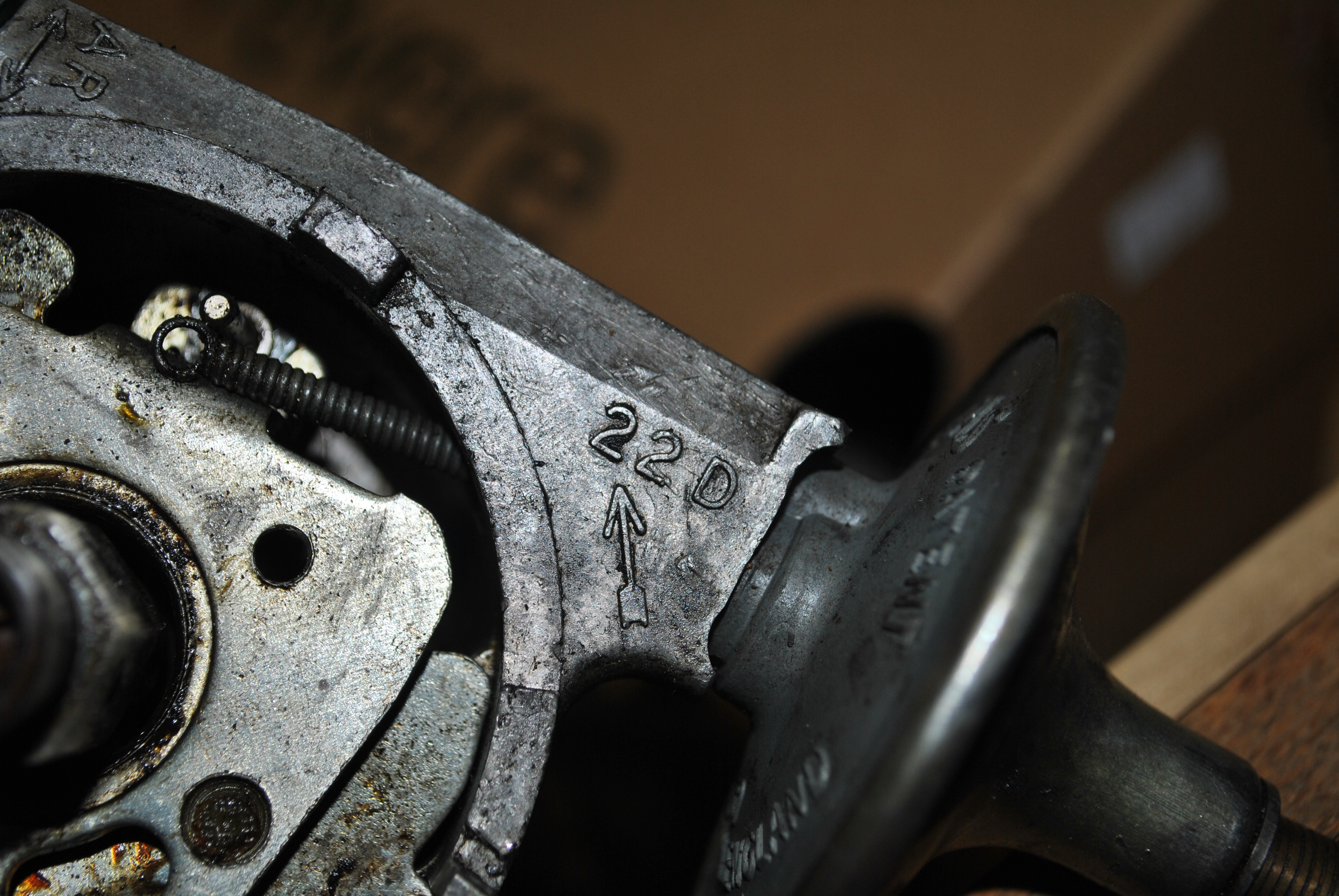

Further to my distributor issues other month, was giving the unit a clean to see if I missed anything, just wanted to add that right on the bottom of the bowl of the unit there are some additional printed numbers, in case they tell anything useful, likely not. Unit is a 22D Lucas.
54 4117 49
22D 6
marked under the lower plate beneath magnets and springs.
still same issue, voltage in but none out.

Continuing the distributor conversation, just more so I know if I am doing this right or wrong, when I turn the shaft at the base should the plate be nudged at each turn by the weights/spring causing a slight (very slight) lift in the plate (not yet screwed down)?
Is this an aspect of the function or have I assembled wrong?
many thanks to o1xjr for the collect of parts, also. very helpful.
so turn the shaft at base
beneath plate, weights/springs
plate on top is given tiny lift as spring/weight contact it at the completion of each full turn of shaft

to be sure I'm clear, have drawn on this diagram-
Old 08-22-2017, 09:02 PM
adenshillito's Avatar
Join Date: May 2015
Location: Auckland, New Zealand
Posts: 827
Received 67 Likes on 56 Posts
Placed both 22d's side by side they do seem configured different, the newer one has a large spring which i think is what is making contact with the upper plates. the earlier one has smaller springs and doesnt appear to contact plate. but then earlier one doesnt seem to have been working if all this testing and trying indicates that.
original at left newer one at right
newer one
