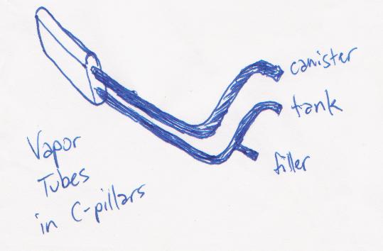

I did some quick research on the venting systems of EUROs and it sounds like the two pipes that are connected together on yours are supposed to be open to atmosphere through a hose or pipe that comes out somewhere behind the rear subframe. If they are connected together with a sealed hose, then there is no venting as you said. There should be a tee to an open hose under the car, or two open hoses- one for each side.
I made a drawing a while ago that shows the vapor tubes and how they connect for the US cars; on EUROs the one labeled canister should be open to atmosphere, with a hose allowing it to vent outside the car. Might be a good idea to put a filter on the vent hose to prevent debris from entering the tube.
