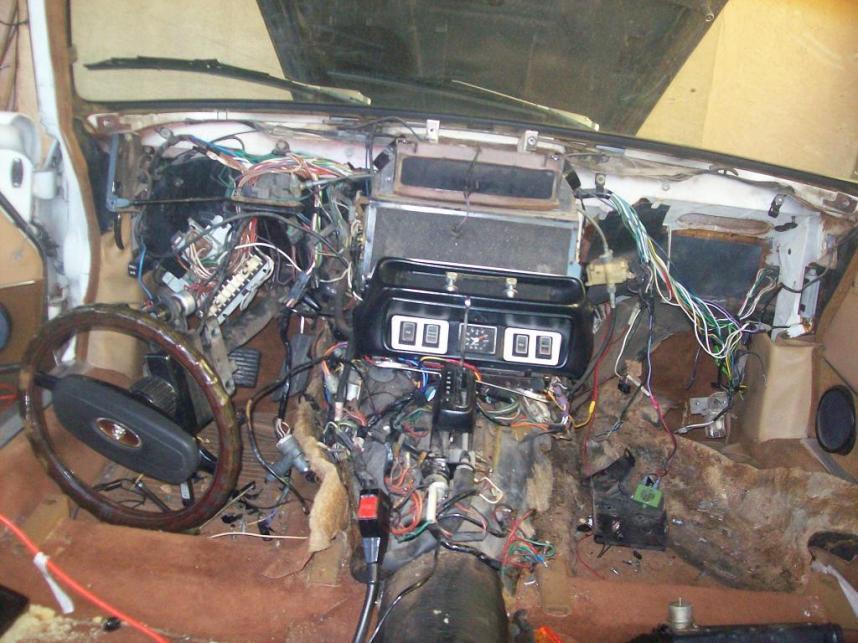

Actually, per Rich's post, I scuffed my feet for about an hour on my carpet. I then went to my car, plugged the positive battery terminal onto the index finger of my right hand, put the index finger of my left hand onto the coil terminal, and had a friend cross the starter solenoid with a screwdriver. The car fired up and purred like she never has!!![Icon Wheel](https://www.jaguarforums.com/forum/images/smilies/icon_wheel.gif)
Now all I have to figure out is how to stay like that while driving.![Icon Denk](https://www.jaguarforums.com/forum/images/smilies/icon_denk.gif)
I may have to hire someone to do it for me (stay like that...not drive...lol).![Icon Verzsilly](https://www.jaguarforums.com/forum/images/smilies/icon_verzsilly.gif)
Anyway, I'm mid process of ripping (almost literally) out my dash and center console to get at the wires. After removing the wires from the bolt on the bulkhead, cleaning them, and putting them back in place, I seem to have lost any electricity that may have once run to the cockpit.
I have electricity to a few of the relays in the engine compartment, but I lose it somewhere. So, I've still got to run all the wires (yes, each and every one) to figure out where each one goes, stops, combines with others, and ends up in relays, etc. No wonder mechanics get paid HUGE amounts for chasing electrical problems. SHEESH!!!

Motor, yes, electrical gremlins can be a bare to chase. Not like you can see the electricity flowing in the wiring (if you can, you have big, big problems). So, you have to put your full trust into the equipment and also be able to interpret what the instruments are telling you.
It is possible that you have a bad wire that is broken inside the insulation. Based on the age of the car, if you haven't replaced the wiring, it is very possible. Your best bet is to follow the wiring between the post and the firewall and go from there. Also, don't be afraid to use a little bit (key in on little) of dielectric grease. That will help minimize corrosion in the future and improve the conduction between the layers of terminals.
I wish I was there so I could put my hands on the car. IT would make this so much easier for me. But then, I bet you are pondering the $300 kit from Painless Wiring to simply rewire the whole car.

Anyway, tomorrow's the day!! I'm actually going to start taking out the dash, front seats, center console, and possibly the front fenders and hood (which I need to do anyway, since the last yahoo that had the hood, fenders, and front doors off didn't line 'em up right

"Your best bet is to follow the wiring between the post and the firewall and go from there."
Surely if you run a "new live" directly from the battery to this main post you can then quickly test for what is not working, with the key in the "ON" position.
I'm still thinking "Ignition switch", power going in, but no power coming out.

Motor, the harness that you use I think is of little importance in this case. You are in a unique situation. The big thing is knowing how you want the wiring set up. Personally, I would be going with the box that has the most relays in it possible. That way you can relay in the headlights (high and low beam), fog lights, even your running lights. That way your switches only have to control a very small current, which will help them survive for a longer time. Let me take a look at the Painless Wiring site and see if I can come up with a recommended harness. There will still be some fabricating on your part as the harness really is only for the battery to fuse box and out to the first terminal beyond that. But, there are a lot of systems (back up lights, stop lights, etc) that require more wiring that just that.

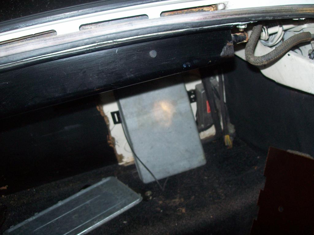

So, I took the center (centre for those in the UK...lol) console and the front seats out. I started chasing this group of about 25 or so wires from the engine compartment to the cockpit where it went under the carpet and into the trunk. I opened the trunk, and found what you see in the pictures. I removed the bar that went across it to hold it in place, and popped the back of it off, and it looks like a giant circuit board.
Can anyone tell me what this thing is, and if it could be the root of my evils? Is it a main control module of some sort? I found what could be it in my wiring diagrams, but it's not named in the description of the schematics.
The larger one is what I need to know. The smaller one says "EGR Control Unit," and I can't think that IT would be the cause of my headache.

Looks like the main ECU to me. Don't go poking it with your screw driver. Does it not have a part no on it anywhere?
I don't see this as the root of your problem, because when you hard wire the coil the car runs fine which I doubt it would do if this unit was fried. I stand to be corrected.
Can't see as to how your EGR module (exhaust gas recirculation) controller could give you a totaly dead car. It would cause rough running more likely.
Keep plugging away at the wiring. Sent you another diag via email.
Rich

Got the diag, but the XJ6 and XJ12 are completely different animals (I'm fast figuring out).
You're correct. That big thing IS the ECU. I've eliminated it (and will trace wires from it forward) and the EGR control unit as possible sources of my problem. I don't need the EGR since my car has a carbbed Chevy 350 in it, and will be looking further into whether I need the ECU at all or not. If not, both of those will come out and go up for sale on eBay...lol...since no one makes them.

Thats a point, the EGR will be redundant. The ECU can't be controlling the engine UNLESS it is a Chevy unit, although I do wonder if it will exert control over other systems.
Like you say trace forward.

#60
![Default](/forum/images/icons/icon1.gif)
I guess not. It came back on, and is still doing the same thing. So, I've eliminated a LOT of wiring that wasn't needed in the car, trunk, and under the bonnet.
Here's a picture of the interior of Christine so you all can have a good belly laugh (at my expense) on this very nice New Year's Day!!
