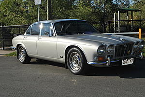

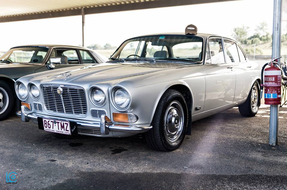

Originally Posted by o1xjr
o1xjr...............because if you search O1xjr you will find a lot of irrelevant crap.
But what a gorgeous silver ser 1 Jag you have!
Yep, I'm the first to admit it. Took a lot of work and here she is again.
Extra fuel filters-18181_440620662770150_8545751333014610722_n.jpgExtra fuel filters-dsc_7857.jpgExtra fuel filters-dsc_6087..jpg
