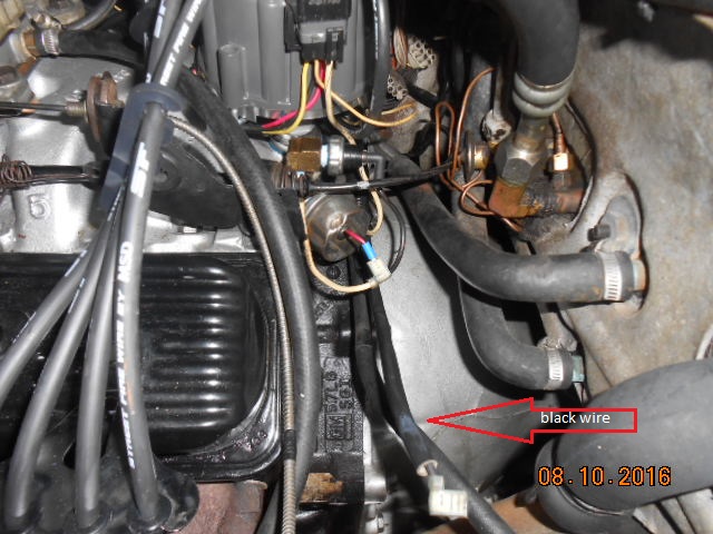

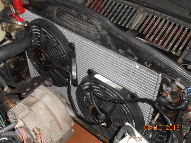

Questions to all:
RECAP: Mechanical- Using a JohnsCars kit
1993 Chevy Engine with older 4 barrel intake manifold installed.
GM TH350 transmission and external trans cooler installed.
New Radiator and 2 e-fans installed.
ELECTRICAL:
Using JohnsCars 6 wire harness from the passenger side of the car, I have the following connected.
Coolant Temperature Sending unit
12v to HEI Distributor
Alternator light and gauge
Oil pressure light.
I ran a separate single wire from the tach signal off the HEI distributor to the red wire at the back of the Jaguar tachometer with a 330 ohm resistor in series.
Coming off the 6 wire connector I have two wires that are not connected and I also have 2 components that are not connected through this harness.
1) Oil pressure gauge and 2) the tachometer to which I connected with a single wire as stated above.
The two wires I have that are not connected are one black and one white with a brown stripe.
Does anyone who have used the JohnsCars 6 wire harness tell me where the two wires connect to?
And, can I use the original Jaguar canister type oil sending unit for oil gauge operation?
Thank you for your input.

Hey Sanchez..
In my car I re used the Jaguar oil pressure sending unit on the GM engine. I look at it like this: the oil pressure sending unit and the dash gauge are a matched pair BUT you need an "adapter" because the Jag sending unit has some strange threads on it, that are not the same as the GM threads. I used a brass "T" so that I could have the GM oil pressure switch /"idiot" light and the oil pressure gauge sending unit,.. getting "pressure" readings from the back of the GM engine near the distributor. The "adapter" I purchased ($ 5.00) at a small company here in Seattle that stock all kinds of fittings. I used the Jaguar water temp sending unit on the GM engine and used a copper washer to stop any leaks (threads are a bit different as well., close but different)
The wire that is WSU (white/slate/blue) is the wire that is connected to coil NEG and sends a signal to the TACH. There should also be a wire in the Jaguar portion of this bundle that is used to engage the A/C compressor (Grn/Brown ?)
In my car I used the thick white wire from the inertia switch , to trigger the Main relay and then on to the coil to run the engine. The smaller white wire that was originally at the front inner fenderwell (right side) and used to be connected to coil - I reused for a heated O2 sensor. White circuit are all HOT in run/start. Pos 2and 3 on ign switch.
Hope this helps.
Hope this helps.

Alyn,
Nix is set up much like yours; an adapter threads into the back of the block, into which 2 diaphragm switches are threaded.
The yellow arrow in the picture below indicates the idiot light sender with a red/something wire (on my car anyway), the green arrow indicates the pressure diaphragm with the largish white/tracer wire which feeds the dash gauge.

here is how I did mine. In the second pic showing the oil gauge/light connections I have a single black wire that comes from the six wire harness. I don't know where it connects to.
So far, the following are connected and working.
Ignition, Tach, coolant, oil light and gauge. AC compressor.
The connector terminal on the oil gauge unit broke off so I just soldered a jumper on it to get it working.
I still have to install the cowl for my e-fans. Like Alyn I am going to use a sensor which I have on the thermostat housing to control the e-fans.
One picture shows how I keep the spark plug wires away from the exhaust manifold.
AC still not working. My helper (son) cross threaded the line from the compressor to the condenser. Waiting on David at Everyday XJ to return next week to get a condenser and hose.

My Johnscars kit had a big brass adapter. Three points. One to the GM engine where the GM idiot sensor was. Center rear. One to the Jaguar
Guage sensor. the other to the jaguar idiot light sensor.
At one time, and I'm fuzzy, a very small male coupler/adapter was included. When I was messing with it, it just busted. I had a Sun Pro
sensor, a biggish diaphragm unit. It can double for the Jaguar unit just dandy.
Wow, I dodged one. Could've busted on the road. Simplified the "Christmas tree" aka "plumber's nightmare". Much better.
Carl
Carl

agree, i have seen those brass tubes break off, from vibration or poor installation!
i have run a small hi pressure,oil proof flexible hose, with steel ends, up to where easy to get at and sometimes a small aluminum manifold with more than needed outlets.
