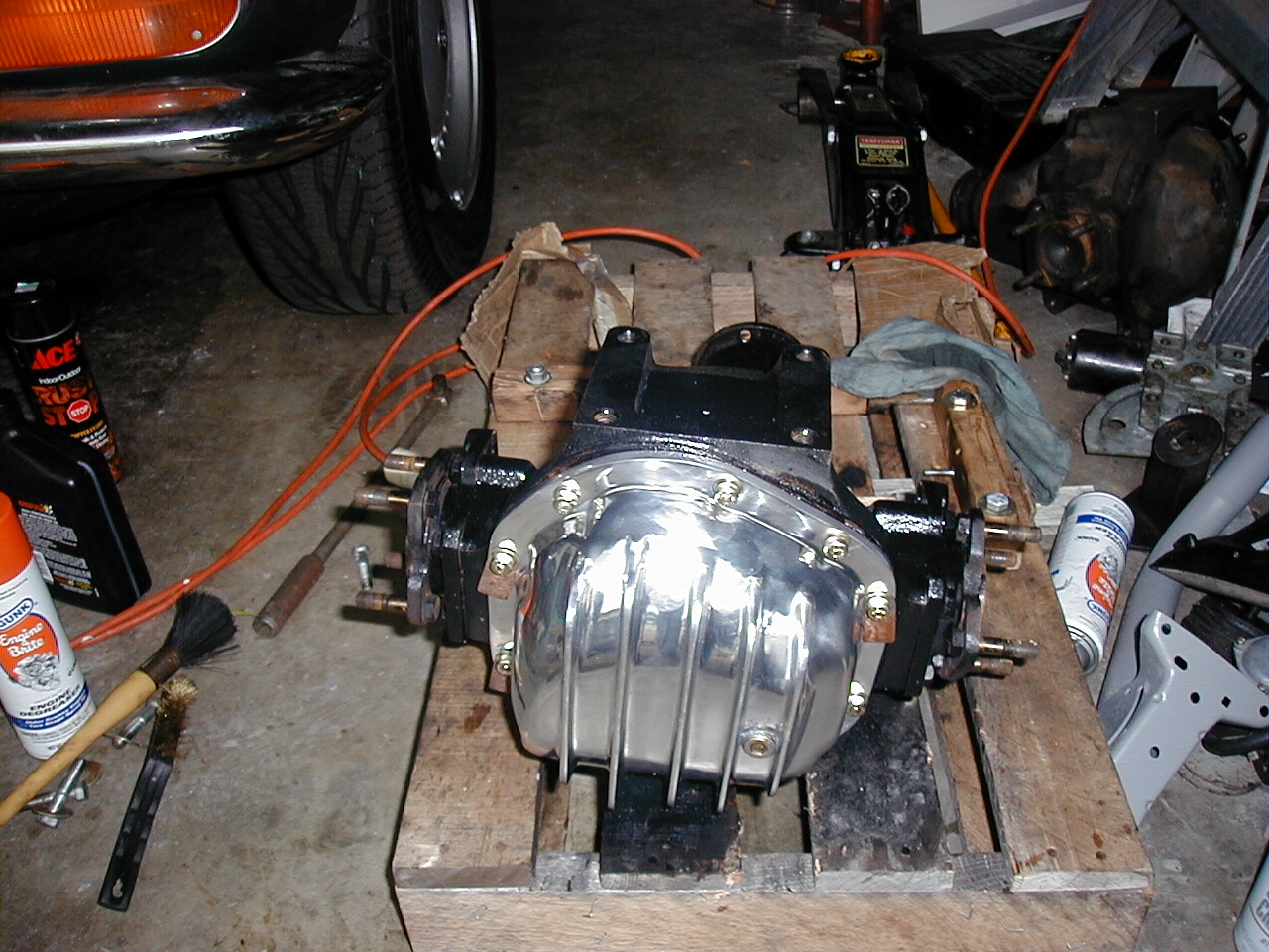

In the process of rebuilding a late model XJS irs( Salisbury w/inboard brakes/abs/GKN Power Lok/2:88 gears all verified) to replace the existing unit under my series 1 xj6 Looking to replace all the seals/bearings in the suspension and diff. Gearing will stay the same and the Power Lok freshened up/rebuilt. Poly bushings used where applicable. Will be doing the vented rotors upgrade. Plan on tieing the irs cradle to the unibody. This going behind a turbo'd LS1/t56(1st gear is 2:66).
I've done some searching, but can't find any specifics. What I'm wondering is what practical upgrades can I do to help durability/reliability? What vendor would you recommend for price/availability of parts? What vendor/parts would you stay away from due to personal experience? Does a yoke exist for the Salisbury that takes 1330 universal joint? Are the GKN PowerLoks durable enough to around 500rwhp? Is there a heavy duty/race clutch pack or rebuild kit for them. I know the output shafts from the diff twist if launched w/sticky wide tires.
Are there some bearings/oil seals that have a better reputation than others? Is bracing the LCA's worth it? I know about the hubs having issues and will inspect them for damage. Any advice that the forum has is welcomed.

I'm pushing about 450 HP through one of these upgraded Dana 44 based units. Get a fined alu diff cover to keep it cool and up to 600 HP wont be an issue. The later Diff's have a finned alu cover so you may already have one. You're not gonna get enough traction to blow up the diff with out some major wheel well cutting to fit some sticky and wide tires in any case.

The rear dif is freshened up along with new bearings and bushing for the suspension. Had the cage and lca's powder coated. Still have to order shocks and install springs, but I'm getting there slowly but surely.
