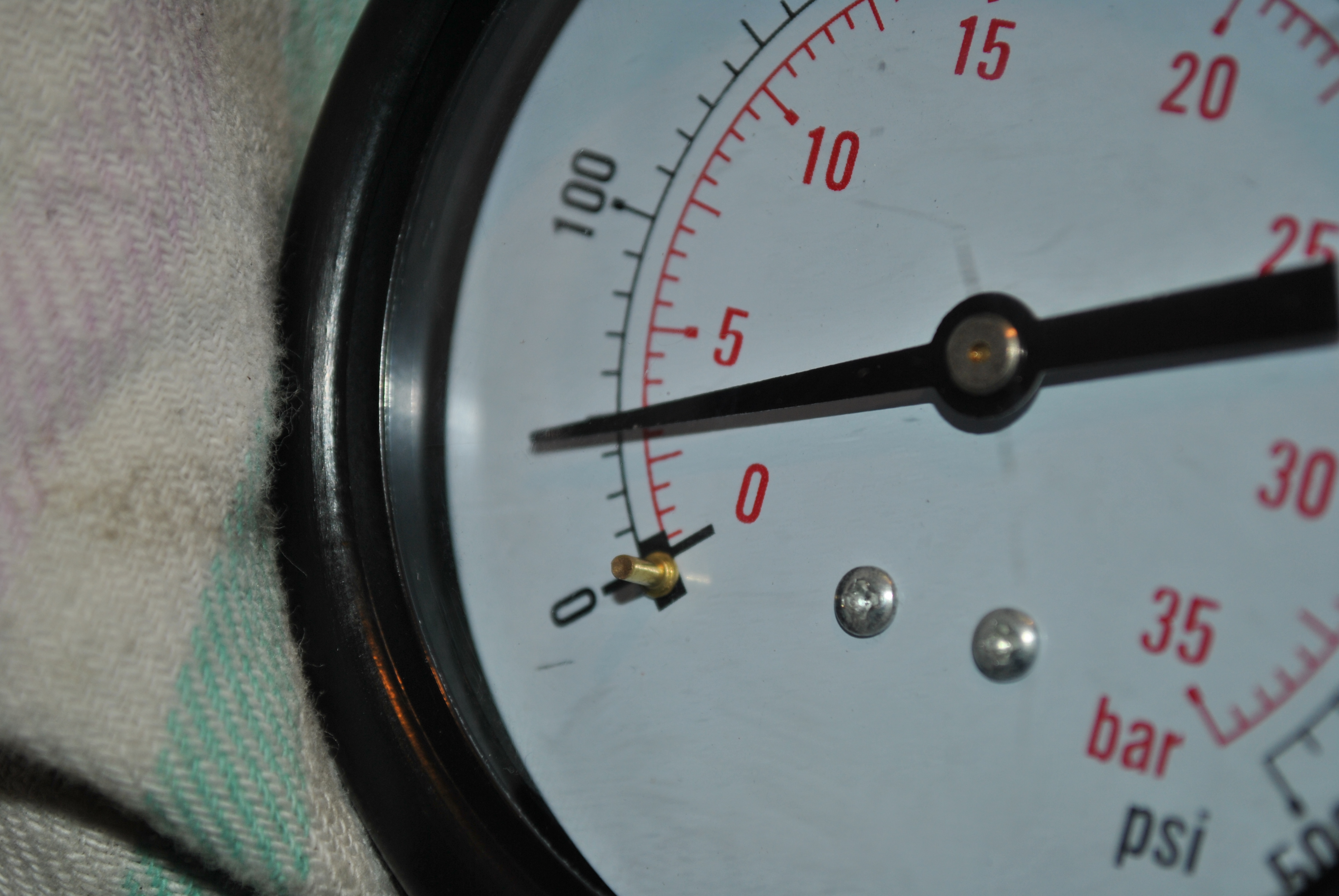

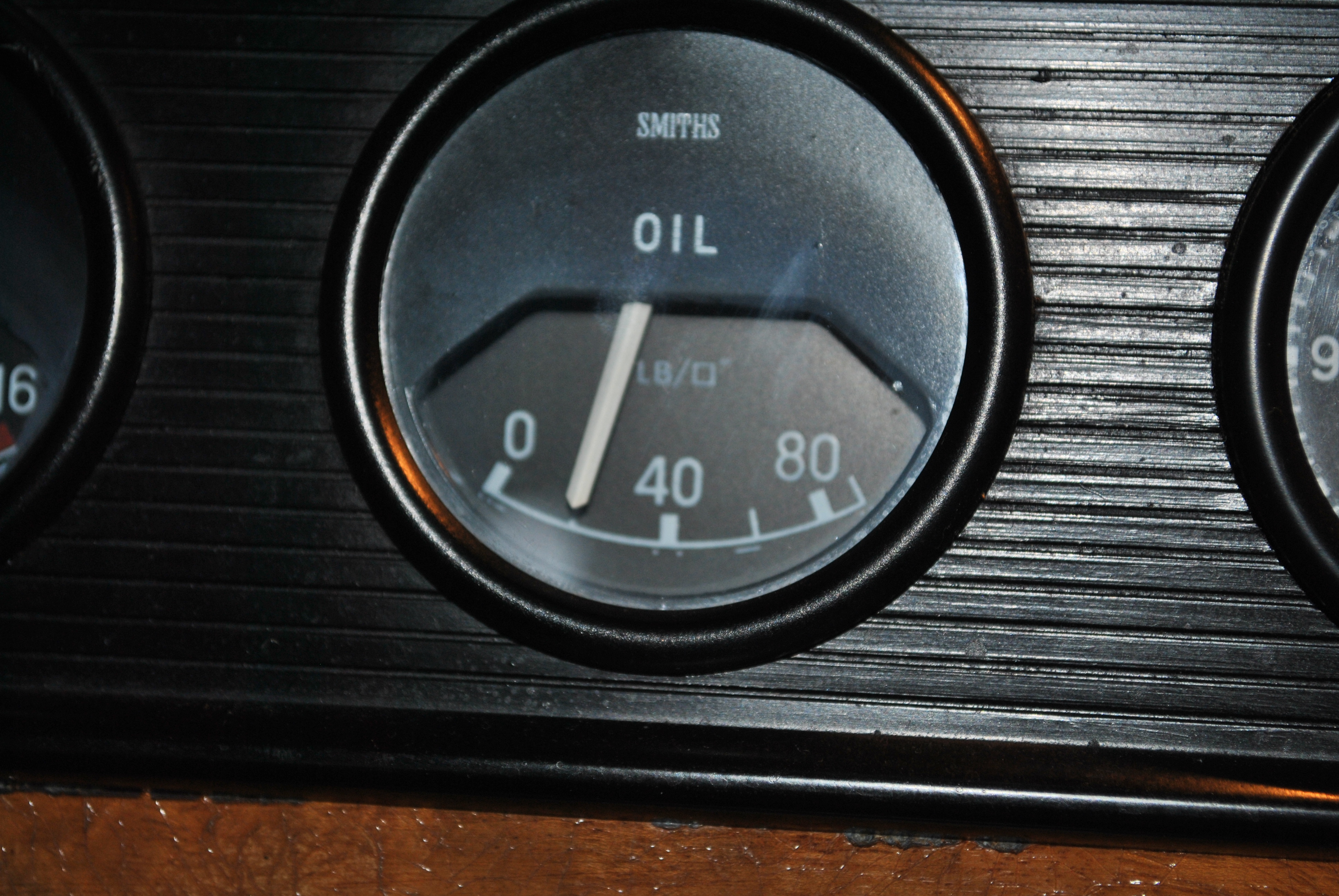

Oil pressure looks low for 80 mph Clarke ?

Dodgy sender, it was running 50 psi with a mechanical gauge fitted for testing.
Reads over 60 psi now, new sender was part of the rebuild.
