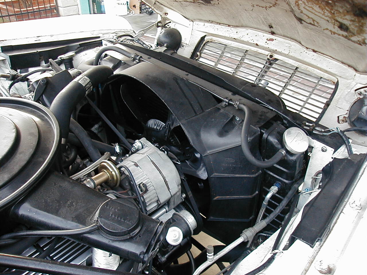

Too bad you are not in CA - my 383/700R is for sale
Remember, it is still here, 15K on the engine and trans but the car is
rusting away. Was my first Jaguar! could be driven from CA to your place...
Has great oil pressure and carb just rebuilt. Mild custom engine done by local shop with "nice" idle and uses 87 octane.
Putting in the LT1 is not just a slam dunk. Your car would need return lines - I put in SII tanks and new lines to the front with a electric inline pump and (6)
way valve in the trunk. Needs different radiator as water flows different direction and on and on...
You can get the pan off by loosening the motor mounts and trans mount and
jacking it up enough. But, it sounds like you will not like what you see in there.
I bought the same type of problems with the '74, was supposed to be 350 and was 305 that soon broke the crank spout off due to the rust! That is why there is a 383 in there now!!!!
