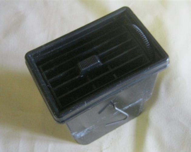

the two side dash vents have something like "Z" shaped clips and are very difficult to remove, you have to get at the clips from behind, and even that is difficult. I ended pulling the vent until the clip bent.

The Z-springs are indeed tough to work with; putting them BACK is a special chore.... and with 40-year old plastic vents, nerve-fretting....

I just pushed the vent back without the z clip, doesn't move, the rubber air ducting holds it in place.

if you can pull the vents out by sheer force, then forget about the z clip when reinstalling them;
I covered the perimeter behind the outside edge of the vents with enough black duct tape (Gorilla tape), so that they would go in the square opening tightly, while at the same time pushing the rubber air duct from behind into the vent. They haven't moved in years.
