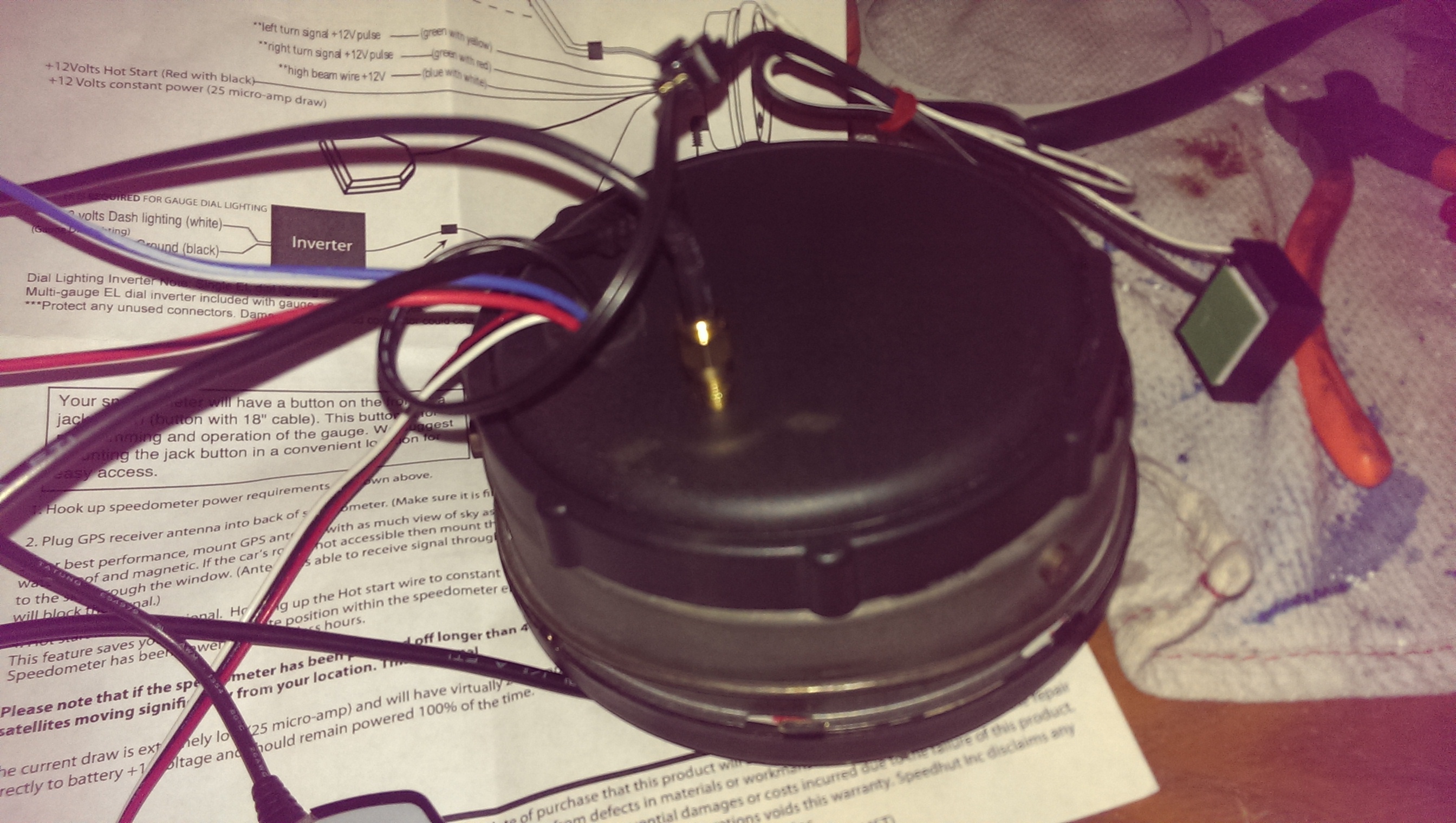

Here are the photos of the Speedhut GPS speedo installed in a spare Jag tach case. Could use a speedo case but I had more tach cases lying around!
I put the antenna under the speaker grill on top of my dash pad.. works perfectly. Has not only a Odometer, but Altimeter, clock, timer for 60 foot race and another for 1/4 mile.
They give you the choice of dial face coloring and pointer color plus the lighting color when the headlights are used.
This is the easiest way to get a accurate speedo and odometer with a trans change and rear end gear change and retain the original speedo size.

@Roger Very similar in features to the set i went with. Instead of a gps antenna i just plug in a hall effect sensor into the trans where the mechanical cable used to go. It can be recalibrated if you make any gearing changes. ( push a button and drive a mile, push button again ) The sets come with your choice of led color and bezel color and can tie into dimmer functions. Also has a timer for a quick race ( not that i would ever need that right :P) The kicker for me that made me go with this set instead of a gps solution is that i need a VSS to install an aftermarket cruise control system. And I am very tempted to do that, Actually im surprised i didn't put that on my to do list.
