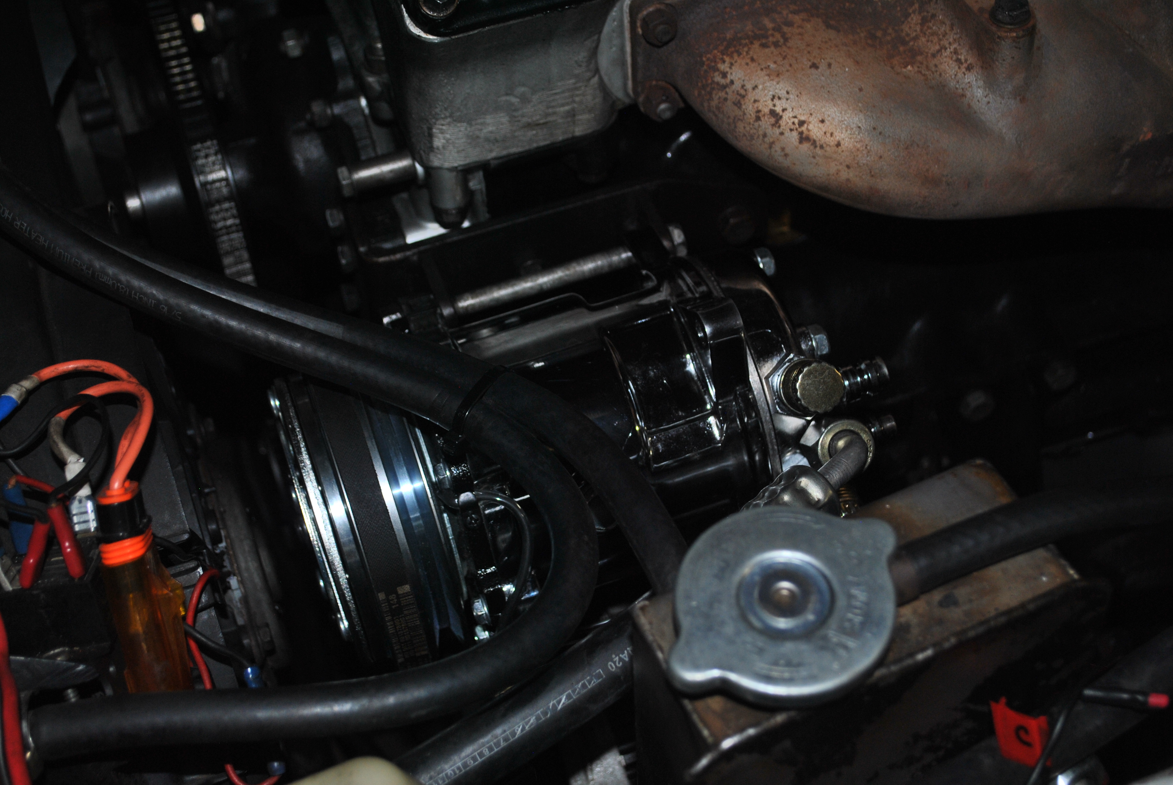

I fitted the new Sanden "style" compressor today then headed off to see Dr Phill to have it re gassed.
Only problem we had was the ports were too close together for the standard connections from the gauges to fit, but a bit of lateral thinking from Phill had it sorted in no time.
Series 1 Air con. Where to start. Or is best left to a professional? HOW TO-dsc_8826.jpgSeries 1 Air con. Where to start. Or is best left to a professional? HOW TO-dsc_8828.jpgSeries 1 Air con. Where to start. Or is best left to a professional? HOW TO-dsc_8829.jpgSeries 1 Air con. Where to start. Or is best left to a professional? HOW TO-dsc_8832.jpgSeries 1 Air con. Where to start. Or is best left to a professional? HOW TO-dsc_8833.jpgSeries 1 Air con. Where to start. Or is best left to a professional? HOW TO-dsc_8841.jpg

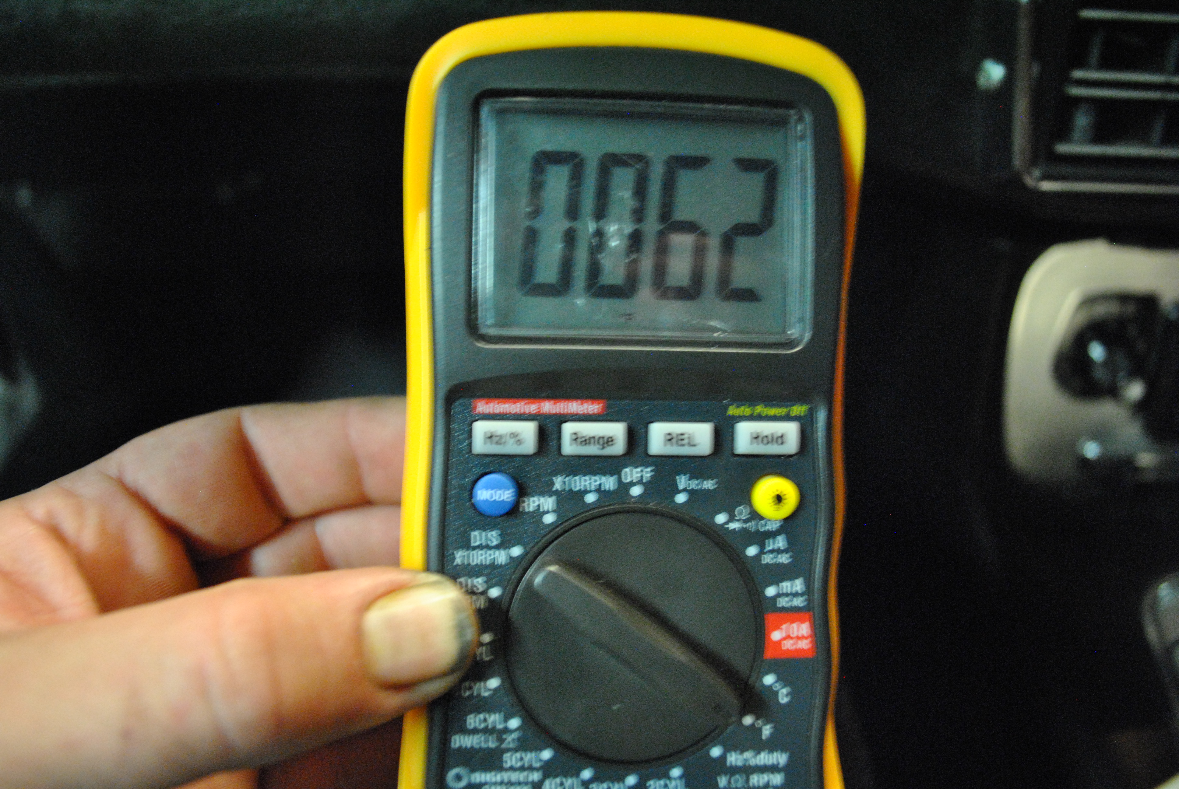

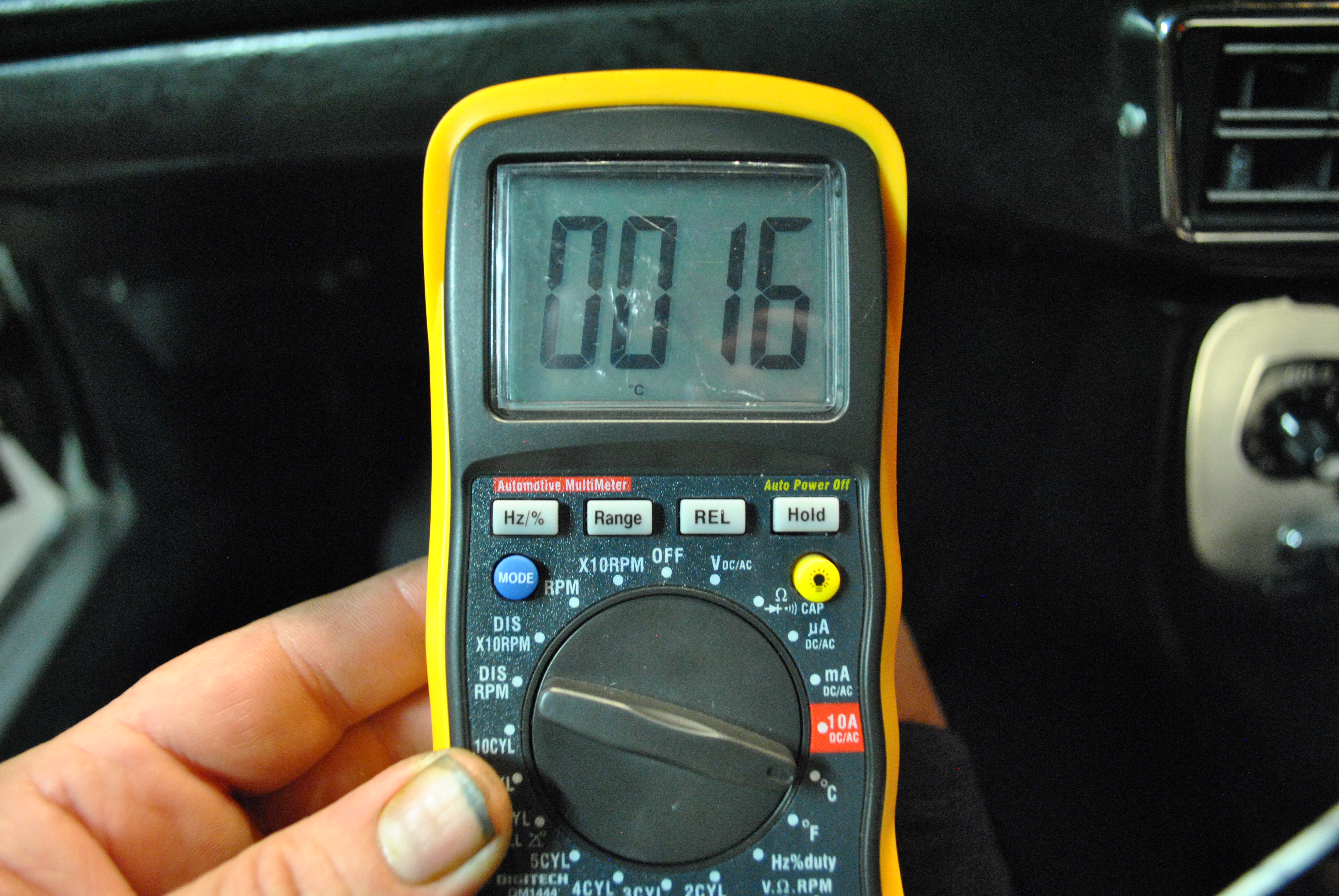

The cabin temperature range is from 16c (62f) - 24c (76f), got to be happy with that when it was 34c (93f) today.
Series 1 Air con. Where to start. Or is best left to a professional? HOW TO-dsc_8835.jpgSeries 1 Air con. Where to start. Or is best left to a professional? HOW TO-dsc_8836.jpgSeries 1 Air con. Where to start. Or is best left to a professional? HOW TO-dsc_8837.jpgSeries 1 Air con. Where to start. Or is best left to a professional? HOW TO-dsc_8838.jpg

My S1 with a Sanden compressor shows 40F side vent temps when the ambient is 90F.. the new add on center vents are even colder.
Mine is filled with R134 and works GREAT!

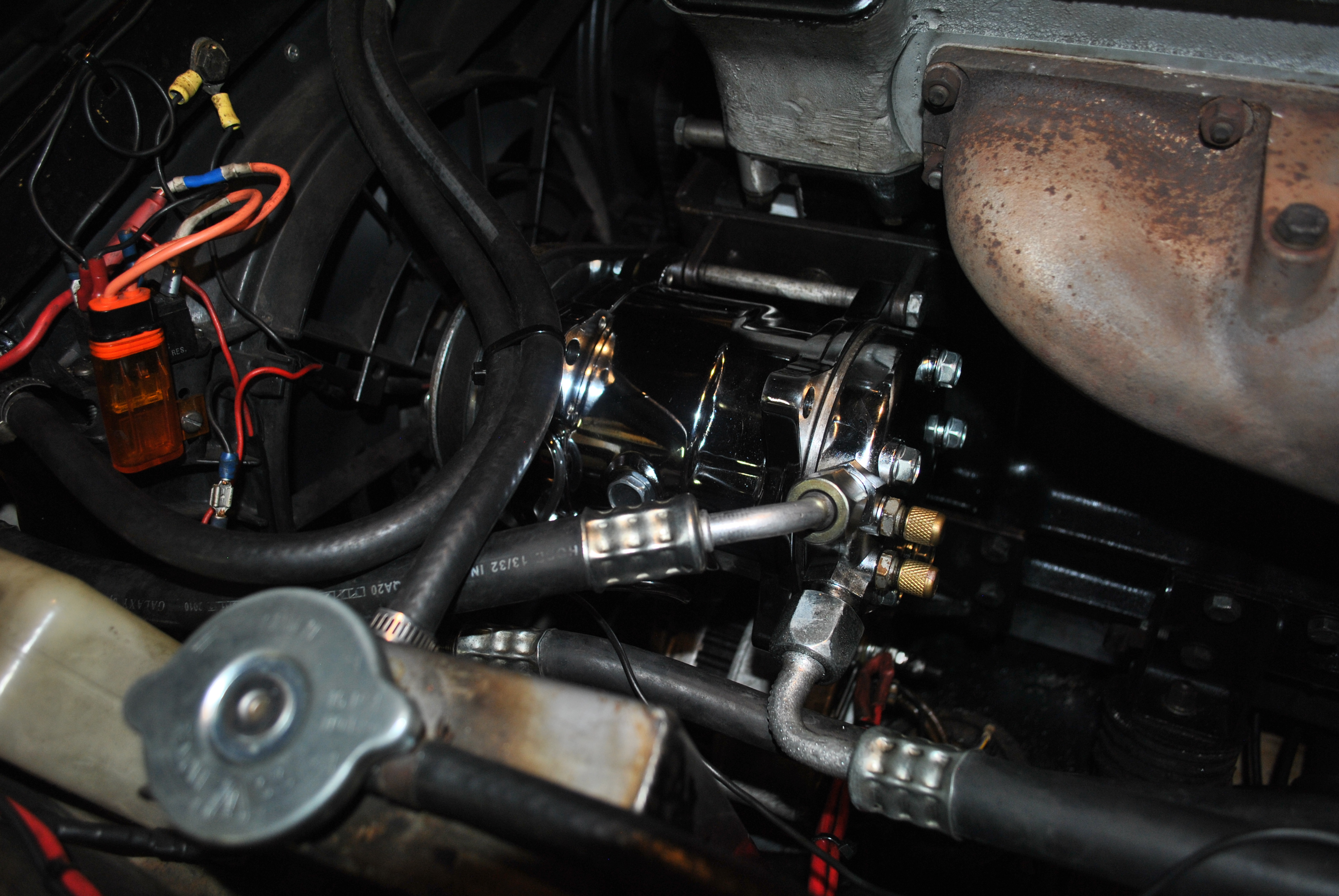

Two days in and it's coming out again tomorrow, got a small leak at the front of the compressor. Small bubbles and an oil dribble at the front o-ring seal. Vacced down ok and showed no sign of leaks.
Will go a replacement this time around but will go for the refund if number two fails.

Ideas from a decidedly non/expert.
1. A bit of oil ooze is intentional so as to keep the seal cool and flexible?
I noted that in a past Ford unit. It even had a bit of a wick showing. It cooled like the Antartica.
2. My Jeep used to leak a bit, so as to require a can of R134A each season. A tag on it indicated a sealer had been added in the past.
I used a can with refrigerant and added sealer. Two seasons, cooool.
We will see about this year.
Odd that it could hold a vacumn yet ooze under pressure?
Add a bit of sealer???
Carl

Yes odd that it didn't leak on the vacuum pump. We are thinking once it got hot after a day or two of use it developed a leak.
Touch more than an ooze, about two tiny bubbles per second once there was oil pooled there. After ten minutes the oil was just starting to run downhill.

Mine kept losing the charge and AC guy found a pretty big bubble in the metal under the O ring at the rear.. filed it all flat and now it seals fine.
He found it with the leak tester.. it beeped like crazy after putting in some more coolant.. there was some oil around the area.
There must be another reason your vent temps are so high or it is just the coolant you are using that is the difference....
Have you upgraded the stock condenser to a modern flowing one? Blocked all the air flow around the radiator edges with AC foam?
The difference between 40F and 62F is huge in the comfort level of the people inside the car. It gets to 111F here in the So Cal summers.. I need the additional cooling with a BRG car and black interior.

Are you measuring in the vent? 40f or 4.4c is a tad too cold for my liking even on a 40c+(104f) day. My measurements were taken mid cabin on a 34c(93f) day. I didn't assume people measure from the vent, I thought room temp measurement would be normal.
16c(61f) is more than comfortable even on a hot day.

Ive had two compressors done in the last year and both places measured at the vent. I think its just to get some consistency and take the ambient air temp more out of the equation (eg. Melbourne in winter). If you can pull those down, everything else is adjustable to get the cabin temp you feel happy with.
paulyling (12-04-2016)

Every AC system I've ever has worked on (different cars, different techs) measured output temp at the vent.

The S2 cars were always 3 to 4c at the vent.
The XJ-S was 3c constant.
The Black S is 2c.
If you have what you have, all good in my opinion.

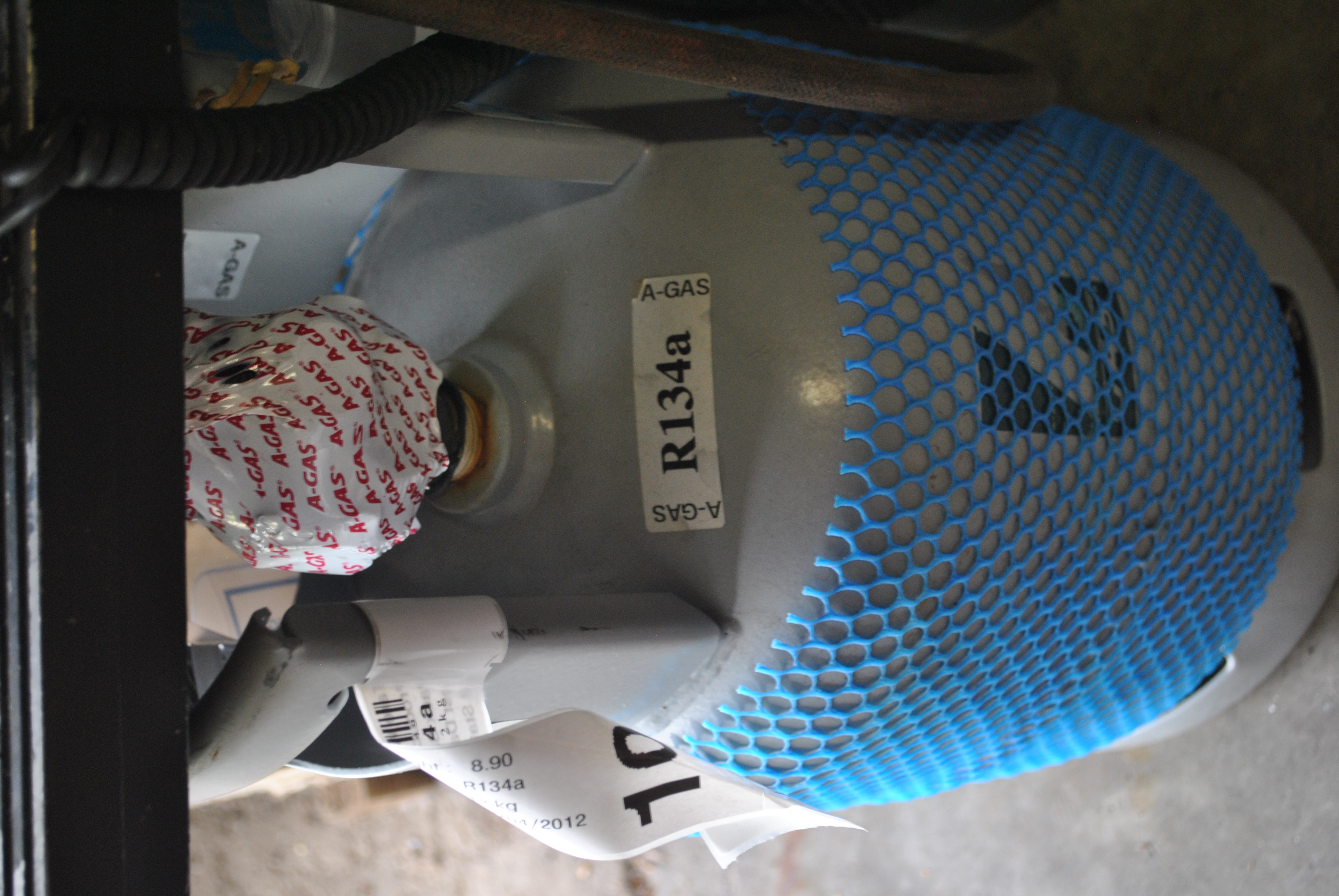

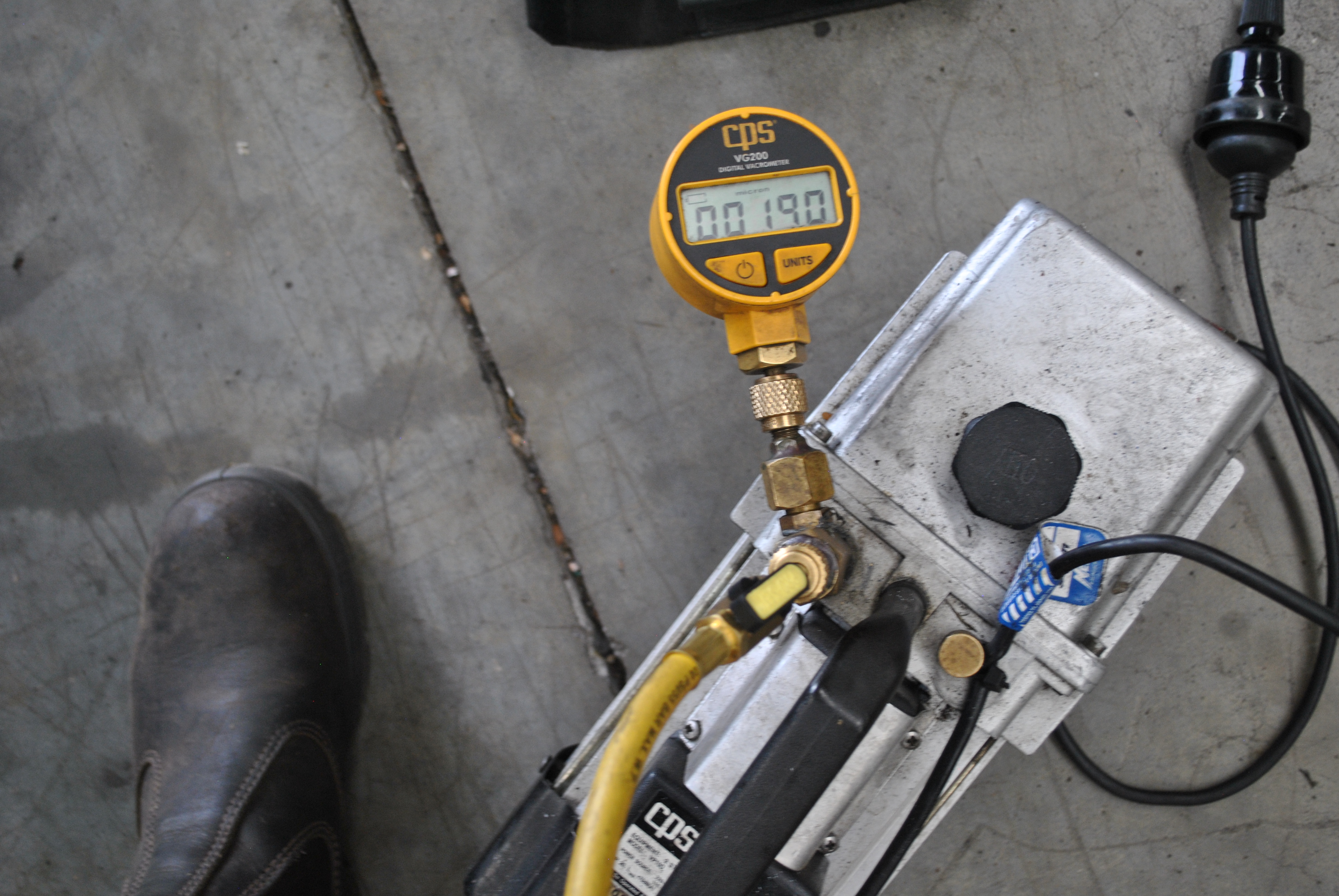

Compressor #2 in and on vacuum pump, all good so far.
Going back to the R134a gas instead of Hichill
Series 1 Air con. Where to start. Or is best left to a professional? HOW TO-dsc_8907.jpgSeries 1 Air con. Where to start. Or is best left to a professional? HOW TO-dsc_8908.jpgSeries 1 Air con. Where to start. Or is best left to a professional? HOW TO-dsc_8910.jpg

Dr Phill has a constant supply on hand. Re gassed with Hichill twice at cost.
Saving some pennys.
All seems to working as it should so far.
