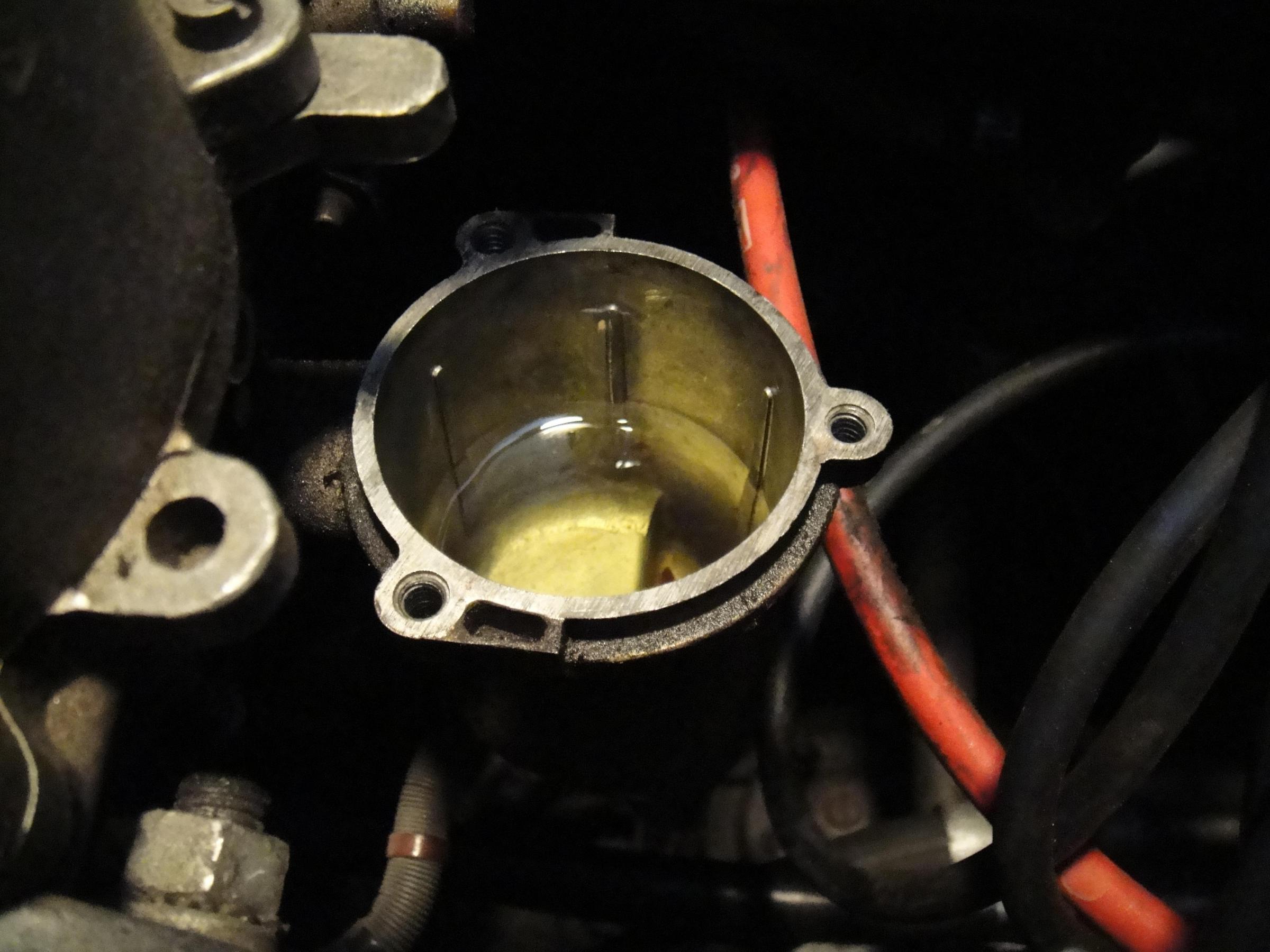

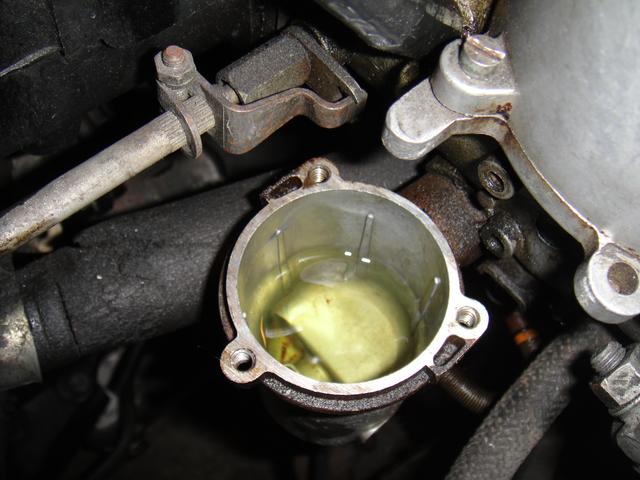

98 octane fuel isn't the problem....unless, perhaps, it has gone stale after a year in the repair shop.
The new fuel pumps should be able to supply the engine beyond 4000 rpm.
When replacing the fuel filters have you emptied the contents into a clean jar for inspection? If so, how did things look?
Assuming you have SU carbs are the dashpots full and the floats properly set?

Here is a few photos, both fuel bowls are about 1/2 full of petrol. is this normal? also i did notice there was 2 screws which adjust a lever which goes down to under the carb. one of the screws on the carb is about 5mm different from the other carby. not sure what there for or what one is where it is ment to be. but the lever the screws push down one side is down 5mm or so more than the other.
Also when cleaning the spark plugs today the rear 3 were fowled up with a bit of black gunk but the front 3 weren't and had more of a white fowling. which must have something to do with that screw being 5mm out. maybe?

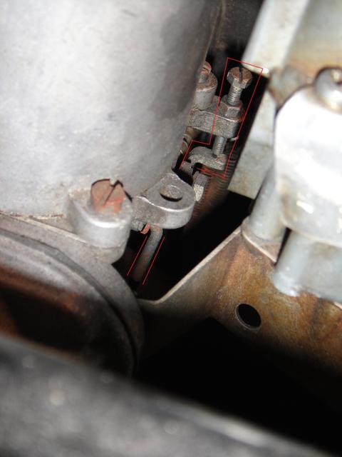

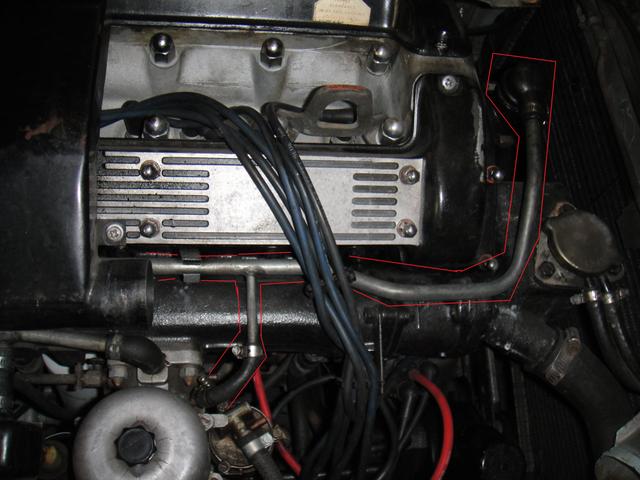

Also what is this for? it has 2 lines coming from the carbs to the engine. no idea what it is but that black rubber bit on the engine is all old and has ripped underneath and isn't sealed any more

That picture of the lead going from the front of the engine is the crankcase ventilation. Air gets sucked from there by inlet vacuum and some gases from the crankcase gets burnt once more. It´s a good thing to make sure that rubber bellow is not leaking. There is a metal gauze in there as well that can become clogged.
![Default](/forum/images/icons/icon1.gif)
The "black bit" at the front of the engine is the crankcase breather and if the rubber is broken, it is providing an alternative path for air to get into the engine instead of via the carburettors. What this means is that the engine will run weak, as the carburettors are not supplying all the air consumed. So you need to get a new rubber connector. However, if you clean up with cellulose thinners or similar, then tape it up temporarily, you should see a difference. The two highlighted screws look like the individual throttle butterfly adjusters. These are used to set each carburettor up individually. This is commonly done using a rubber tube, one end in your ear, the other at the carburettor throat. with the cross shaft loosened off, adjust carb until both carbs have the same hiss pitch. More precise way is to use a manometer tube, but you'll probably struggle to find one nowadays as everything is EFI. Once each carb hisses identically, the the cross shaft is locked and tick-over adjusted on a single screw.

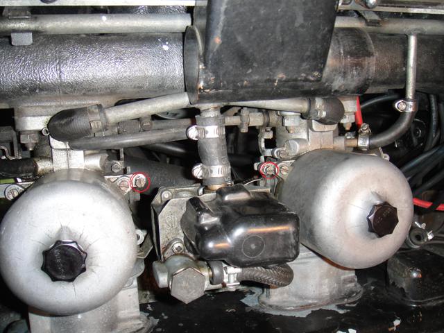

Hi The problem could be the AED unit (Automatic Enrichment Device) which is the part between the carbs; It relies on hot air from the exhaust manifold through the hot air duct across the top of the engine to close of when engine gets to temp. I notice in the last photo the tubing is missing from the hot air duct to the air filter housing. Personally I would do away with the AED unit and fit a manual choke' even from new those AED units gave trouble staying on and running to rich causing raw fuel to wash the engine bores and ending up with fuel in the oil sump (not good )

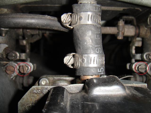

i did have the air filter and that hose from the exhaust off when i took those photos but any chance you can explain or through up some photos on how to get rid of this setup?
I wasn't sure i eve had a choke? it has 3 carbs 1 little one in the middle which the owner told me is the starting carb ( i assumed it was the choke?)
Unfortunately no. It's only got two. And as rays mentioned the black box/unit in between is the AED. It is basically a more old fashioned version of an automatic choke. To remove it I recall there being the vacuum lines connected to the carburetors (the short hose you have photographed) which need to be plugged. The vacuum hose on the AED unit and I remember there being a hose attached to the overflows from the carburetors. Then just in bolt it from the pegs that fit it to the carbs.
The screws you have been turning are indeed mixture enrichment screws. To set them evenly take the carb domes off and remove the springs and pistons. Don't mix them up!
Turn the screws so that the jet is flush with the level of carburetor body. Repeat for both carbs and re install the pistons, springs and domes - I am talking about the outer shell I'm not sure of its name.
Now, the idle adjustment screws (closer to the motor behind the enrichment screws), wind them both out so that the are no longer in contact with the adjuster plate. Then screw each side down to the point of contact THEN one full turn each only.
Hopefully the AED will start the car.
Once the motors at normal temp turn both like adjustment screws in even proportion until normal revs are achieved. (My car is usually 750-800rpm). Now turn both enrichment screws equally and slowly until you notice the revs start to fall. Back the screws off a little and the carbs should be set.
Hopefully someone can correct me if I'm wrong??
Cheers all and happy new year
Nos_Monkeys (01-01-2014)
I forgot to mention to check the position of the throttle plates. Although it shouldn't seem an issue if the engine has been smooth previously? I've had this issue with my Daimler although it has a manual choke, I'm scratching my head to remember what I did to fix it or if the poltergeist that infested all it's other problems was the cause.
