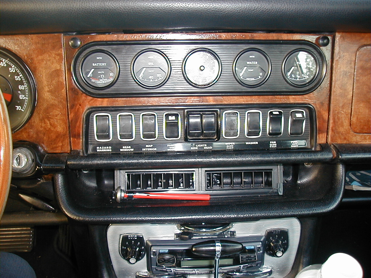

Yes, my heating and AC has been heavily modified to work better. Behind the radio is a herd of stock vacuum lines and heater controls that are not findable today... plastic nipples on the devices that break and can be fixed or updated.
I have added two more vents for AC/heat in the parcel tray... their source comes from the center "port" off the bottom of the evaporator behind the radio and the RH tube that feeds the RH rear passenger vents inside the center console. If you get around to it, contact me for specific items but the photo show the dual vent system in the parcel tray.
Heater has a Vintage Air electronic servo controlled water valve that replaces the Jag unit.. it looks stock inside the car and uses the original Jag heater knob. Note that I have a larger modern DIN sized radio...
