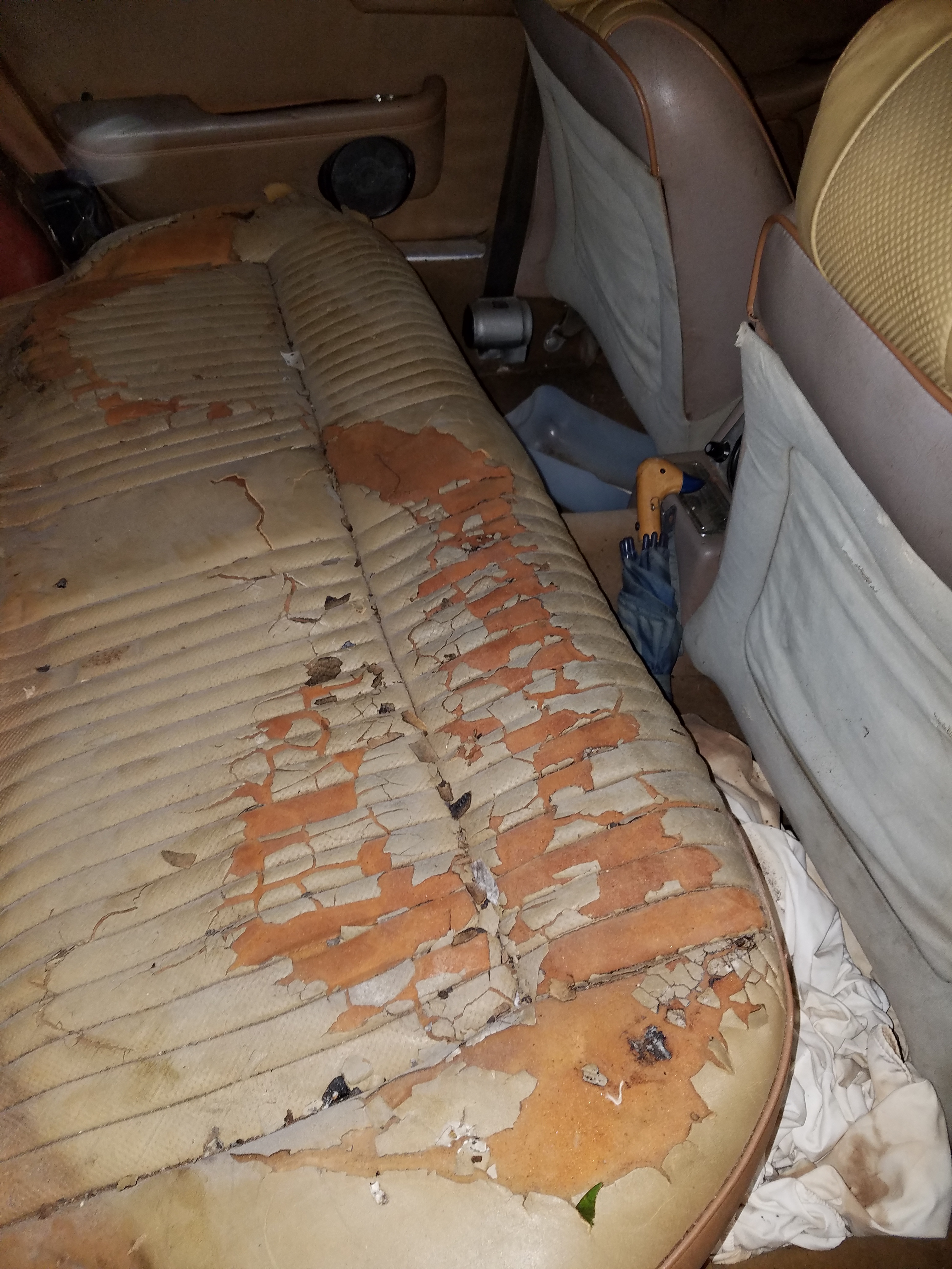

So lots being done and Im learning a lot as we progress and I read. On a bright note the seats in the car were shot and I have been dreading on buying a leather kit and trying to repair the seats. Luckily the shop owner has old seats from his parents car that he has had bagged up in his shop. Same color stitching etc. Basically bolt in replacements and im getting a steal for them, so I feel very fortunate and it was meant to be. Attached are some pics of the before and after seats and the car as she sits now.
