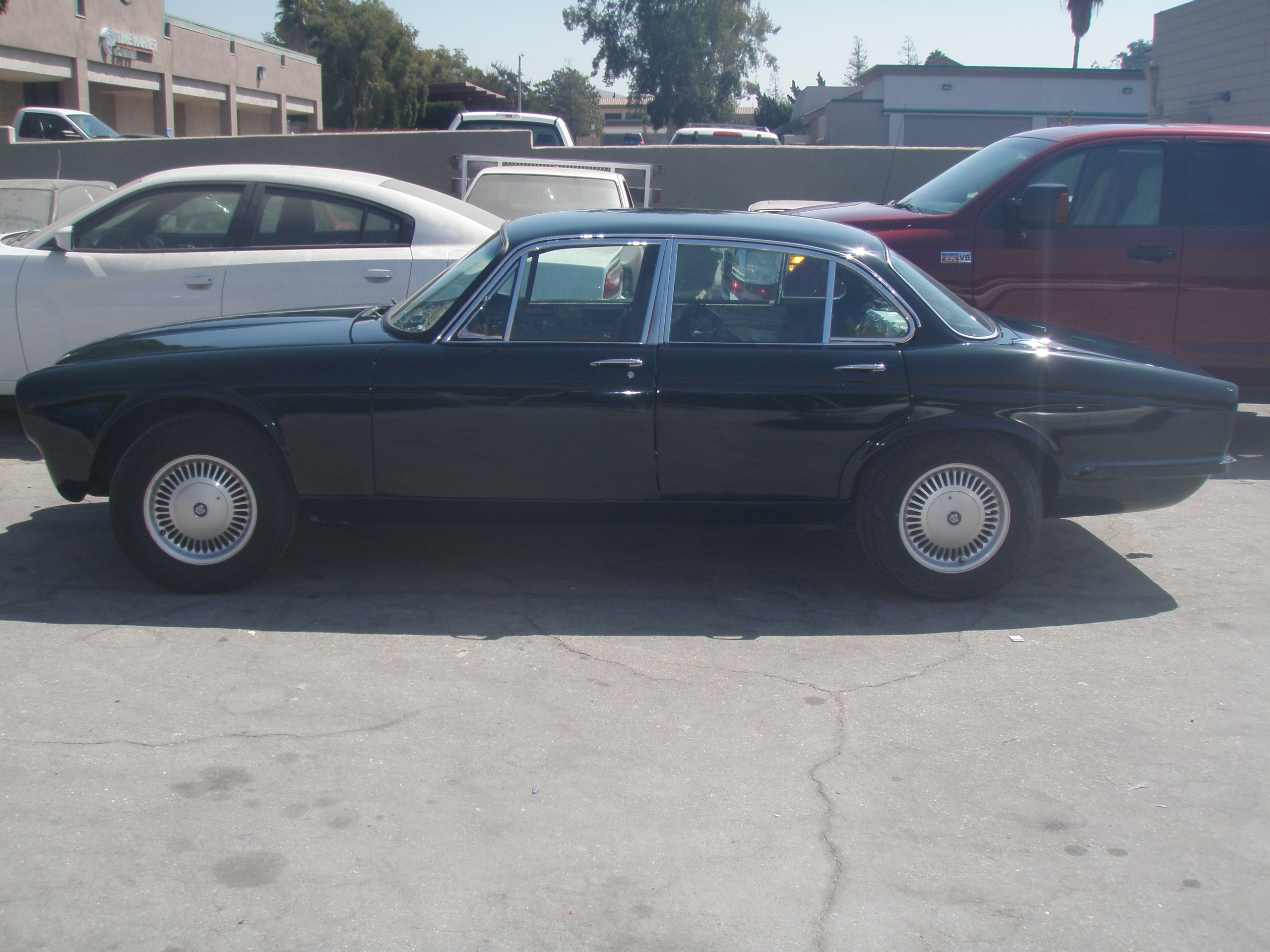

Jose is correct, the XJ40 wheels are one inch wider (why I do not have traction problems) and do not fit as a spare... so like Lnrb, I just used stock sized wheel and tire as a spare.
I did investigate a "donut spare" but decided against them... had the stock tire already. But did use the space saver donut ring on top of the spare to hold needed stuff.

nice, with a cupholder built-in !!

Cup actually holds the original lug nuts needed for the stock wheel... XJ40 are very different.

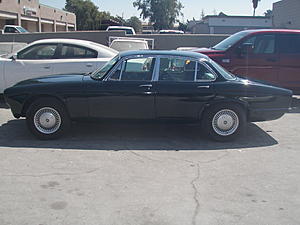

Yes, just not chrome ones...just out of the paint shop and heading home for the rest of her stuff.

the ones in your picture are the Metric Teardrops that came after the XJ40 Teardrops.
Elinor's are XJ40 Teardrops. Mine too, painted but with chromed hubcaps.
