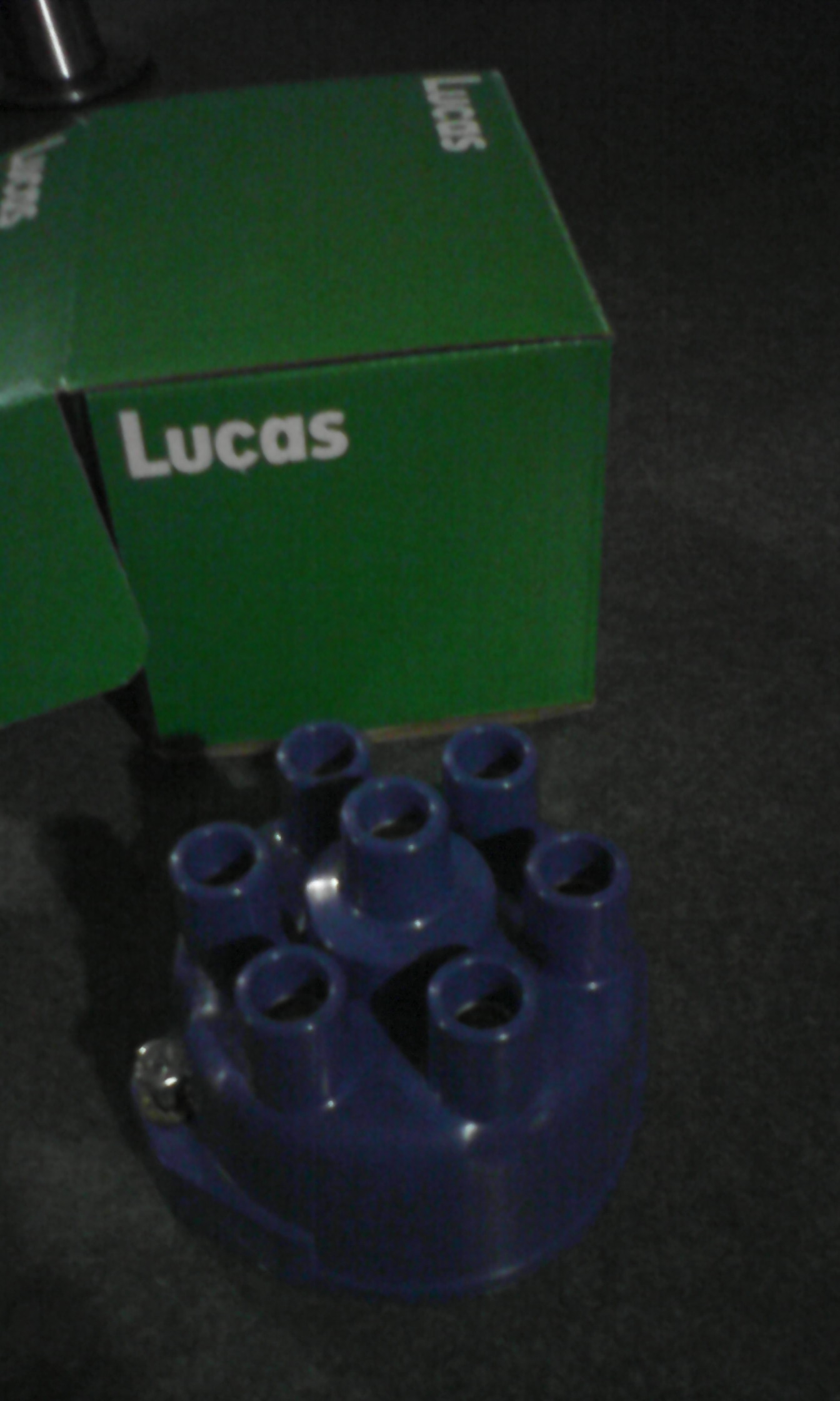

Still got issues, after a chat with Grant last week we stripped and cleaned the carby's, but she still wants to stall sometimes when stopping.
Turn the key and it fires up again like nothing is wrong, runs perfect under load. No missfire etc.
Next step, replace the dizzy cap as the one on it has a little bit of plastic broken away where on of the leads plugs in.

New dizzy cap on and tested, not stalling when coming to a stop now. But still a little cough and splutter or miss fire when first accelerating but no signs of it under load.
I leaned out the carbies a bit to see if it was over fueling at idle but couldn't really pick any difference. But it is not doing it every time I stop, if I stop for a short period(say a red light) it takes off just fine. Only doing it when coming to a near stop or short stop of a few seconds.

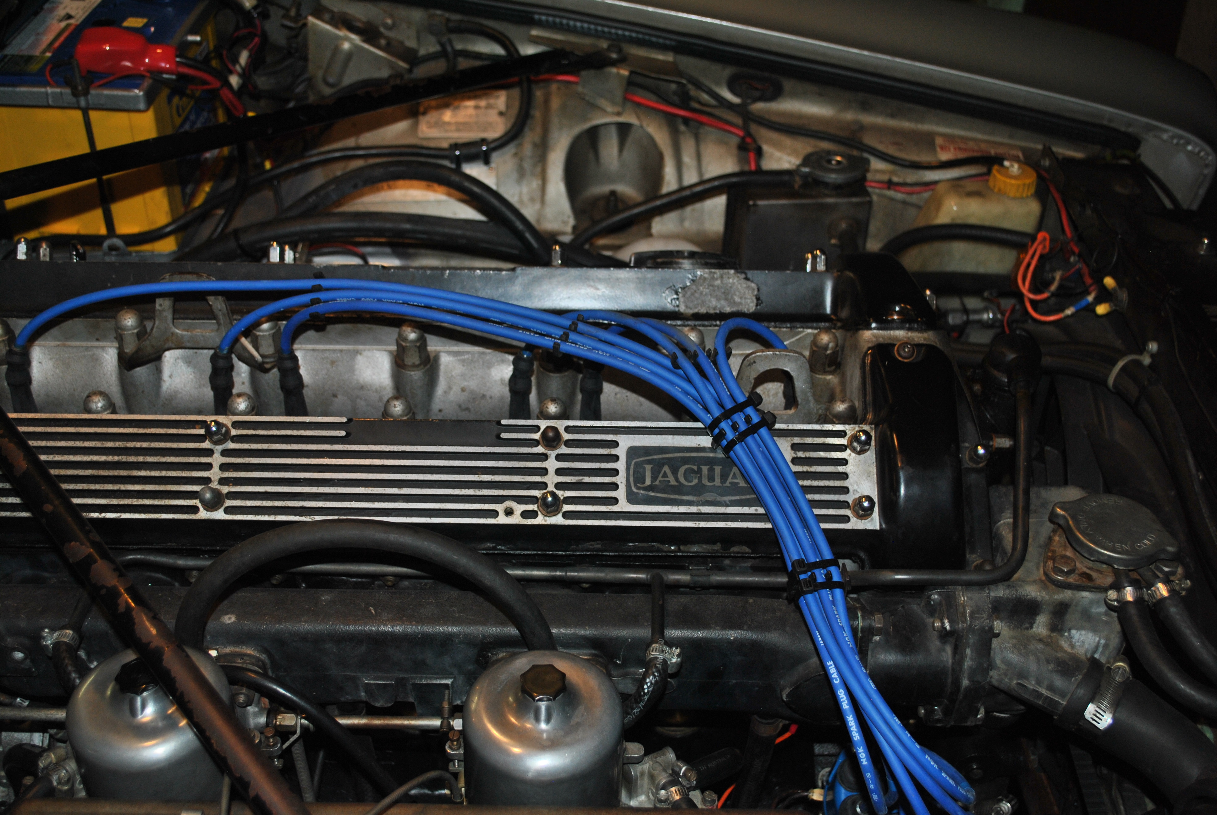

I went to see Dr Phill today for a Saturday arvo amber happy juice, he had bought Fireball a present.
One more thing eliminated.

Couldn't let that bargain go by. $108 lead set down to $45 because the box was torn. Bargain in my eyes.
