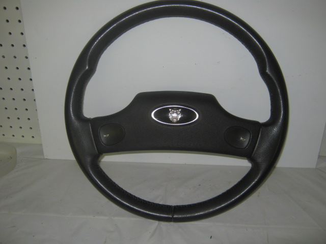

The XJS wheel mentioned was probably the 89 Sport wheel. It was only offered for a brief period on the XJS, and also for a short period on the non US late Series 3 XJ12 (or V12 Vanden Plas)....

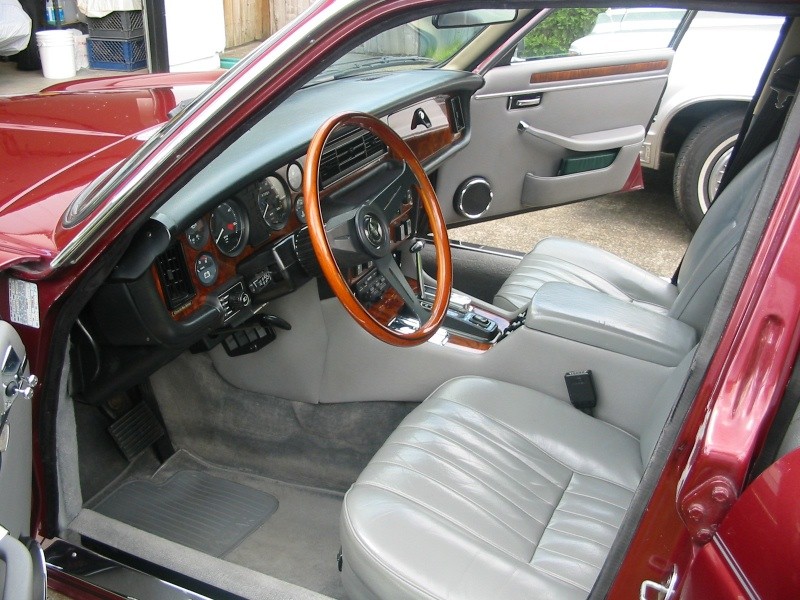

For wood wheels my favorite remains the classic Nardi wheel as seen in the pic of my 1987 Series III. Nice ones come up on Ebay for $100-$200 BUT the tricky part is getting a Jaguar mounting hub....not always easy to find and might put you over budget.

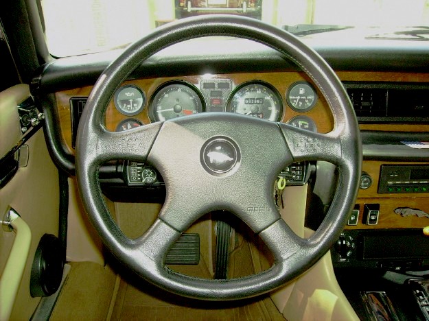

David Boger is right ..
Momo makes some really stylish wheels.
Here is a picture of my Momo Zebrano (no longer made)installed on my 86 Xj6 VDP.
Love the wheel but it did take some time and a bit of fabrication to get the wheel to be positioned a the the right place so I could reach the control stalks with my short fingers.
Whenever someone sits in the driver seat and grasps the wheel, they always seem to get this little grin.

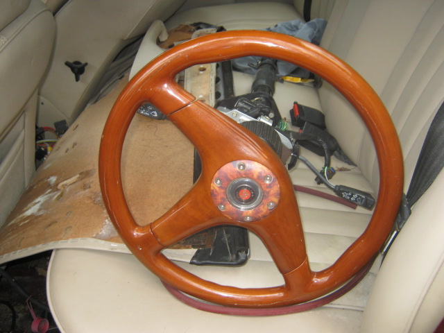

Default You will not like rivets in the wheel rim!
I had one like the one you were looking at.... sold it. Too hot to touch
when the car had been sitting in the sun.
Got a all wood three spoke one from Grant, you can choose your own center cap, love the smaller OD as the stock "school bus" sized wheels are too large.
