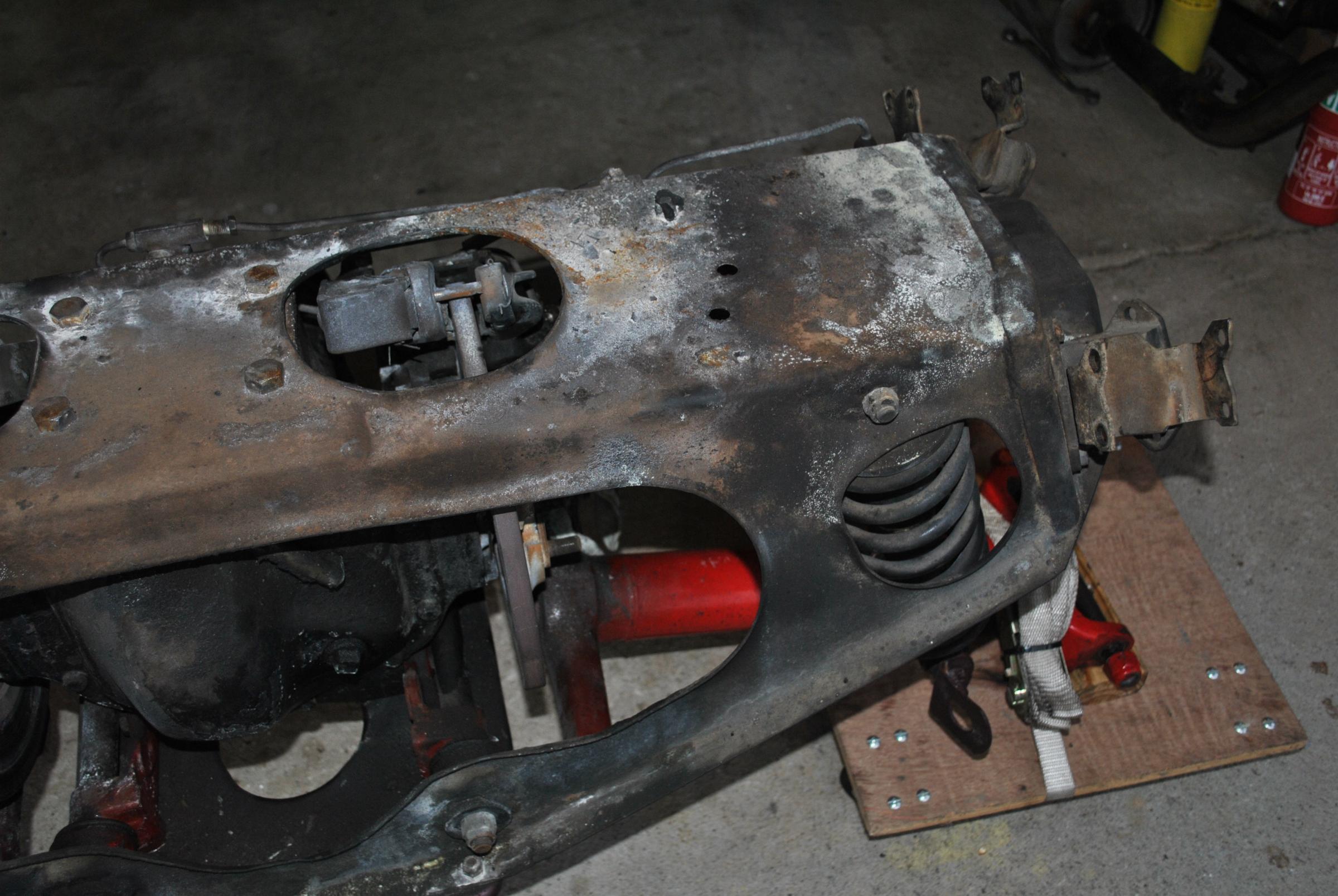

Default Here is the damage

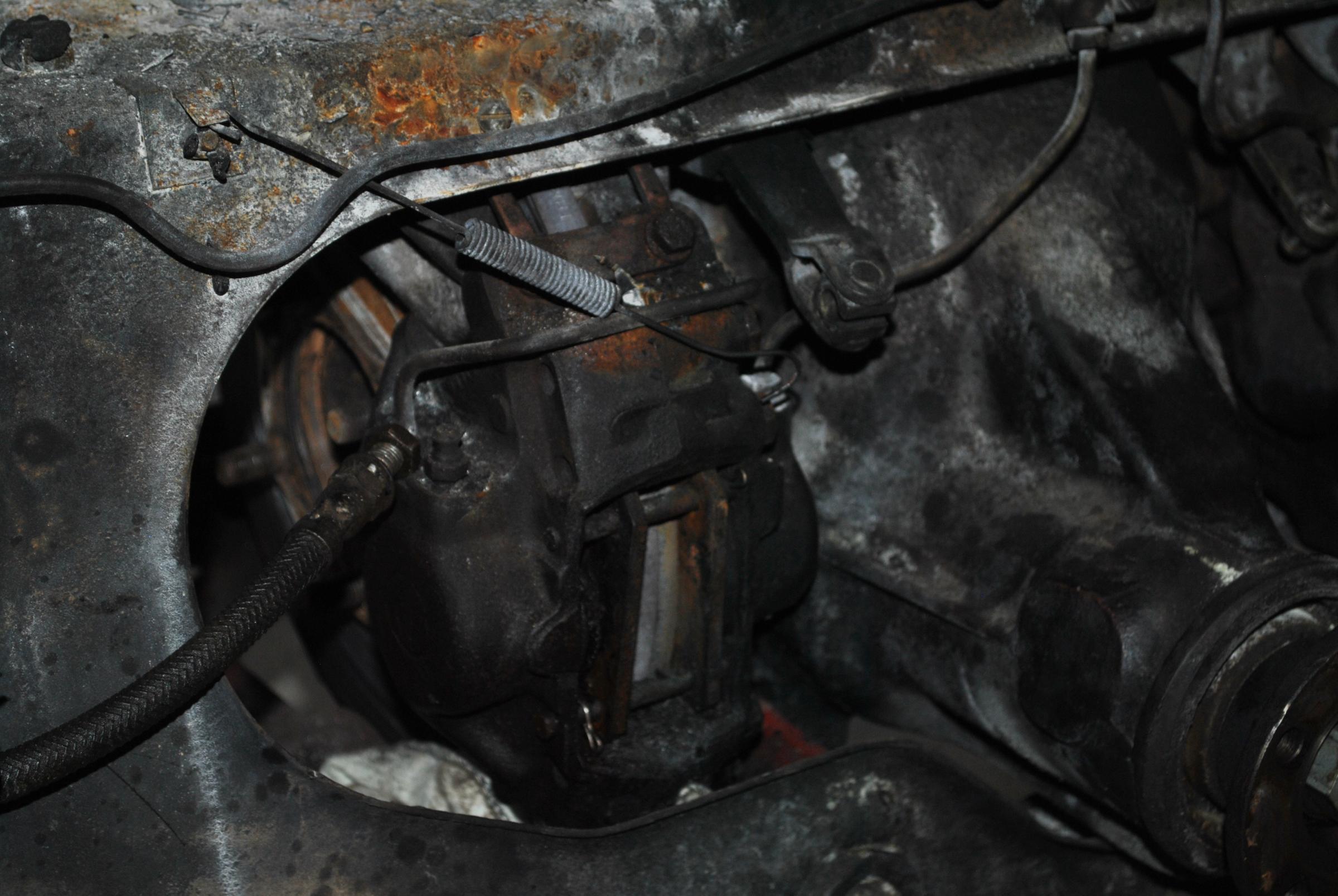

Got the cradle out today, not as big a job as it looked. May have been easier with a second set of hands.
It looked a bit daunting, but all went fairly smooth.
Attached Thumbnails Sunday drive ends with 000, I'm on fire.-dsc_8944.jpg   Sunday drive ends with 000, I'm on fire.-dsc_8948.jpg   Sunday drive ends with 000, I'm on fire.-dsc_8949.jpg   Sunday drive ends with 000, I'm on fire.-dsc_8943.jpg

That's had recent work to at least shocks / springs / metalastics by the look of it.
Much better than I was expecting.

Yep, much better than I expected too.
Previous owner said he did rotors, pads and bushes etc. He had the rear end out as I saw pic of it in his driveway with no cradle in there.
pulling stuff off it tomorrow, damage is limited to cradle,hand brake cable and a couple of brake hoses. No fire damage to under body, all fire was contained inside cradle.
The hardest part of the removal was separating tie sections of exhaust pipe.

Had John, a retired Jaguar mechanic and tech teacher come over today, arrived tools in hand ready for a full assault on the XJ6. I was expecting some advice on how to attack the rebuild. Instead I have stripped brakes and diff,know exactly what I need to replace and all in 2 1/2 hours. Would have taken me days, and i would have said the diff was ok. Output shaft brearings shot, felt notchey turning the pinion. A real gentleman.
Suspension is all good, so news not too bad.

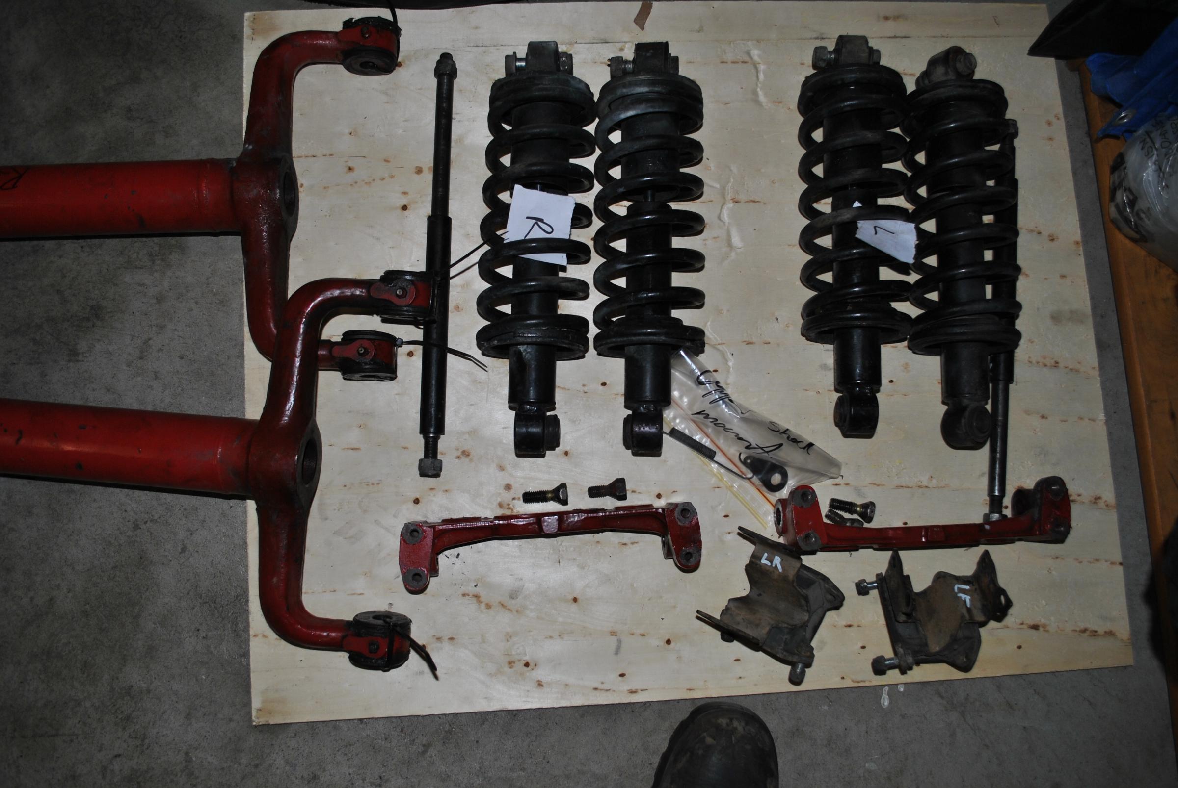

Default More pics
Time to find new parts and prices. The value of experienced help is pricless.
Attached Thumbnails Sunday drive ends with 000, I'm on fire.-dsc_8978.jpg   Sunday drive ends with 000, I'm on fire.-dsc_8987.jpg   Sunday drive ends with 000, I'm on fire.-dsc_8997.jpg   Sunday drive ends with 000, I'm on fire.-dsc_8988.jpg   Sunday drive ends with 000, I'm on fire.-dsc_8989.jpg

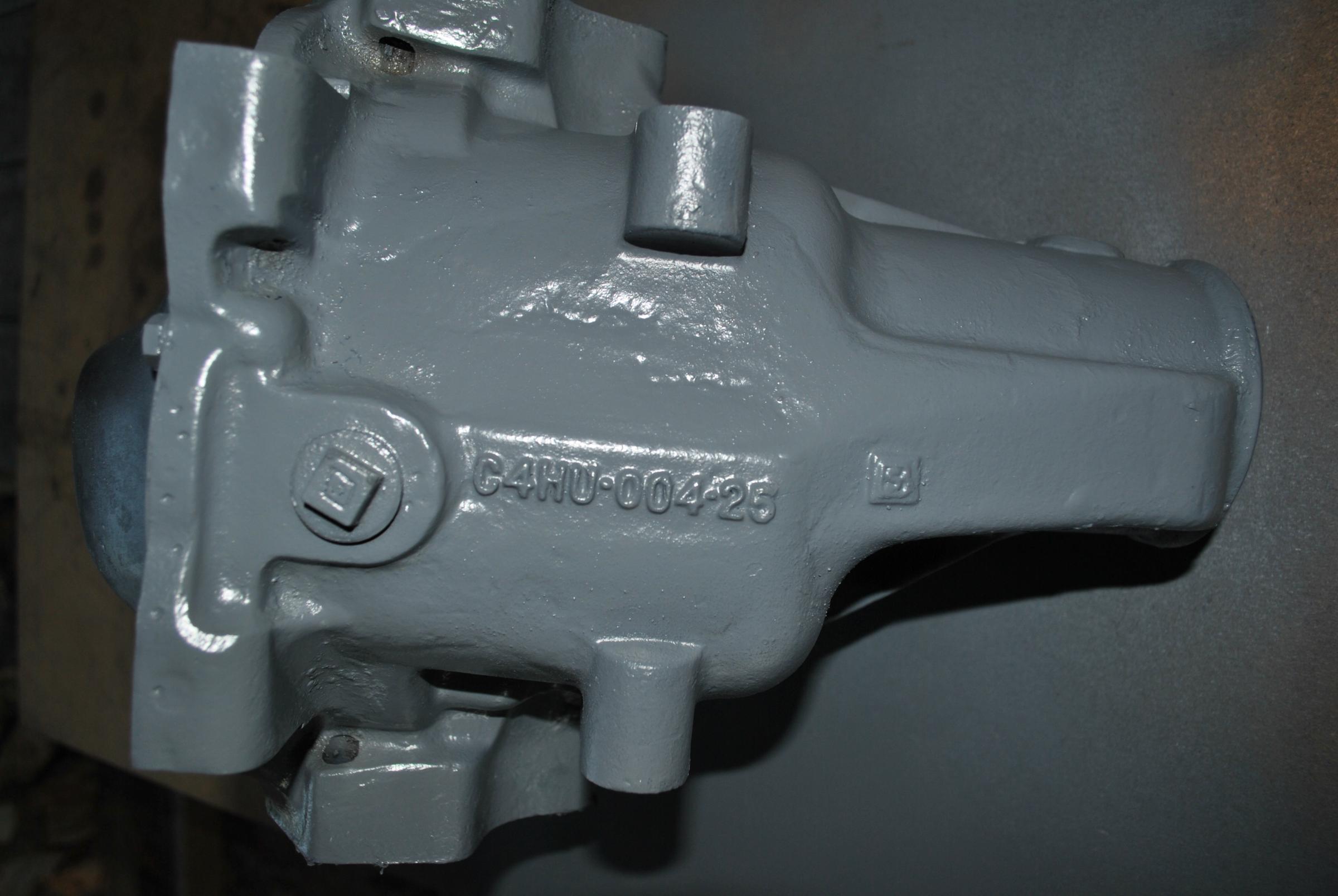

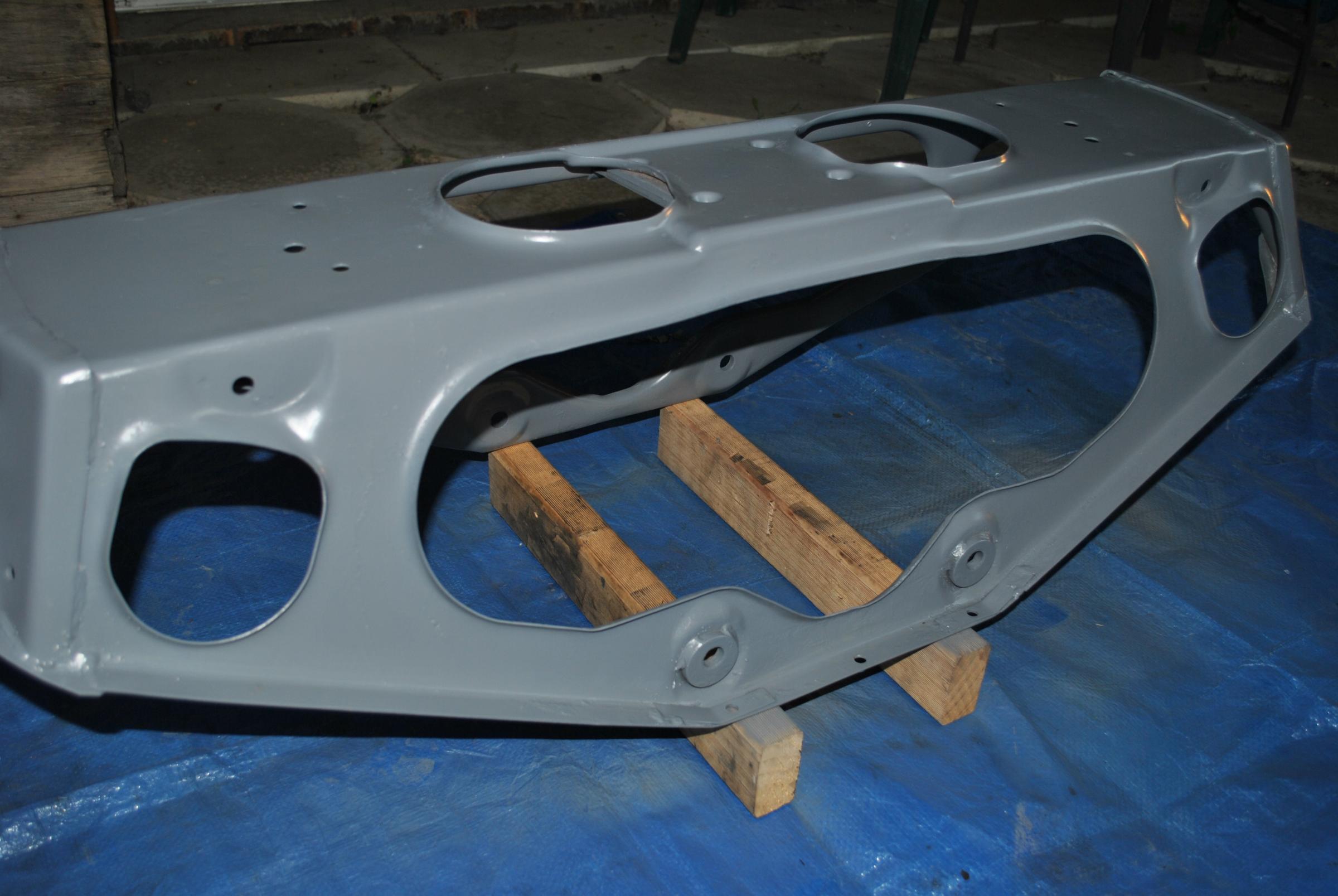

After playing around working out which parts I could leave on while touching up the paint on the cradle I found a couple of loose bolts and cross threaded nuts. So instead of leaving diff and shocks in and control arms in place I have stripped the lot to check every nut and bolt.
Start paint stripping tomorrow.
Attached Thumbnails Sunday drive ends with 000, I'm on fire.-dsc_9084.jpg   Sunday drive ends with 000, I'm on fire.-dsc_9080.jpg   Sunday drive ends with 000, I'm on fire.-dsc_9082.jpg

Default 12 hours of paint stripper
Feels like I'm finally making progress now some parts are heading in the finished direction.
Attached Thumbnails Sunday drive ends with 000, I'm on fire.-dsc_9093.jpg   Sunday drive ends with 000, I'm on fire.-dsc_9094.jpg   Sunday drive ends with 000, I'm on fire.-dsc_9085.jpg
