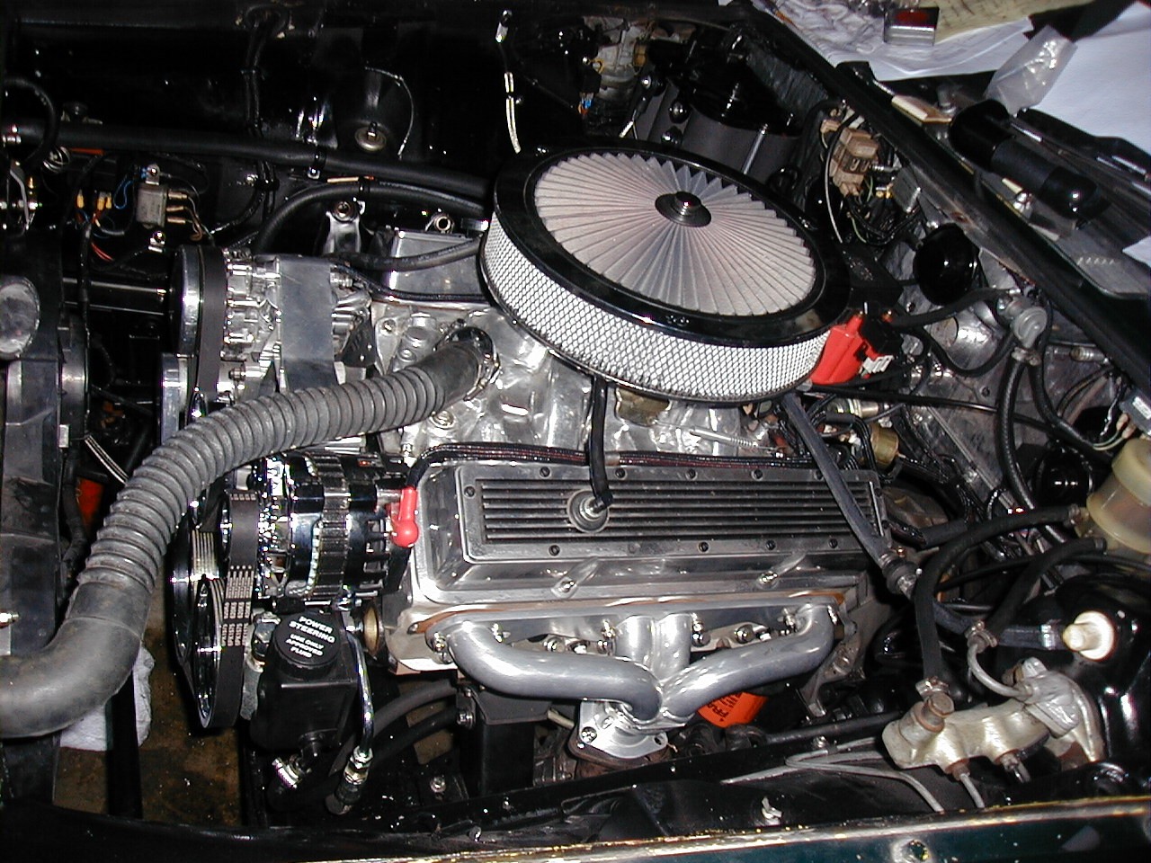

Does the pictured air filter clear the standard hood or are you modifying to suit?

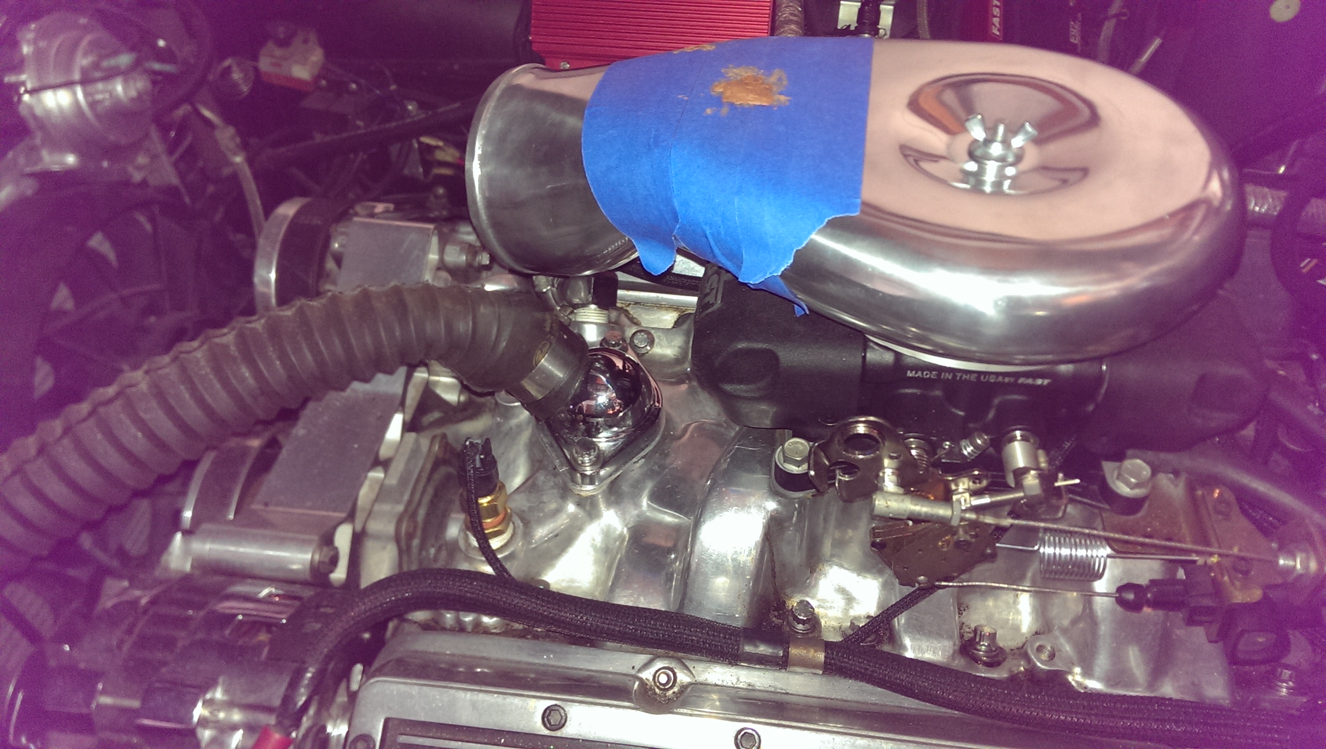

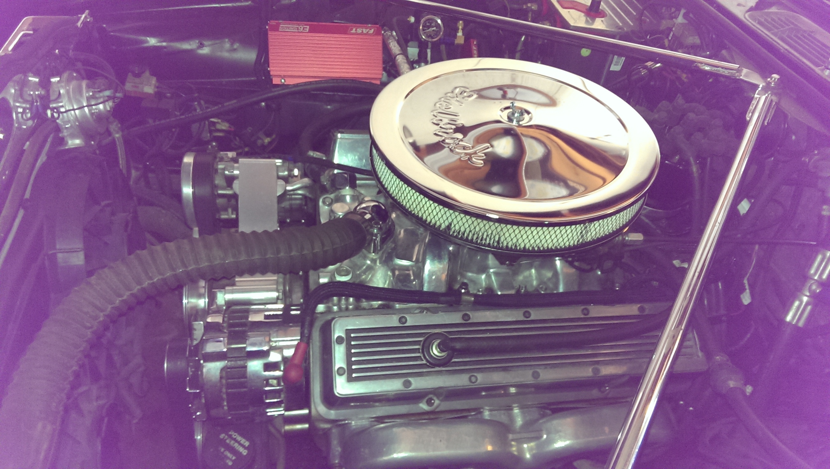

Default I had the same air cleaner on my car and it cleared the hood
But, with the new TBI the top air cleaner was hitting since I could no longer run a drop bottom piece for the air cleaner due to the fuel lines being so high now... without the drop bottom air cleaner piece cutting the hood would have been needed.
I have since changed my radiator support to allow for a custom made carbon fiber air box that is being made right now. The picture shows the plenum cap in place with a blob of rubbing compound on the blue tape to show the hood clearance.
In the interim I have a shorter air cleaner filter on the car...shown in the other photo.
Yes I did have to cut out the hood cross member to clear that cleaner.
