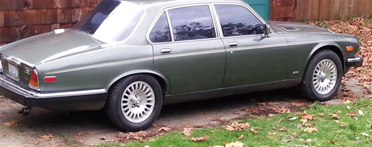

Old picture of the car before EFI and lowering, but it shows the wheel.

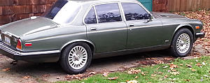

Weeelll.. I must have gotten lucky when I changed wheels / tires from 15 inch chromed Kents and 215 70 15 tires to a 16 inch wheel (20 spokes) 225 60 16 tires, as found on a 1996 XJ6.
Everything fit perfectly no spacers and the centers are just little caps with the Growler on them - the wheels have center sections that are a part of the wheel itself., just the little cap on the end (thanks David Boger) absolutely zero issues. Actually got lucky twice,..because now that I am into swapping to a ventilated rear outboard brake system - the larger outboard caliper might not have fit into the old 15 inch wheel. In fact the calipers on solid rear discs (as opposed to ventilated) are quite a bit smaller - perhaps to fit the smaller 15 inch wheels. The calipers on the vented rotors are "beefier" needing more room in the back of the wheel.

It is not the wheels that do not fit but the center cap that is just a little rounded outward in the middle. Your wheels are a different that gives room for the grease cap.

Very nice rims, Alyn, very nice indeed.
However, Roger's and mine are different in having hubcaps like the old days. These hubcaps make spacers necessary to use our rims.

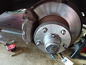

My hub centric spacers arrived today, from EZ Accessory, but my story is different from LnrB's. They fit the wheel center hub perfectly... could not ask for a better fit.
But they do not go onto the front hubs all way.. they hang up on the second set of ridges on the inside or about 10 mm from resting against the hub face. I measured the hub OD
at the most inner position, 96 cm, or approximately 2 7/8". Will have to enlarge them both by a bunch.. will take more measurements. I do have Dykem fluid left over from another non fitting part in the past.
After rethinking this whole thing, these adapters would only work as spacers that would fit tight onto the front hubs if the whole "hub centric" piece was removed. Will think
about it overnight and decide whether to cut off the hubs or just not use them at all.. I tried grinding the inside down to figure out that the needed goal size was not achievable.
I am just as unhappy (maybe MORE) than Elinor's Husband. Their ad does say they fit the rears??? But that is not my application. This was a waste of time and money...

PLan now is to enlarge the center of the spacers so they fit tight on the front hubs.. they will be better than the old ones that were very loose and took tape/adhesive to stay in
place. I have them now and do not need them on the rear, so will modify them to fit onto the front hubs...
I will cut a notch into them for the grease fitting the lubes the front hubs if that does not clear when finally fitted.

Finished up the two spacers, used a carbide tip and enlarged the center to equal the outside OD of the "hub" for the wheel fit... plus I had to enlarge the holes for the much longer lugs
used by my wheels...now these are "hub" centric but fit tight and are a little thicker than my old ones. Zerk fitting fits fine now... I replaced the now too short shock mounting bolts and there are threads sticking out of the nuts now.
Just waiting for the new Boge shocks to arrive later today.. will then finish up the drivers side with the new 1/2 bushings..

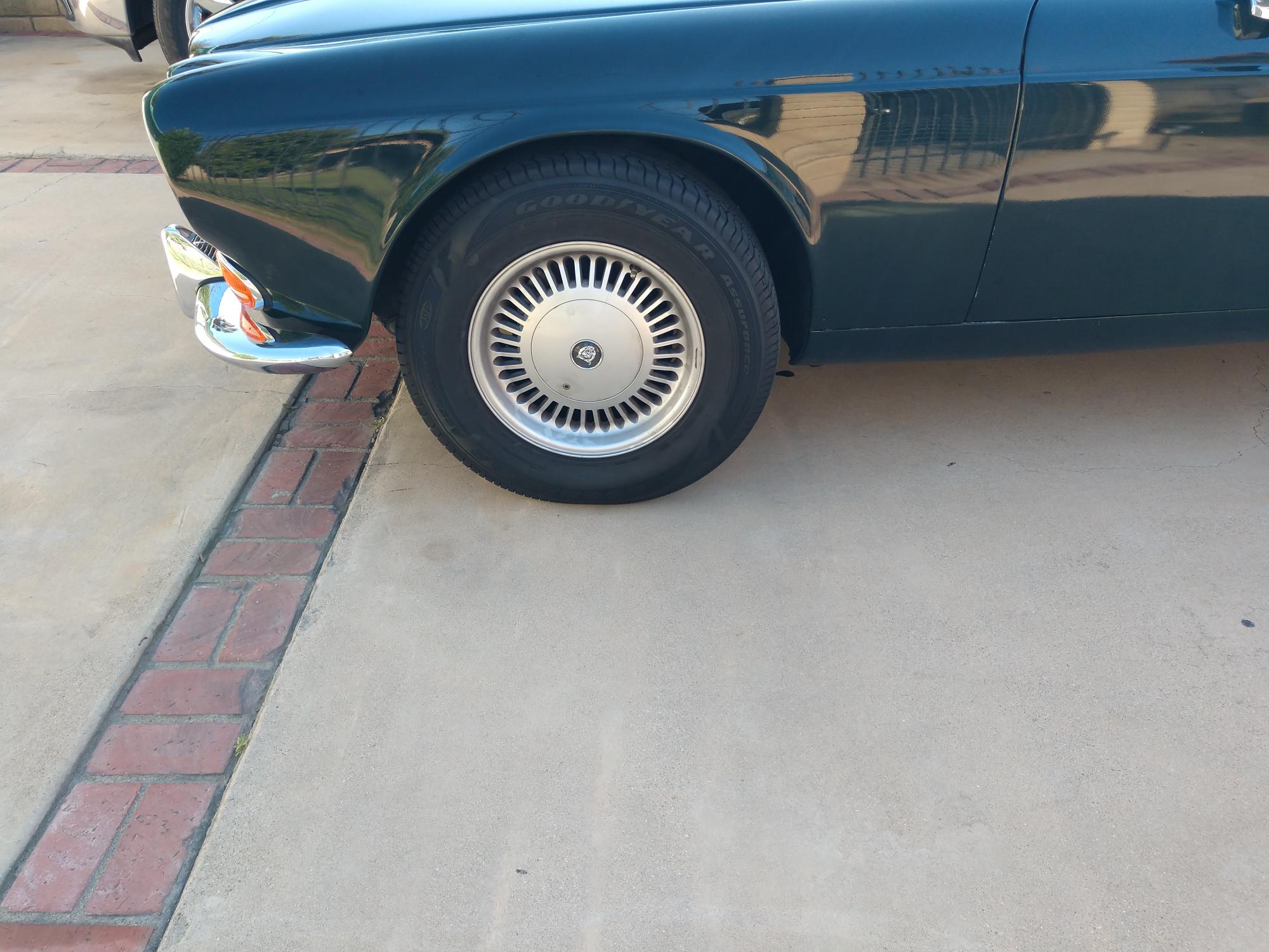

All done... 1/2 spacers in both sides with the proper length bolts. New front shocks (Boge) and they make a big difference in the ride.
I am happy with the new lowered stance...just have to re-adjust the headlights again.

New spacers fit very tight on the hubs and the longer lug nuts go through the holes. It drives much smoother now at higher speeds (no wheel shakes or vibrations).
The new shocks are MUCH better and the ride over bumps and RR tracks is very smooth and quiet. The best two mods I have done for the car.
