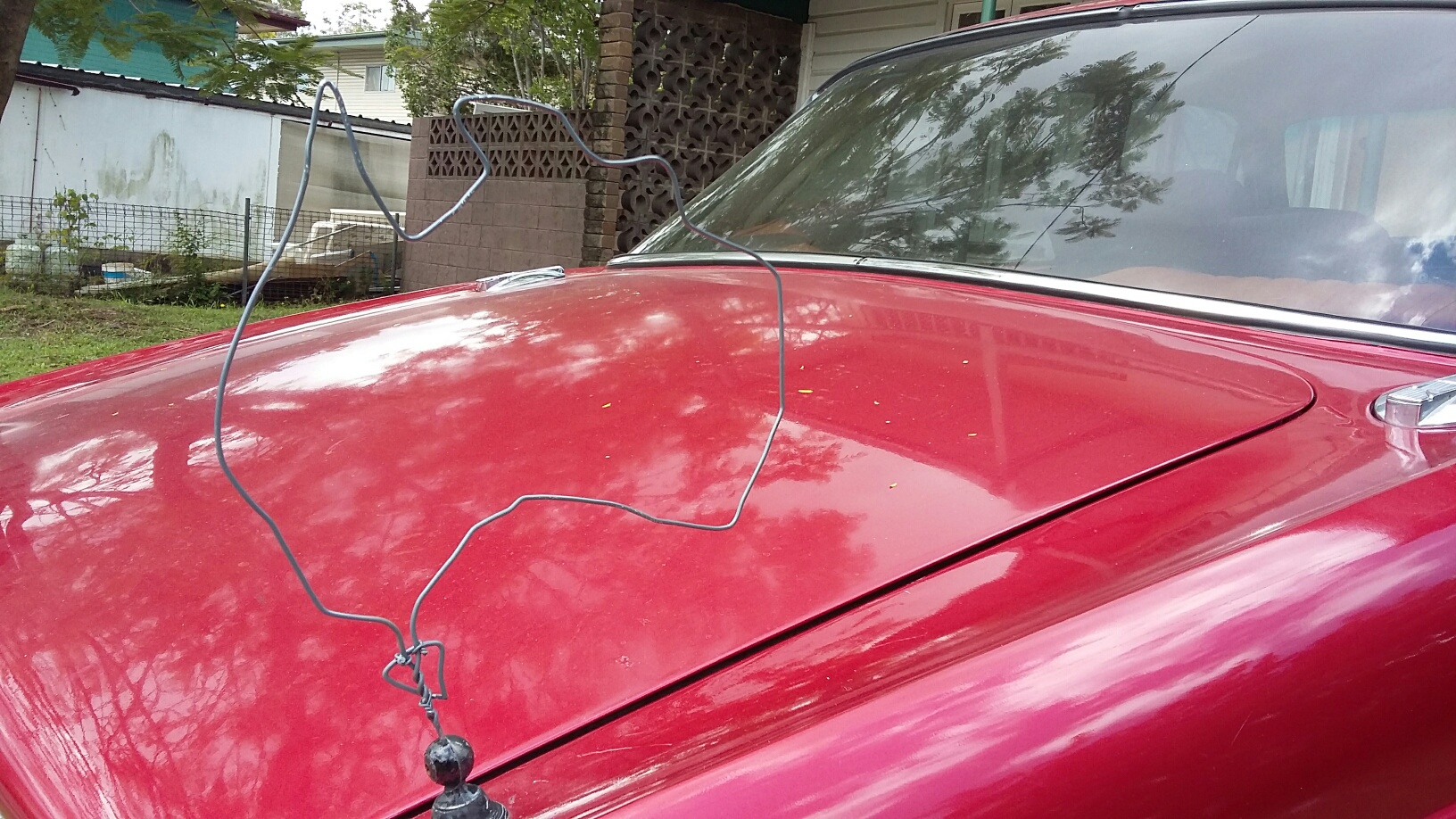

The last most important job was an aerial. Australia of course
(aerial photo)
(aerial photo)
