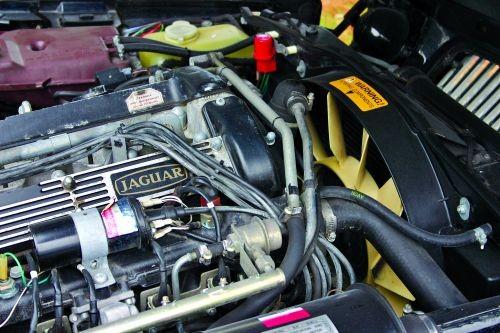

I know this is an old thread, but still an existing problem on my 1975 XJ6C. I live in Florida and also have running warm problems especially with the A/C running. I don't seem to have a radiator shroud mounted anywhere. Can someone please provide a pic? I've looked in the parts catalogue I have and can't seem to find one. BTW I also have this cardboard-ish part that I don't know where it goes. Could it be the shroud?
Thanks, Bill
