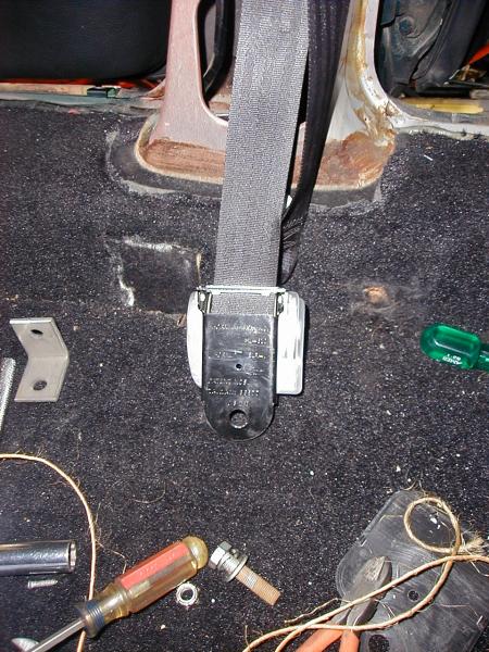

You can put your front belts into the pillar like the S3 and use the S3 rear seat belts with shoulder straps.
The rears are straight bolt in improvements. I have included photos on how to install the front belts and pickup a lot of rear foot room for the rear passengers.
I chose to install PT Cruiser front seats that really have high head rests, center arm rests, heated bottoms and power controls for the driver. Having
a lumbar adjustment is wonderful!
Also one showing the third brake light installed to modernize the car...
