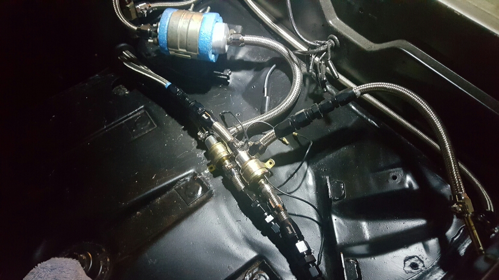

Work and life has been getting in the way, but we are making steady progress on the tanks and fuel lines.
Both tanks are changed out and new fuel senders fitted.
All fuel lines and switch over valves in the trunk have been done in stainless steel braided as planned.
We just have the runs front to back to do now and we should be back to operating mode this weekend.
Attached Thumbnails Yet another XJ12C restoration thread-upload_-1-20-.jpg   Yet another XJ12C restoration thread-upload_-1-19-.jpg   Yet another XJ12C restoration thread-upload_-1-18-.jpg

Fuel system rebuild complete.
Stainless steel braided hose throughout. Single piece from the engine to the valves in the trunk.
Both fuel senders working. Switch over working. New fuel pump is much quieter than the old one, probably because the old one suffered from rust ingestion.
Car fired up and ran perfect. Not bad as its not been started for a month.

Sarc,
Were the fuel returns and the extra return valve always in the trunk on your car? My S3 only has the changeover valve in the trunk, the return valves are under the rear wheel wells. Also, I do like the sound of straight pipes on my 6, two of them under the hood should sound great. Took the muffs off shortly after I got it. Hell I couldn't hear it running! May offend purists though.

Yes, this car always had 2x 3 way valves in the trunk. The return valve is 3/8" and is unobtainium, so I bought 2 1/2" feed valves and stepped the return hoses up to fit the valve. From some discussions on this forum, the conclusion was it is either an early S2 FI feature or a coupe feature. I had an S3 and as you said, it has 2x 2 way return valves (and 1x 3 way feed valve). Unfortunately, on the first road test with 2 full tanks of gas, we found the right hand tank overflowing. We have identified the cause as a stuck feed valve. It's stuck in kind of the open position, meaning fuel can go from left tank to right tank. I have some more valves on the way so hopefully that cures the issue.
The rear muffler delete definitely adds sound, but only outside of the car, not inside. "Purists", well they probably don't agree with my stainless steel fuel hoses, or my blue vacuum lines, but there you go !

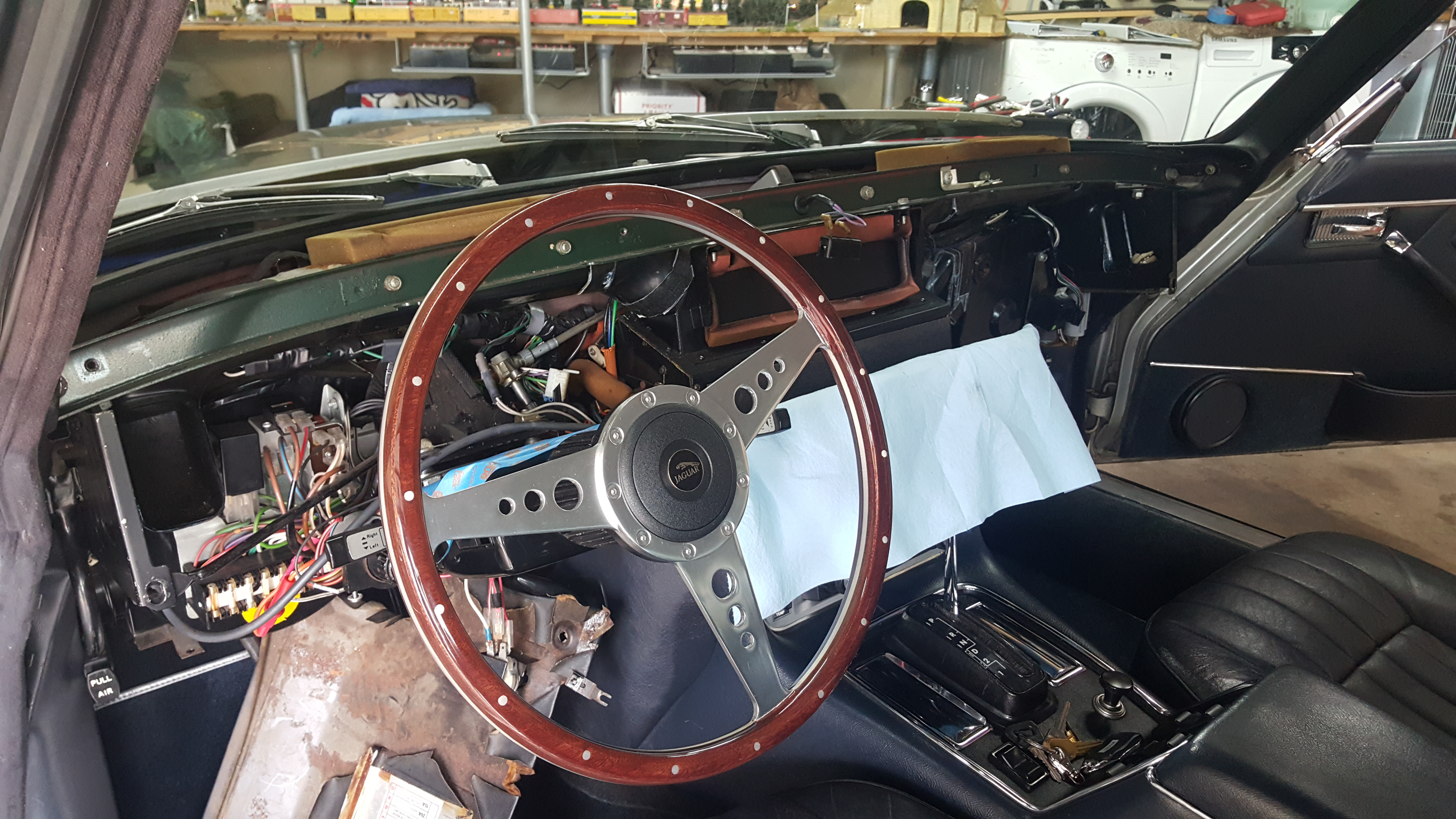

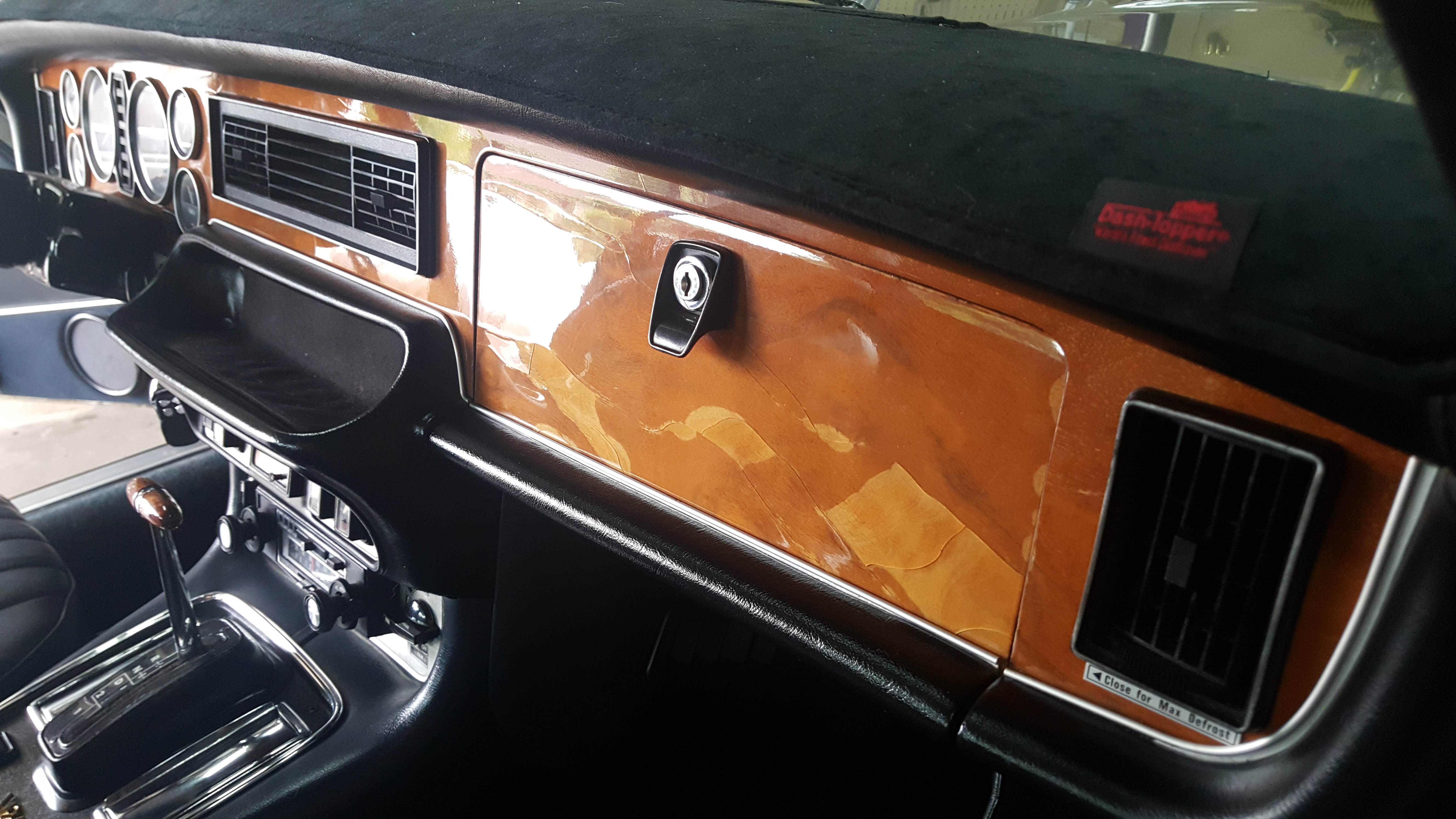

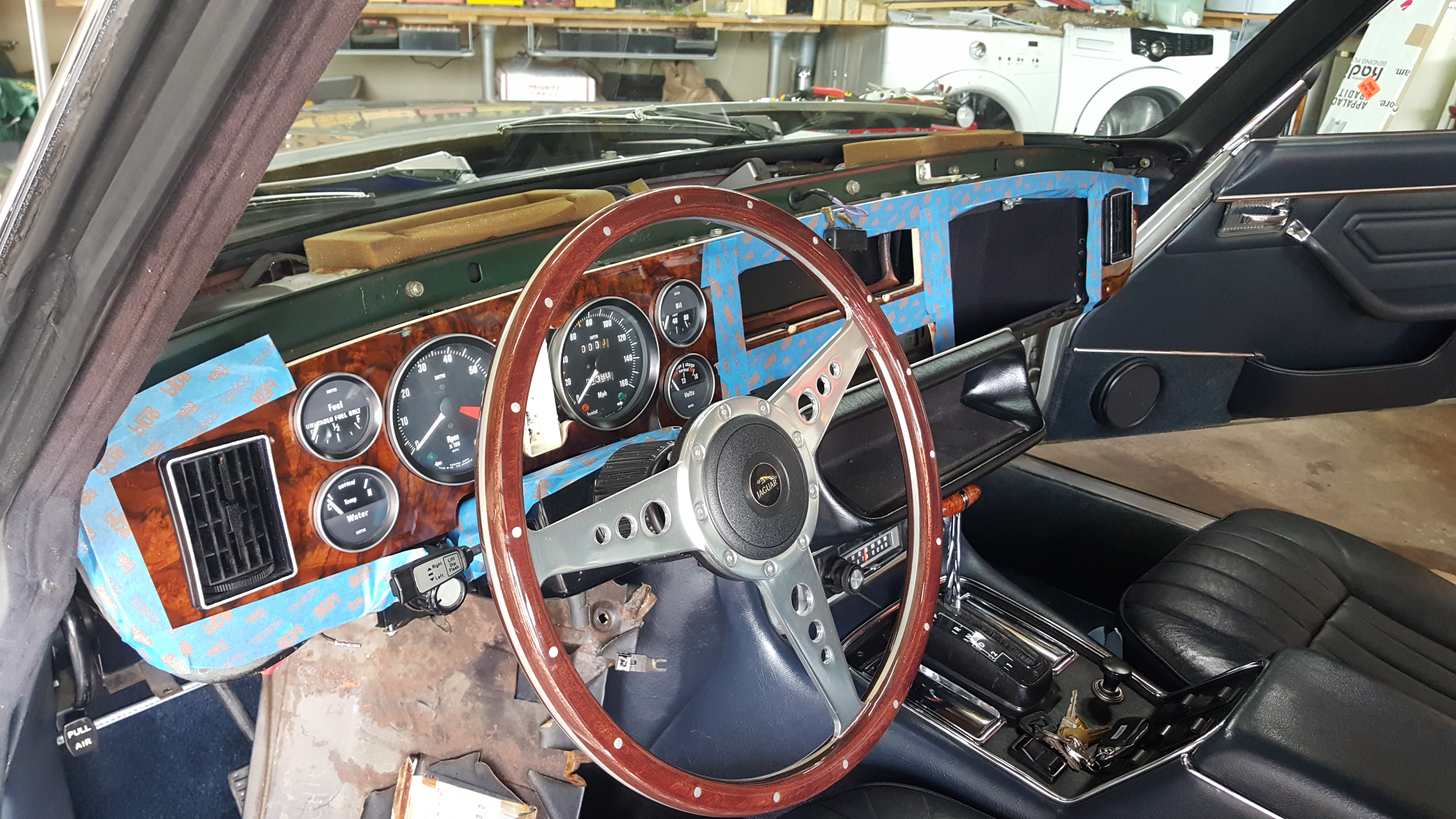

This weekend was all about wood....
The new dash panel was about the first thing I bought after I bought the car. It's been sitting in its box in the garage quietly until we got to the stage where the car is running well enough that I can work on cosmetics.
The new panel came from here Jaguar XJ 6 XJ 6C Series 2 Walnut Burl Dashboard L H D Wood Dash S2 6 177 | eBay
Very nice quality. Well cut. Fitted perfectly. The only thing you need to do is to make new screw holes for the small screws that hold the wood to the metal frame, and also make some new holes in the back of the glovebox door.
I used this video as a step by step guide. It's for a series 3, but was accurate enough for a series 2. One delta that I remember was the fact my speedo is mechanical, vs an electronic version in the series 3. Another was the fact that the temp sensor is in the crash roll on the series 3, and below the pencil tray on the series 2.
I hand painted the silver surrounds on the A/C vents as they were rubbed off and faded.
As suspected, the new, darker wood blends better with the aftermarket wheel I added previously.
I added new floor mats, dark blue with silver piping also. The interior is basically "done" The only things still to do are to fix a small split in a seem on the drivers seat, and replace the carpets at some point, but for now, covered with the mats, its still presentable.
It took me about 10 hours all told, but I think I could do it again in less, now that I have some practice. Hopefully I don't need to re-do it ever for this XJ12C.
The only issue I've had is the speedo drive unit that sits on the right hand side of the transmission tunnel is clicking. I think it's maybe because it's not lined up properly. Hopefully thats an easy fix. All of the gauges (miraculously) still work.
Some pictures "before", "during" and "after" attached for fun

Oh Yes, that is Very very nice! Wonderful slab of burl you found! Simply Wonderful! A Quantum improvement over that sort of brown plywood that preceded it.
XjC deserves nothing less!

Beautiful job! The silver trim on SII gauges and vents really completes the look. That ebay vendor does great work.
I have a mechanical speedo on my car and used some white lithium grease on the inner cable to cure a clicking noise that seemed to be coming from the cable and the drive unit.
Sarc (05-24-2016)

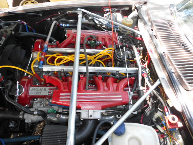

let me ad my 2cents
Attached Thumbnails Yet another XJ12C restoration thread-jag-interior-001.jpg
