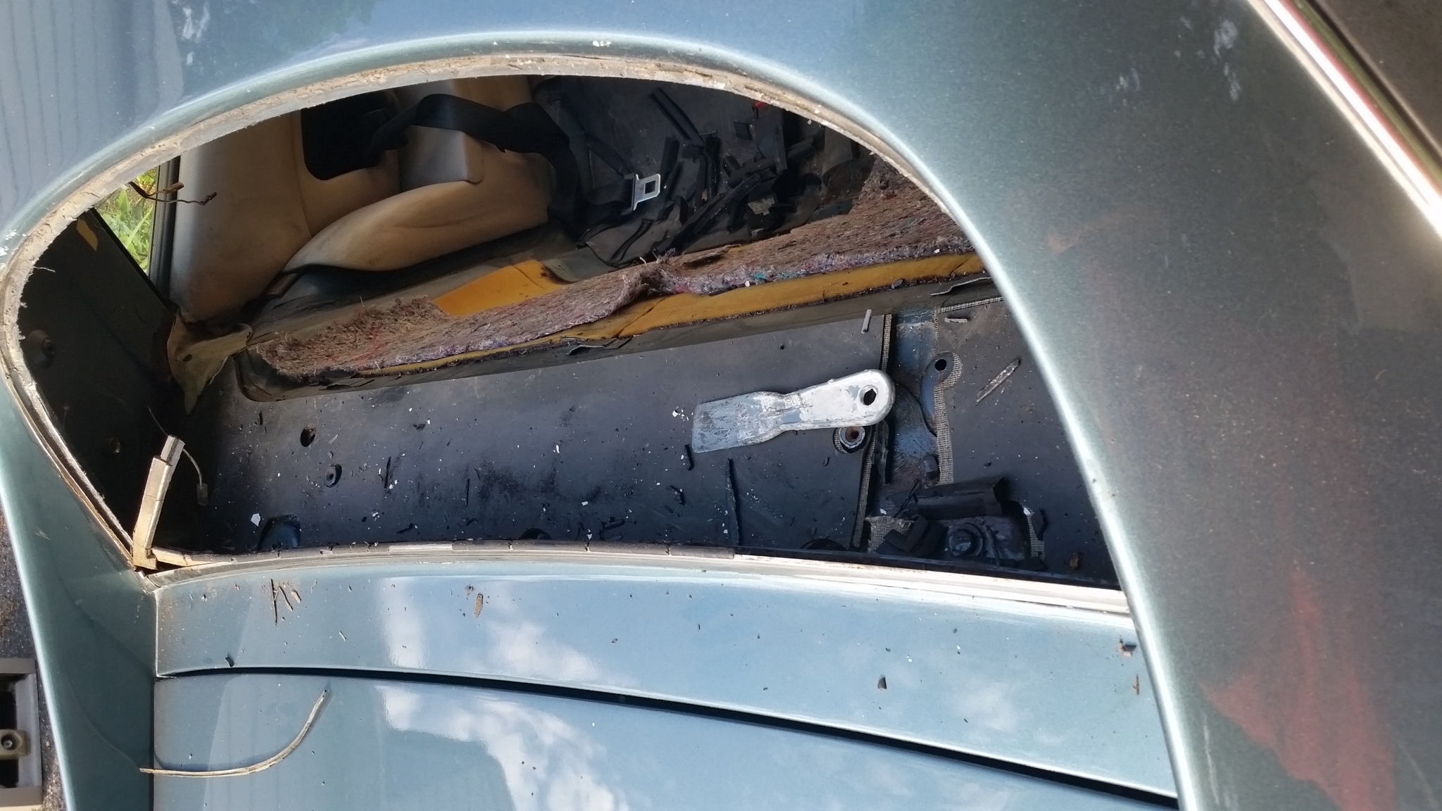

... removed rear window(old rubber just fell in pieces), cleaned all, installed gasket on window... installing trim turned out to be a pain.... bottom piece went in ok but top piece does not want to go in on one side. I am not sure who to blame... my thumbs are numb for 2 days now after pushing trim in. As far as I can see trim is grabbing to the edge of the rubber as it is supposed to but other side does not want to stay in the small grove/cut. Looks like it is not a 'precision fit'.... I am looking how trim sits in my xj8 - so much better, but I think it is designed better.
getting ready to install it back...

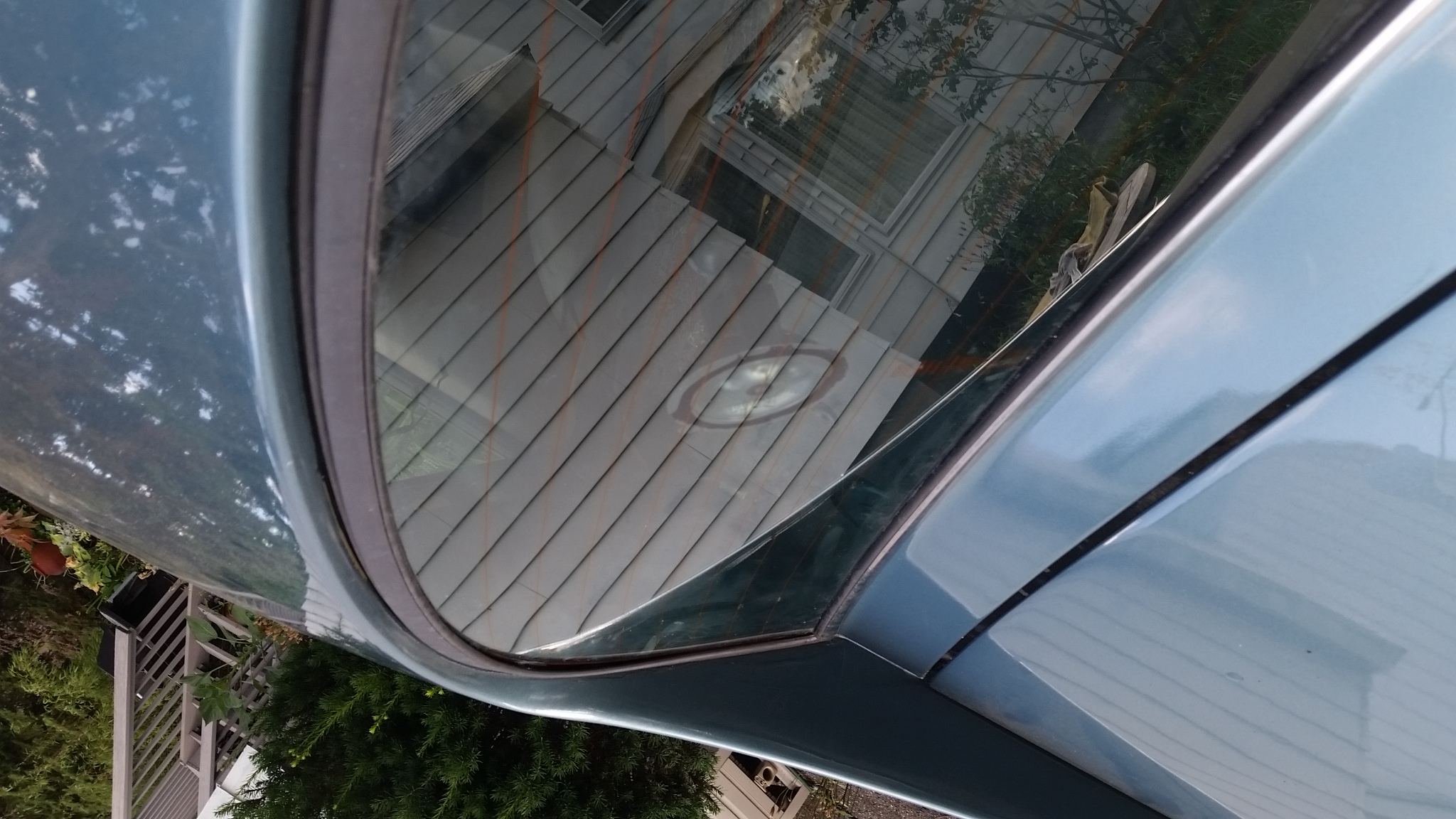

Well... it does not look like I will be able to "do it once".
Installed window fairly easy: put sealant into the grove all around, then inserted cord(rope) all around with free ends in the middle of the bottom part(now I think having them in the corner would be better), inserted window into the opening with one corner going into place, pulled the rope and window was in!
The bad part is that on the sides rubber is not sticking to the glass, there is a gap which is bigger on left side(pic attached). Because of this gap chrome trim got out of place and I couldn't push it back. The gap is too big to fill it with sealant. On the inside everything looks good, no gaps or twists....
Anybody had results like this? I am not sure if it is my fault or the seal/rubber is bad quality (that URO part).

Are you certain it is fully engaged along the top? There is an extra lip on the seal which is meant to hold the headlining and it may be possible this is what has been engaged. I only say this due to you apparently needing little effort to get it in and your pic shows seal too far from body at top. Body enhancement book states to start by fully engaging bottom of window first before moving to sides and top with the cord.

Yes, the top is fully engaged and seal seem to sit correctly inside. The body is in the second grove and extra lip is available. When I installed bottom was fully engaged first, and I pushed window down as I got bottom corners in.
It did take some effort to pull the cord and to make sure everything goes in, but it wasn't difficult.
I am going to shop around for another seal, I think the one I got wasn't good. It was all twisted when I got it and didn't sit tight on the glass from the beginning. I was hoping that once in the body it will all get tighter, and it got on the top and bottom, but not on sides.

The after market rubber seals are bigger than the originals, and they do not fit well. I had two sets of aftermarket seals installed, and between the shoddy workmanship and ill fitting seals, I managed to hunt down some original Jaguar seals and now I am afraid to have anyone touch them or the window and wreck the seals! Besides not many glass shops have people who know how to work on old cars, which is one reason the botched the job twice...which got their sorry asses sued to the tune of $3000. I am looking into replacing the window myself, after all, I can't a much poorer job than the "professionals".
