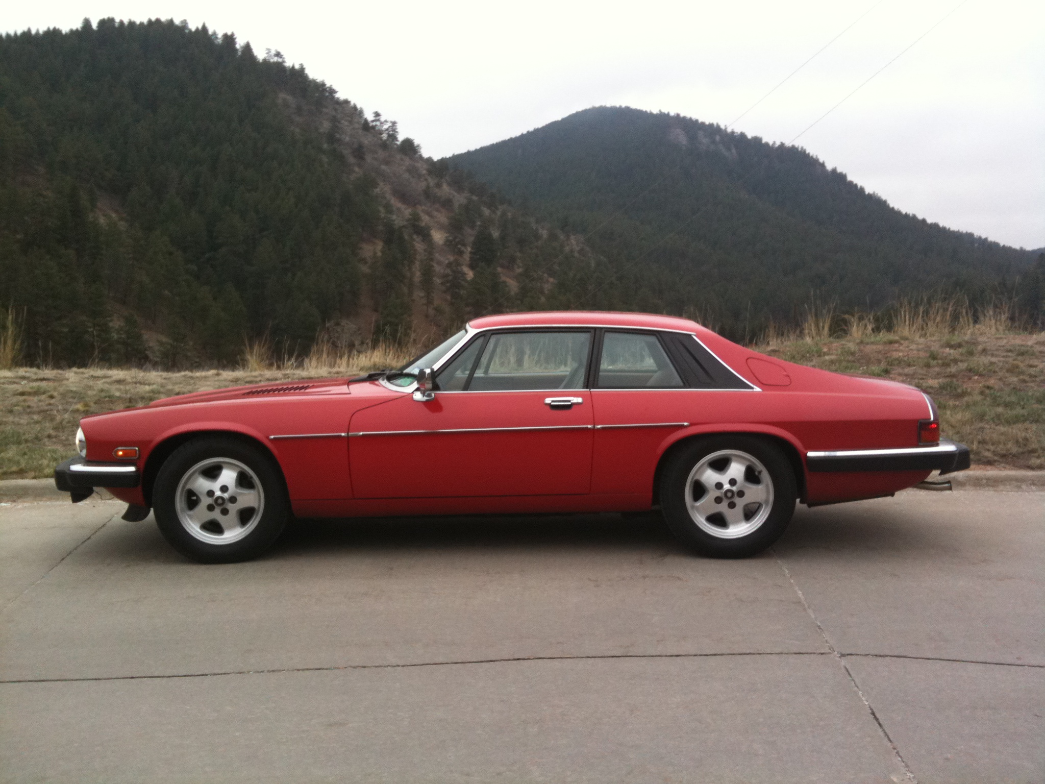

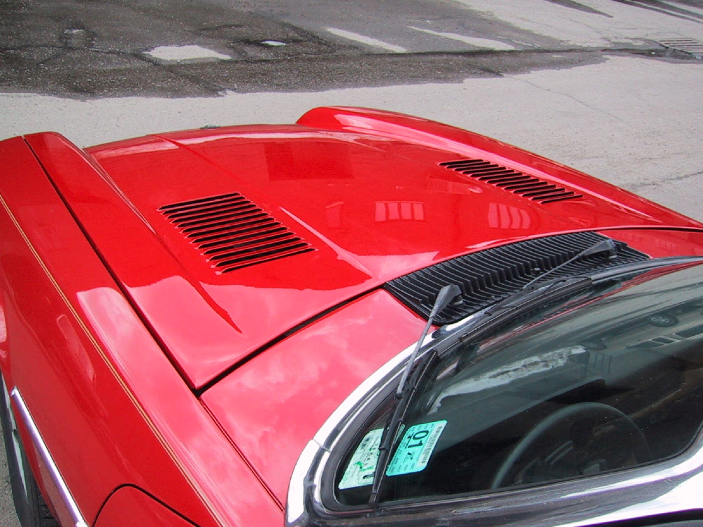

agree with Jagz, it looks GRRREAT!
love it when plan comes together.
yaknow, your car is a close resmblence to my friends car color and all.
and he has a 6.0L with 4L80E, altho he uses the Electromotive ECM, thats the 6 coils i showed on another post!
he let me drive it for 20-30 minutes, when he stopped by , on his way from south FL to Vail Colorado, in the snow-ice winter mountains.
