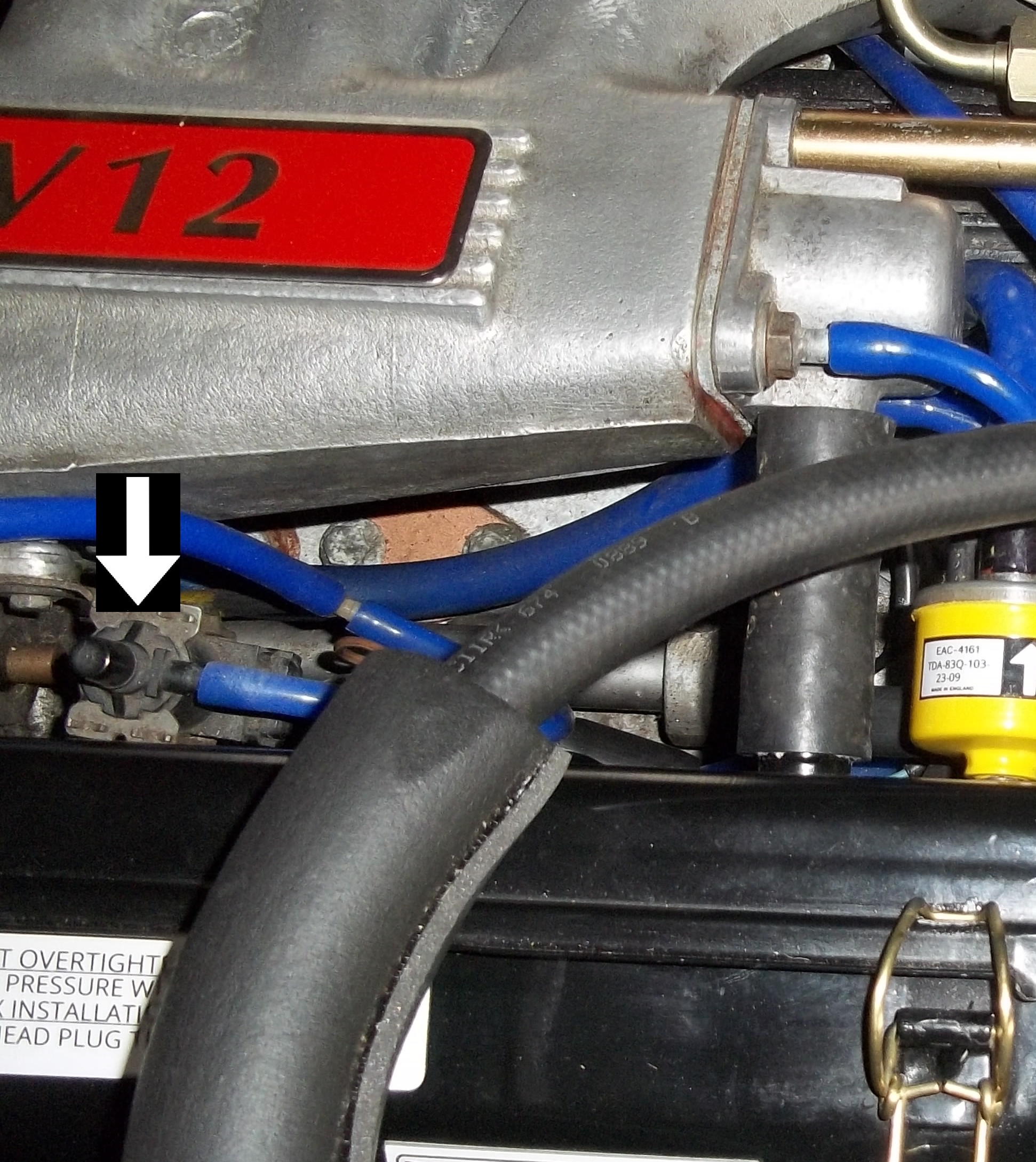

so what is this arrowed item please

its a soli valve, what its for no idea

Is that connected to the air pump?

no, I don't have an air pump as its an 84 uk car. 2 wires and 2 vac pipes though part no
is eac3488

Seems like something that wasn't carried over to an 89.
