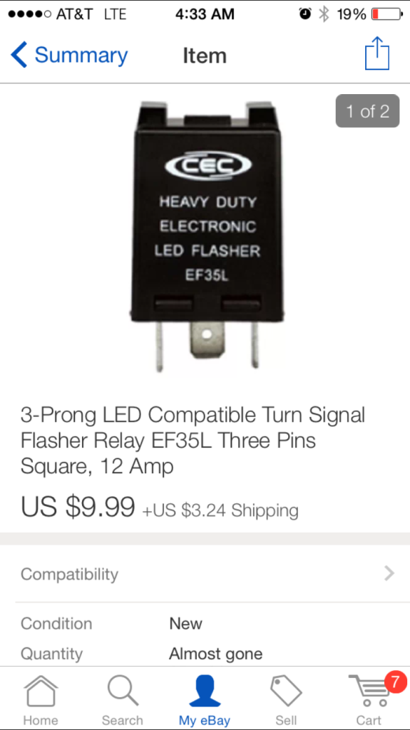

The flashers did hyper flash but I did not install any resistors in the wiringto cure it, instead replacing the OEM flasher with this; so no need to splice in resistors just drop in this Led flasher to cure hyper flashing

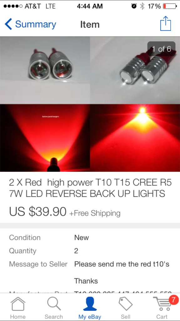

And for the high mounted stop lamp, I used this
