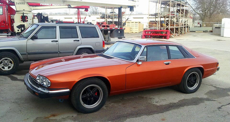

Default DB7 wheels on XJ-S
AFAIK these wheels started life on a DB7 - they are 18 inch Speedline Mistrals & I think they are 8 inches wide. I've never been able to confirm the exact offset of the wheels & I first tried 245/40/18s on them & there was a lot of fouling on the rear wheelarch inner edges, so I tried 235/40/18s & they still fouled the rear arch inner edges - they are now fine with 225/40/18s.
Andy.

  #46
Old 01-05-2013, 01:42 PM
Join Date: Dec 2012
Location: Northern Ohio
Posts: 68
Received 5 Likes on 5 Posts
those wheels look great on your car, If I can't find what I had in mind for mine, I might be tempted to go with those...Very Nice

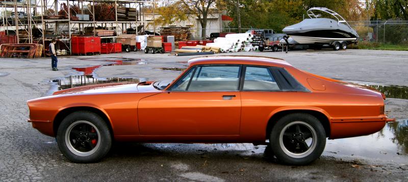

hey mish you asked for opinion, the car looks high in the front and low in the rear, whats with that??
That was years ago, before I rebuilt both axles and replaced all 4 corner shocks and springs. Look now...
